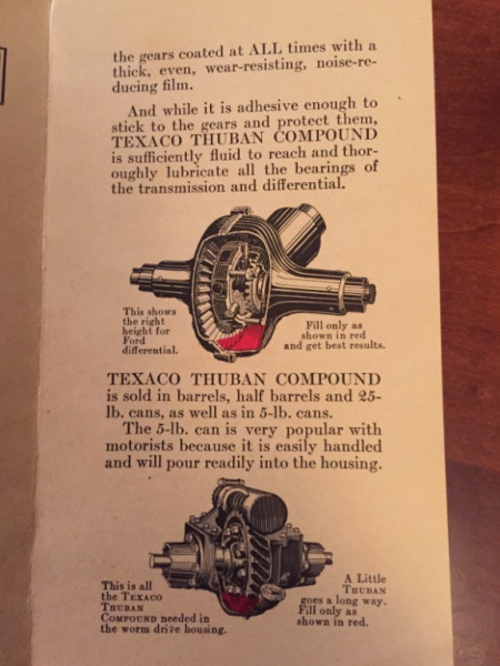

Post by Chris Instness » Sat Jul 02, 2022 12:10 am
This is from a 1920’s Texaco gear oil brochure. It shows just enough oil to cover the bottom of the ring gear.

Post by Original Smith » Mon Jul 04, 2022 5:12 pm
The old Texaco ad above says it all. Don't forget the pre 1918 filler plugs are higher than after 1918.
