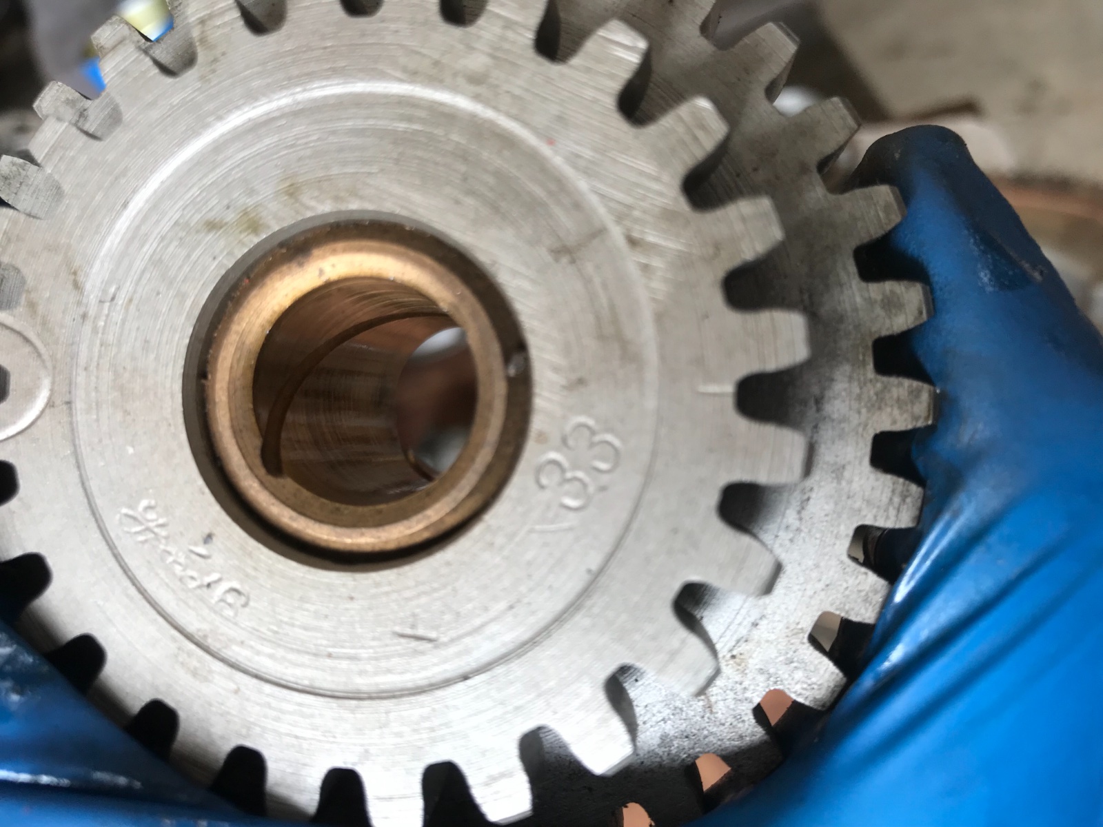

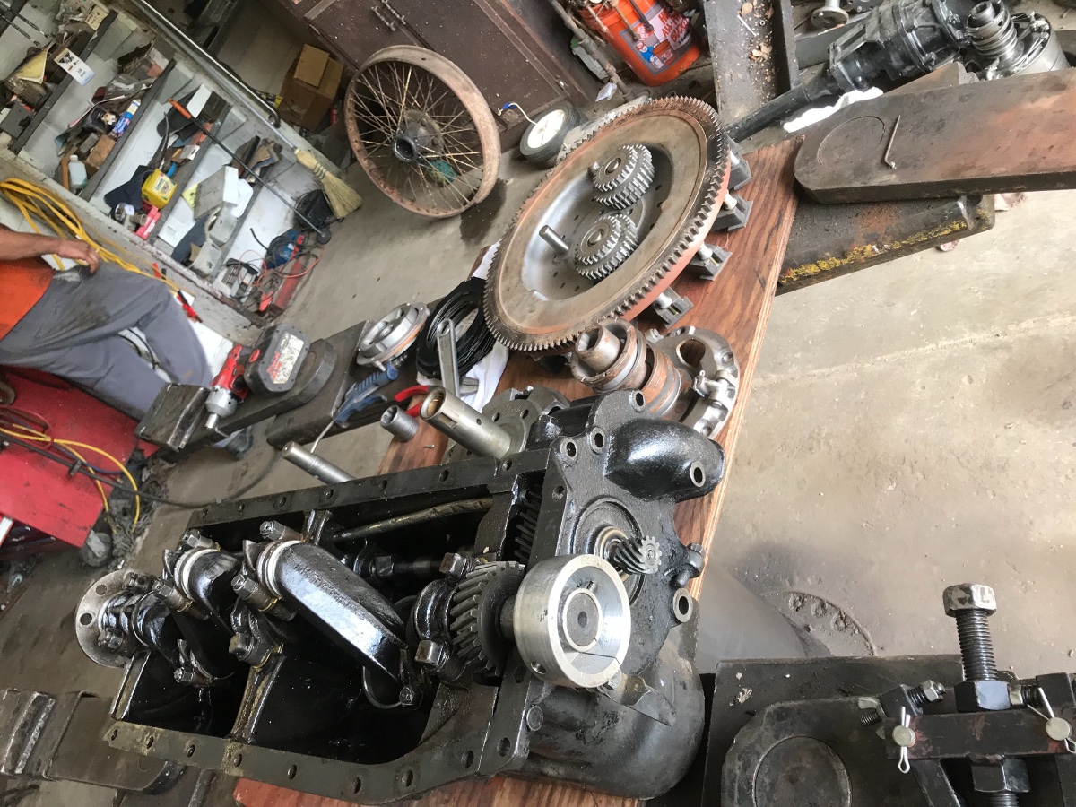

Well, Erik Barrett certainly saved the day. He’s got a completely rebuilt 27 trans we’re putting in the car right now. And he had a 280 cam just lying around that I’m putting to good use. And he’s touchingly up the valve seats.
The tranny is perfect. All new bushings, new clutch, new ring gear etc. And the drums have much more material than mine did. Talk about lucky - it’s my lucky day. I should be able to get it all back in the car next week.

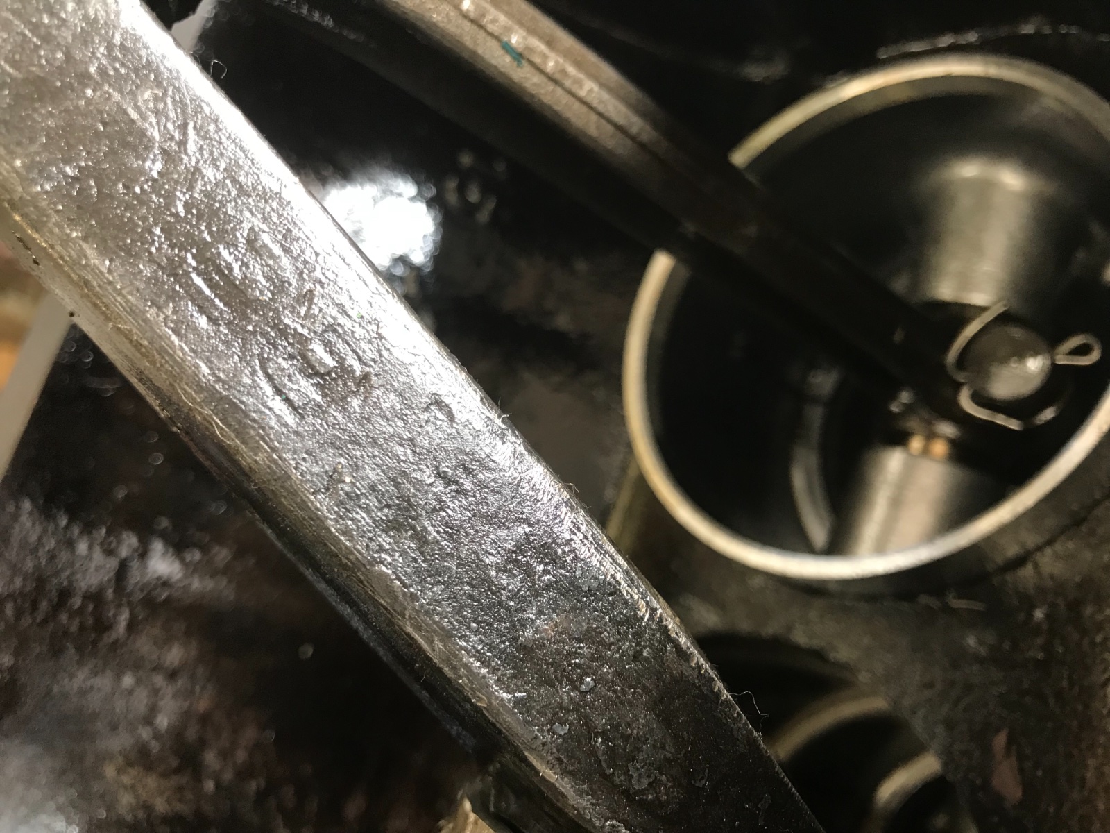

And I got a nice little surprise-Erik’s eagle eye spotted something on my crankshaft. See if you can see it.

Appears someone stamped a couple E's on there...Maybe Elvis :? :lol:

The cotter pin in the wrist pin bolt, isn't doing you much good.
Herm.
Kerry
Posts: 1461
Last Name: van Ekeren
Re: New transmission - I’m saved by Erik Barrett
Post by Kerry » Sun Apr 14, 2019 7:06 pm
And while fixing what Herm has picked up on, I'd be drilling oil holes in the pistons for the wrist pins as well.

-Tear down of a “rebuilt” ‘27 transmission
-Adjust/reem all transmission bushings and bearings for proper clearance

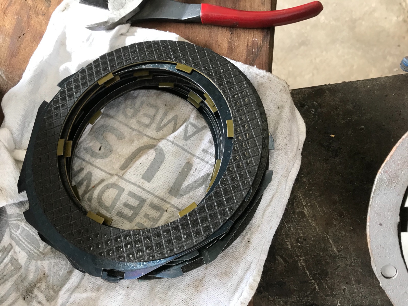

-Replace low pedal shaft and refurbished/welded the pedal cam gears which were totally worn out and likely contributed to the low drum failure
-New clutch spring
-Re-banded low and reverse with Kevlar linings (destroyed by the “incident “) - thanks Harold!!
-Reassembly and adjustment of transmission
-reshim & adjustment all rod bearings
-clean everything and reassemble.
