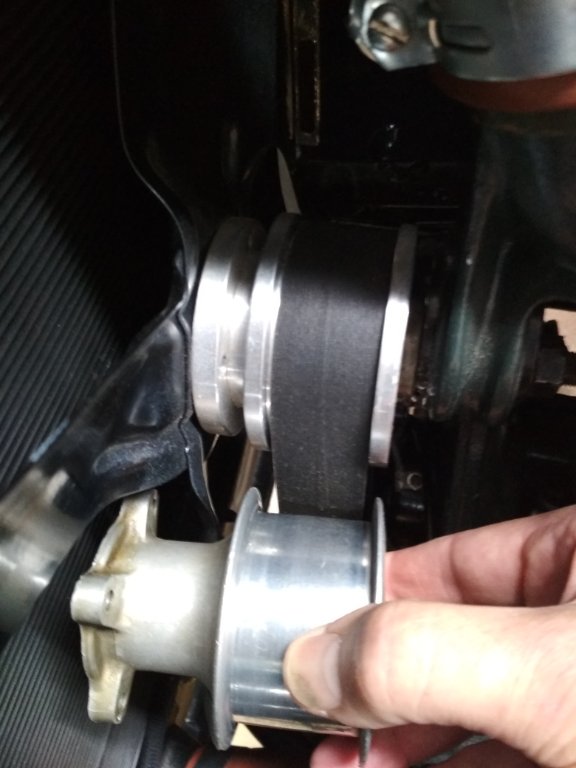

Scott, the pulley for the 3 row radiator on my 27 is one inch longer than the new pulley I bought after installing a 5 row radiator.
The overall pulley length is 3.2". Here it is being held up to the new one. I drove a lot of years with the 3 row and was accustomed to hearing the water/coolant circulating quite noisily after engine shut down. It must have been boiling because you could see steam coming out of the overflow tube for a couple of minutes or so until everything cooled down.
My original 3 row round tube radiator has been replaced with a 5 row round tube Brassworks unit and now, after engine shut down, the car is thankfully silent and there is no sign of steam.
