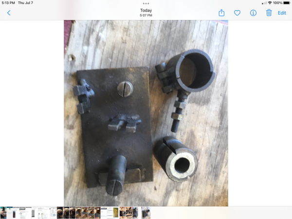

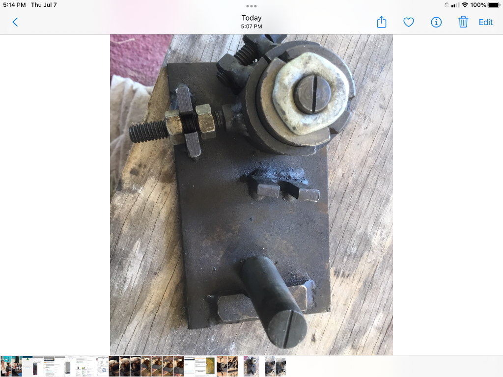

I put the bearing in a vice horizontal with the split up and down. Take the blade off a hacksaw or coping saw thread it through the bearing and reattach it to the saw. This is after the bearing is milled to size. Now cut down to the split, turn the bearing 180* and cut the other side. It should fall apart, if not remove the blade and with the bearing in the palm of your hand strike one side with a hammer. After it separated file or cut the babbitt to the V shape. If I can help, give me a call at 903-824-1949. Bob.

I believe we are talking about bearings that have been re-babbitted

Nice Babbitt fixtures.
The OP was about NOS , not rebabbitted bearings.
I agree with your need to V out the babbitt on a rebabbitted core.
I see the confusion.
Your iron cores must be matched/mated as from the factory & still retain their matched surfaces & have very little outside body wear??
If not, how do you have a successful iron mate as was originally done? Outside of making your own outside iron body, this is tough.
I have made my own cast iron bodies, but do not Babbitt the inside. The cam will run on the cast iron like the early T motors did.
