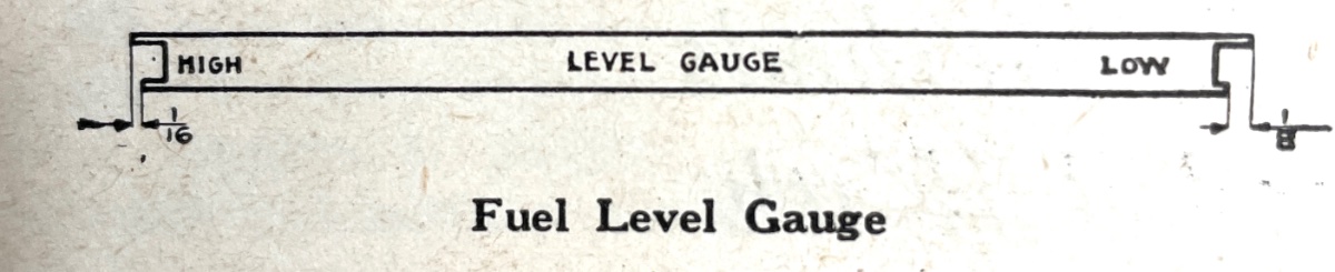

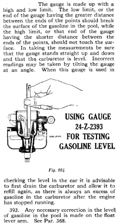

I assume it's easier to make a 24-Z-2393 than to find one. Anybody have the measurements?
How about the 24-Z-2390 for checking the tube? I'm not really clear on how that's supposed to work.

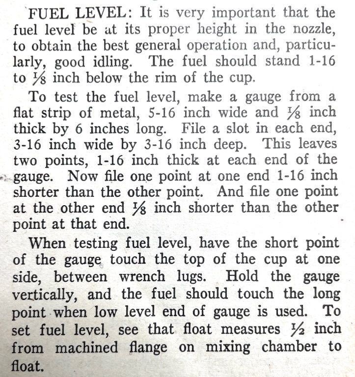

Here are details. Complete overhaul instructions of the G and NH with illustrations are from June 1924 Ford Owner and Dealer magazine. Shows a set of tools for both but not all have dimensions. Below excerpts are from page 71 and 72 in this magazine.

Stan Howe posted that modern floats should be cut down to the size of original cork ones. I found the new float easy to shape using fine sandpaper on a flat surface. My car runs good with the puddle about 3/32, made a tool like pictured.
