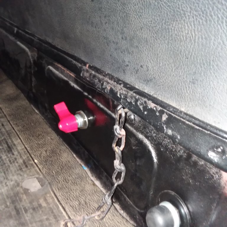

I used this $30 rig I got from Lang's. It's the red flipper on the left of the picture. It's a heavy duty switch, not like cheapo red plastic key stuff.
Wired to the (+) from the battery. When switch Is on, the main harness and the input side of a 6v solenoid are live. The solenoid has a button wired to it, see right side of picture. When button is pushed it allows current thru and out of the other side of the solenoid to the starter.

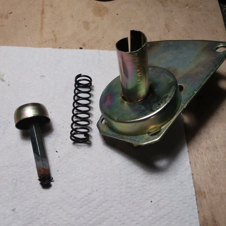

I did away with the floor mounted starter switch, as I had mine break and weld the starter on!
Had the shutoff not been so handy, I could have had a major setback in a quick minute.

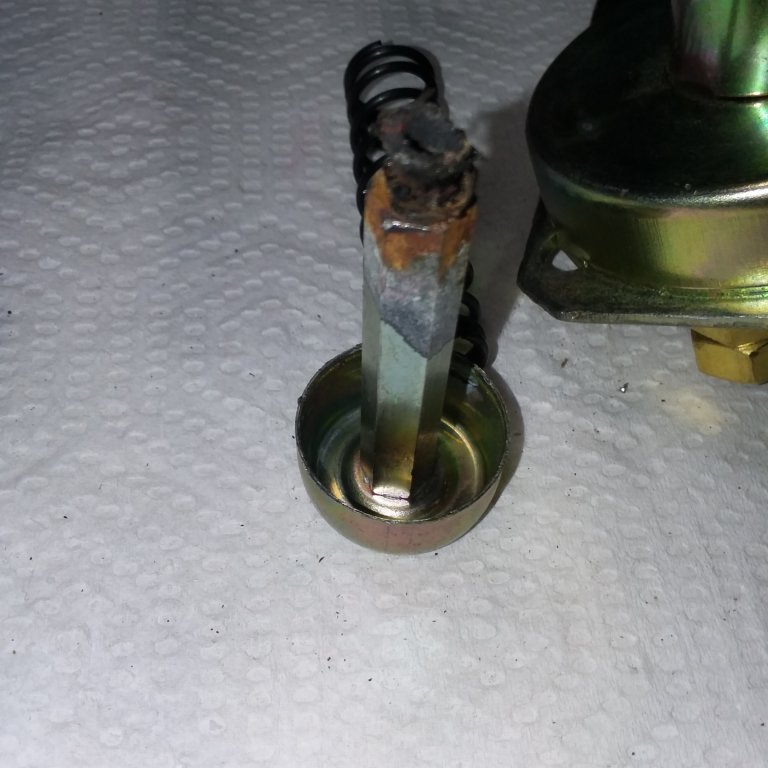

This is one major reason to have quick access to your shutoff switch.....
Starter was stuck on with the engine running. Without the switch I was done.....
