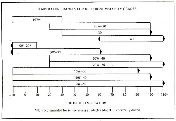

Model Ts require a motor oil that resists thickening in cooler weather. A 5W20 synthetic oil will give good results in cool season driving. If the engine rattles and knocks with thinner oil in it, it needs the bearings serviced. Putting heavy oil in a Model T to quiet worn bearings is a recipe for trouble, particularly in cold weather. Transmission linkage adjustments can cause problems, but if your car performs well when warmed up, it indicates the probability that the crankcase oil is too thick, whether from being too viscous a grade to begin with, or from having become loaded with sludge and gum.

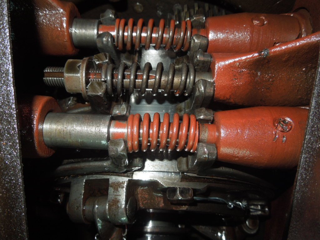

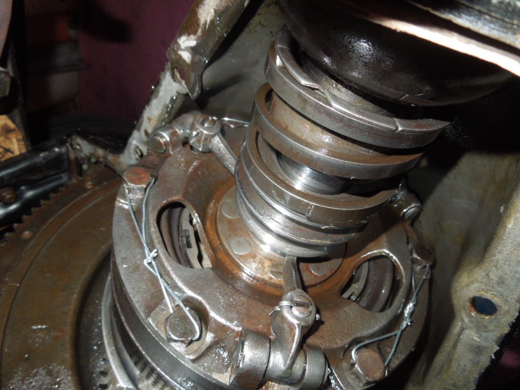

Here is a pic of inside the trans.

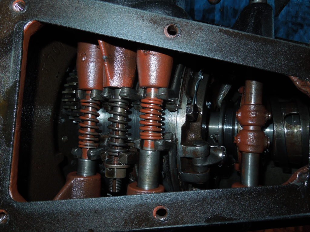

As much as that brake band spring is compressed, I'd venture to say you're too tightly adjusted, lining about done and or brake pedal could have "whonky bent" issues.

Steve - I have wound the brake back but now I have virtually nothing, lucky I have a great handbrake.
I'm hoping the brake lining is simply worn down, easy fix but it looks ok. Not sure if you could could tell when it's worn by the eye?

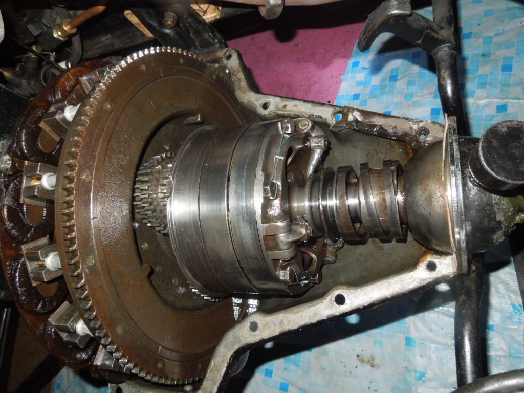

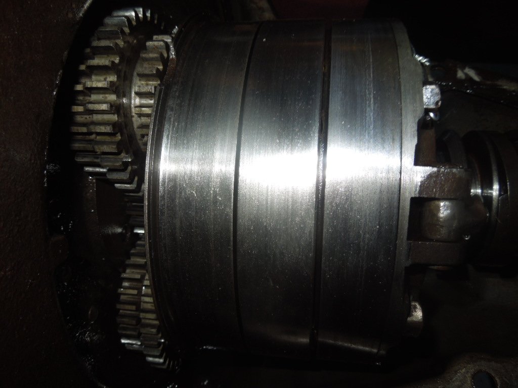

I removed the Hogs head by myself yesterday. Decided to replace all the bands, I intended to do it with HH in place but I couldn't see how to clear the pin and spring to allow the ear to be removed and then spin the brake band out? Remember this is RHD so the brake is an external adjuster. Anyway too late now its off.
After removal the Brake band looks more worn now I have it out so I'm hoping a new band will rectify and the brake drum feels the same diameter when running finger over them as the others so I might be in luck.
What it has done is provided some pics of inside the trans, maybe someone can see a potential cause for the binding?
I will reline the shoes today and finish cleaning all the surfaces.
I haven't removed or refitted a HH before so I would appreciate your experience and suggestions for the refitting process-
I have both felt and neoprene seals for the front arch on hand, what do you suggest and what sealant and/or method would you use. Would you run sealant on both sides if you used neoprene?
The same advice is appreciated for the ordinary base gasket and preparing for the refit.
Thanks in advance

- Posts: 5270
Re: Transmission binds when starting cold?
Dress the sharp edges of that chunk missing from the low drum.
Kerry
- Posts: 1464
- Last Name: van Ekeren
Reverse drum.
- Posts: 5599
It will make life simpler if you remove the 2 lower ball joint bolts and slightly pull back the rear axle assembly with a ratchet strap or similar to give you just a little more wiggle room to set the hogshead back down. Fun part is holding the shift fork steady whilst attempting to settle everything back into position. I cut a new ball cap gasket in half, cut off the top half of the existing gasket and run a bead of black silicone on both sides of the new gasket half. Not a really fun job but is very doable !

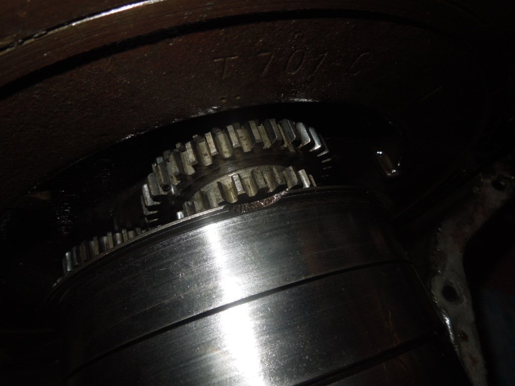

Thanks, I was planning on pulling back the rear end either with straps or the blocks of wood method.
The RTV rubbed into both sides of the felt is a simple option if it works.
I see that chip out of the drum but I am reluctant to grind it smooth as the filings will end up in the trans.
[attachment=0]DSCN3270.JPG[/attachment]
- Posts: 5270
Sharp edges will cut the edge of the band faster.
You can place magnets around the area to pick up the flying chips.
A few loose powdered iron bits wont hurt your motor. Minimize to be on the safe side.

- Posts: 7304
I have not found a need to use longer rivets with the sheetmetal spacers. I clamp the band and new spacer around a sacrificial drum, and drill the holes through the existing holes in the band. That way the holes will be in the right place.
I have no experience with wooden linings. Perhaps the spacers were needed in your car to make those particular linings work.
From your photo of the drums it appears that the spring between the ears on the first gear band is not seating very well. I'd be checking out the ears on that band.
