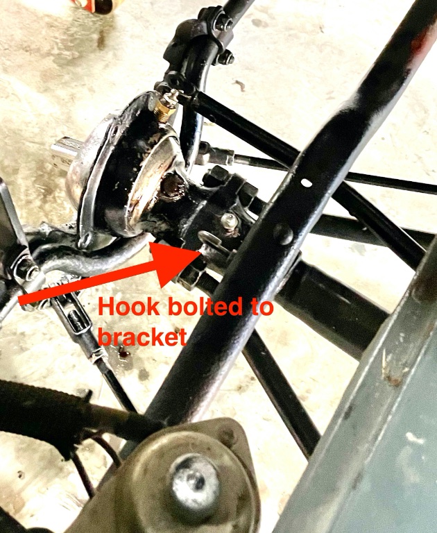

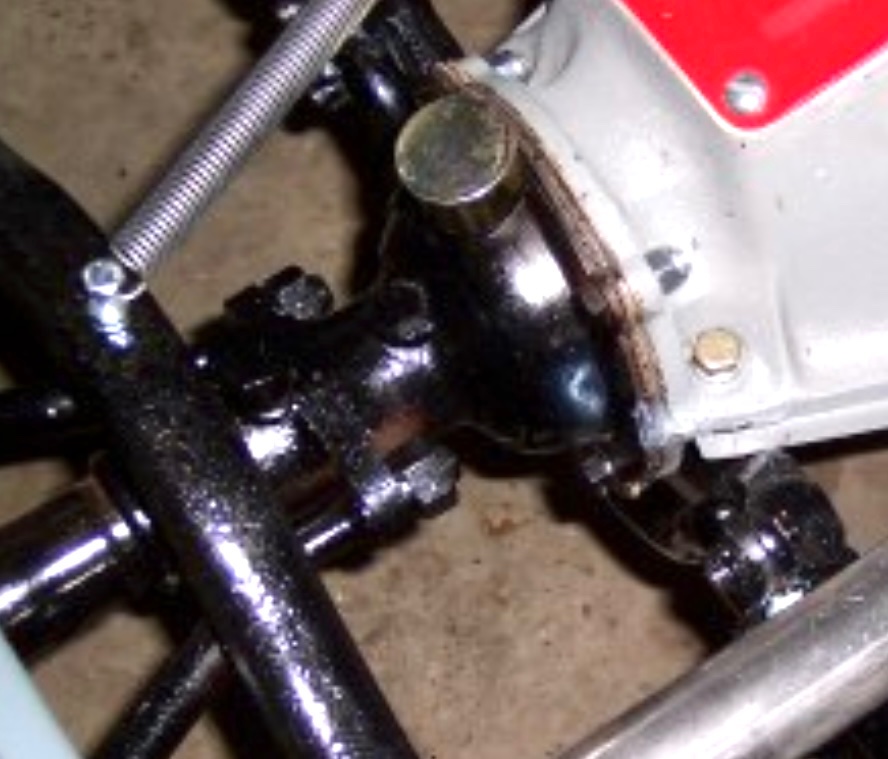

Use the running board cross bracket, don’t tell Original Smith, but drill a small hole and place bolt or hook to fasten the back end of the spring.
This was one way, but changed to a hook placed on the edge flange of the bracket more in line with the pedal. The angled position here hit the floor board a bit. Smaller dia. Spring prevents that too, but I like the beefy spring for complete release of the pedal and a firm feel when applying the brakes.

On one of my cars there was a small rod welded to the cross member behind the brake pedal when I bought the car.. I used it. On the other two, I used a small loop of bailing wire on the radius rod connects to the driveshaft behind the U joint. Both methods work fine on my cars.

Here the recent mount, a strong but open hook so it is easy to pull the spring and place the end on the hook. Keeps the spring inline with the brake pedal.
