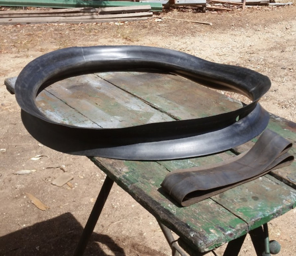

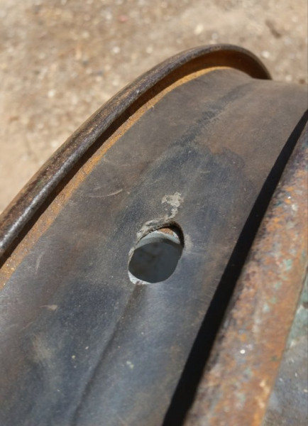

Here is a bulky new flap and a rim liner cut from the OD of a used 13" tube saved for me by my local tyre shop.
Here is the rim liner fitted to the rim. It is a snap fit and will not move when fitting the tyre.
I put the partially inflated tube in the tyre, clamp both beads in the rim at the valve stem, and lever both sides on at the same time.
I can't see the value of adding all that weight to the rotating mass of the wheel, let alone the significant decrease in my bank balance for a set of flaps.

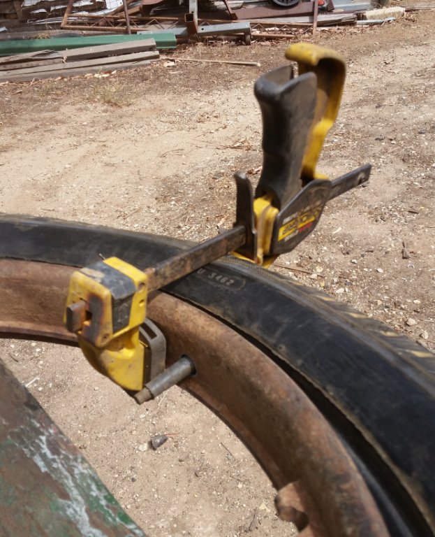

I used a clamp like show above and earlier to squeeze the old tire together and get under the bead to pry it off.

Maury, I can only say the flap will not come out of the tyre as you lever it on if you don't use it in the first place. No flap, no worries with it being displaced.
Your use of the clamps either side of the valve stem makes the job much easier.
