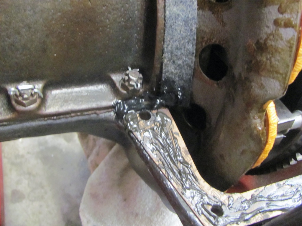

Glue the pan gaskets down with permatex hi tack, including the top 1/2 4th main gasket. The back of the motor gets a 1/2" wide strip of gasket material .062 thick. I have some rubber impregnated cork, but cutting a strip from a late 1 piece valve cover gasket works also. & it works for the varying thickness requirements for early & late T's It is also glued down. Nothing to slip out of position & leak down the road.
Top of pan gaskets get a spread of ultra black. The back of the motor gets a thick bead. Bead in the 4 corners. If you anticipate removing the HH, coat the HH's gasket surfaces with a thin coat of motor oil, it will seal, but release without damaging the gaskets.
Lay in the HH back to front. Setting the clutch fork first. Let it rest down in place. Remove your band holding device/method. Get band ears situated. Dont force the tie down, you may have a band ear out of position, etc. Start bolts middle/back to front. Lastly the 2 fronts & 2 rears. Work the bolts down gently all around until the extra ultra starts squeezing out. Let set overnight. You can trim the excess bead with a razor blade.
