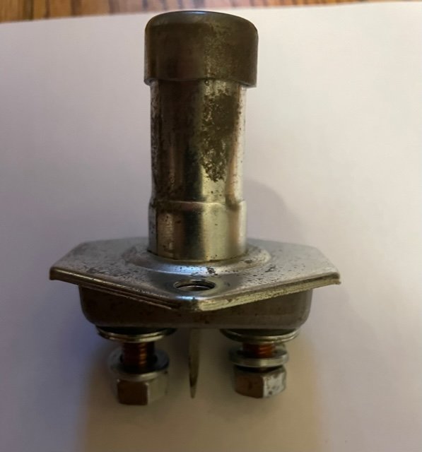

This switch sometimes includes a mounting bracket. Some designs even have a circular instead of hexagon base. There have been numerous discussions about issues with these switches and most everyone says get an original. https://mtfca.com/phpBB3/viewtopic.php? ... ch#p225125
Lang's, Napa, Tractor Supply, Autozone etc etc all the same

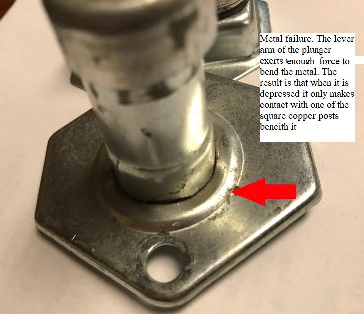

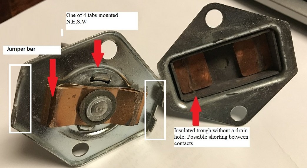

In order for the switch to work the plunger needs to be depressed straight down for the jumper bar to bridge both contacts. Sometimes a large hole through the floor board allows for some forward movement so only the forward parts make contact. Your problem may also be oxidation of the jumper or posts. You can open the switch by bending the 4 tabs (white rectangle). Also inspect the collar that the plunger slides through to see if anything is bent in that area.
The switch is what it is......

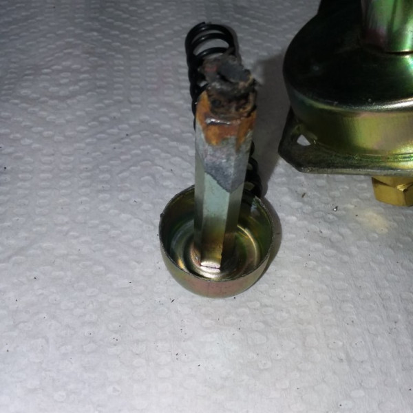

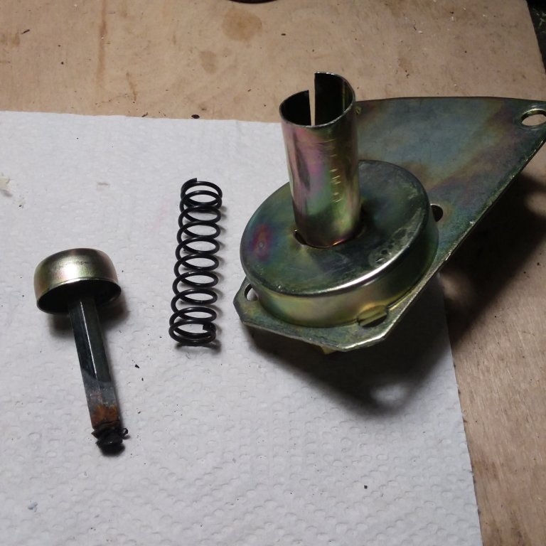

These switches, see below, are cheaply made and complete junk.

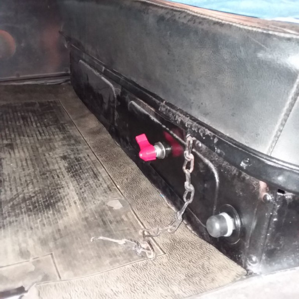

I changed to a 20amp push button starter switch and a 3 pole 6v solenoid(1rst pic).
Switch bent, causing short, causing the switch to weld itself on. NIGHTMARE!
Easy access battery disconnect/kill switch to the rescue.
