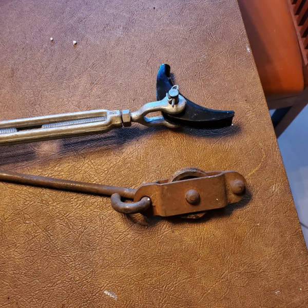

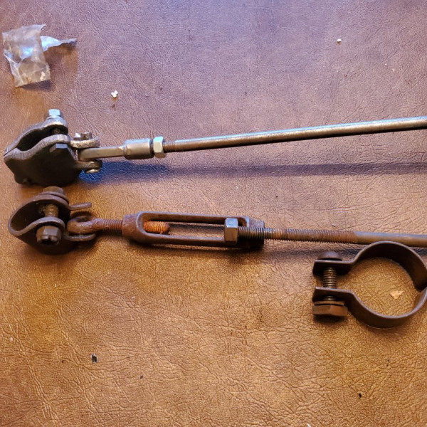

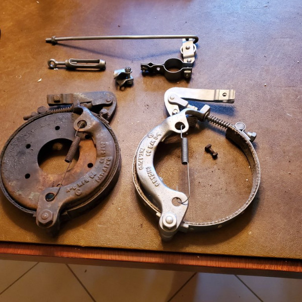

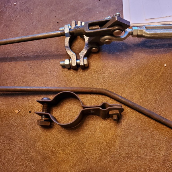

I knew the man who had the Rocky Mountain brakes made. He was a very nice person, with no mechanical ability. Initially he copied the original Rocky Mountain design, but never did the required research enough to find the equalizer components. It's funny that I've been able to do this 30 years later.
At a later date he became interested in the AC design on a 1926 that a mutual friend owned, so he decided to use that design, and call it Rocky Mountain! If he would have done more research, and kept the original design, things would have been better. He used the Bennett style equalizer which uses rods instead of a cable and equalizer, which necessitates a tab being welded to the brake pedal. The original design used a simple clamp that was attached to the brake pedal. To that was attached a short rod which went to a bell crank on the u- joint area, and from there was a simple equalizer, with a 3 inch pulley which went to the brake bands. A quick simple operation which could be installed even by an idiot in an afternoon. I have three running T's with these brakes and they all work fine.
Photos of an AC brake system. The original linkage is pictured next to Mc Eacherns reproduction.
