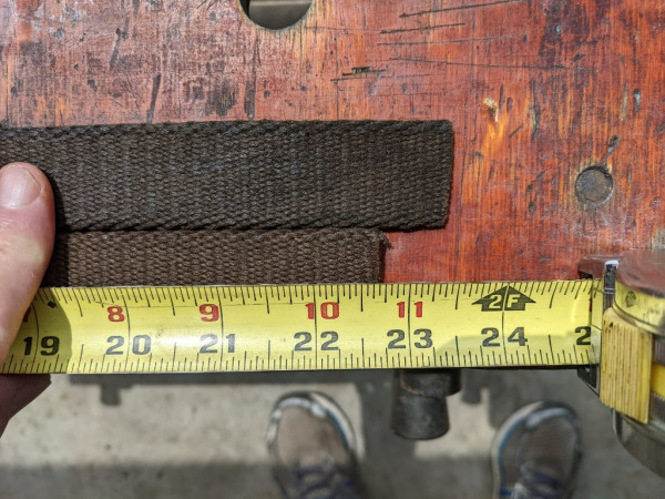

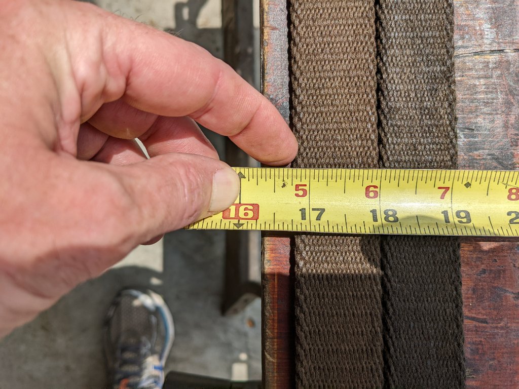

I was reading about the changes in Scandinavia band quality on the old forum. There were comments about things to look for in those bands. I have a box of ’26-’27 Scandinavia bands that my uncle bought in the 1990’s when he restored my car. One narrow band is missing and I assume that it is now in my transmission. I recently bought a box of ’09-’25 Scandinavia bands at an Antique store. There are noticeable differences between the early style and late style in my possession. They are different length (3/4”), width (1/8”) and color.
Both boxes have Cantex stickers on the sides covering the original printing. The ’09-’25 bands are 1 ¼” wide, 22 ¾” long and are brown. The ’26-’27 narrow band is 1 1/8” wide, 23 ½” long and black. The brake band in the later set is also 23 ½” long.
I read about changes in band lengths and color after Cantex took over production. Using a slip roller to lengthen later short bands was suggested in the older post. I have concerns about doing that. What if the band material shrunk after being installed? Could it pull away from the steel band between rivets and rub the drum? I was surprised to see different widths. What width is correct or best? If you had these, which type would you use?

The two styles of bands in my photos appear to have the same weave. They also appear to have transverse lines woven in at 1/4" spacing. Does anyone have an old band with a tighter weave? It would be interesting to see the difference.

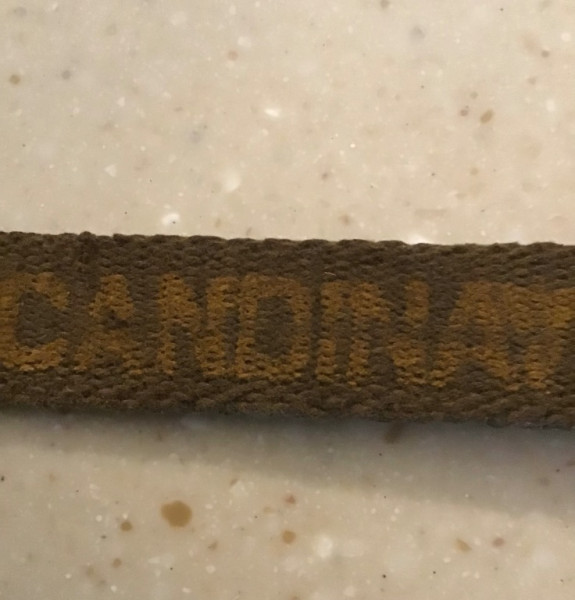

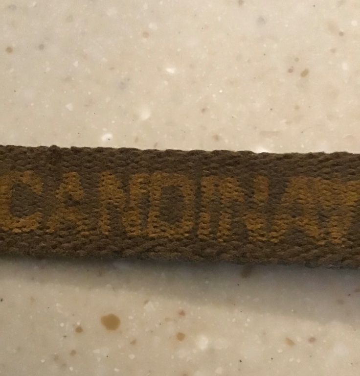

- Posts: 4683
Re: Scandinavia band lengths and widths

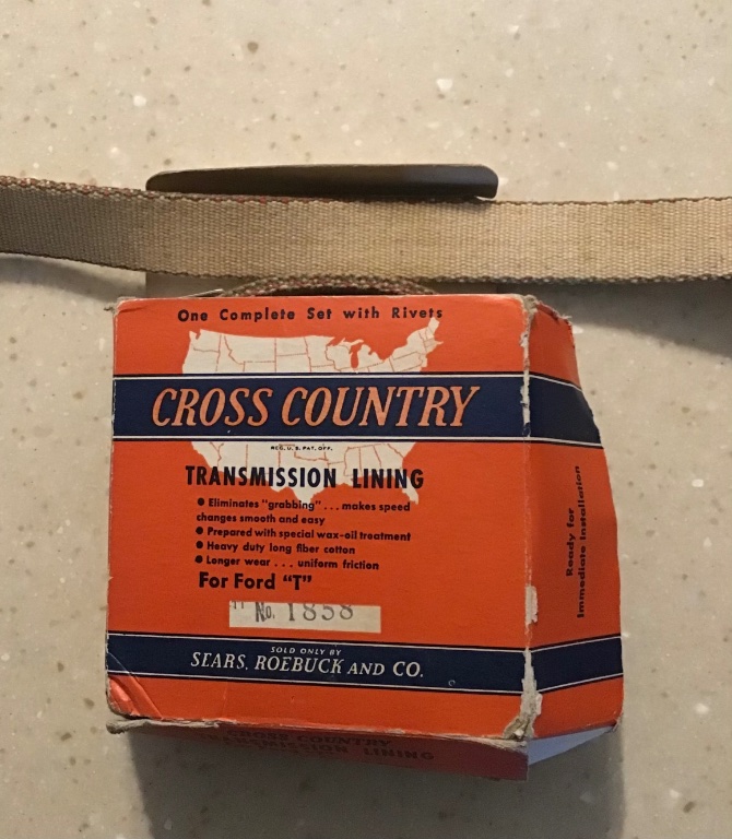

Here is an original Scandinavia band with the yellow printing on it and this set I have are 23 1/2” long. I went to check in my garage and they did have the printing as I remembered.
Also is a set of Sears Roebuck cross country bands that are 23 1/2 - 24” long.
The Sears bands are really tightly woven.
