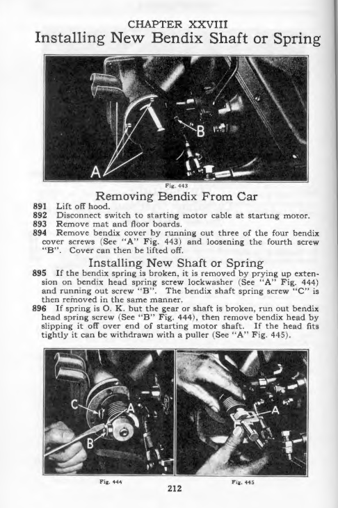

You'll want to download or even print this service manual.
http://www.cimorelli.com/mtdl/servicema ... ndexed.PDF
Chapter XXVIII shows the procedure to remove the bendix etc --

You need to pull the starter bendix, not necessarily the starter motor. Its likely the issue & will be obvious. Lost bolt, broken spring or counterweight. Whall the bendix is out, do a quick test on the starter.
Hit the starter switch & try to stop the spinning with a leather gloved hand. You should not be able to easily stop the motor from spinning with the switch engaged.
If you dont already have a T1 service manual, get one ASAP.
This manual is the bible of model T repair.
