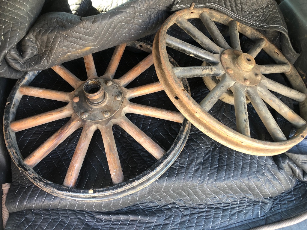

I bought a set of steel felloe wheels for 30 x 3 1/2 demountable rims. They have a punched raised piece at each rim mounting bolt location for a separate lug I’m guessing. Will these work with my fixed lug Hayes rims or did I but lawn art?
Bought them for rebuilding so that I can keep driving my T with the wheels on it.

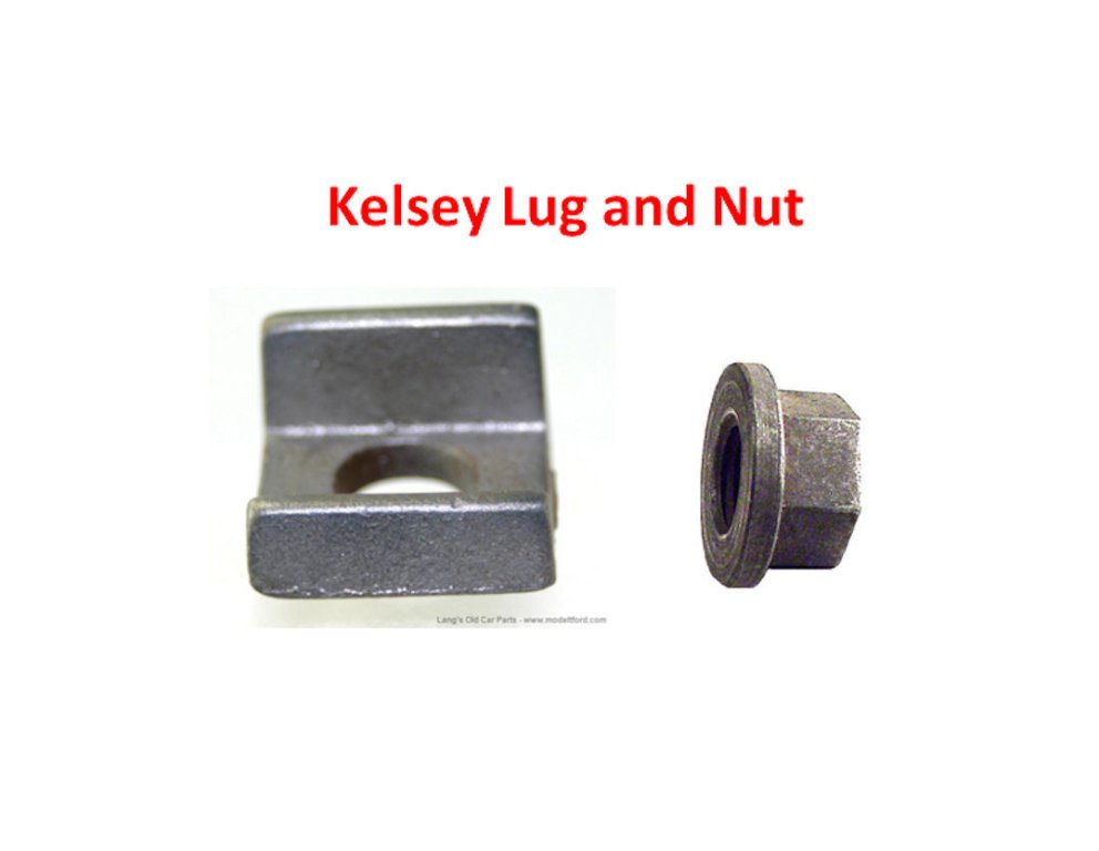

They are Kelsey rims, they use separate lugs and flat bottom nuts like this:
https://www.modeltford.com/item/2846B.aspx
https://www.modeltford.com/item/2848B.aspx
The rim bolts are the same as Hayes:
https://www.modeltford.com/item/2847.aspx
Kelsey wheels use the same 1/32" longer spokes as Hayes. Standard Ford spokes will be a little too short.
Hayes rims with the attached lugs and "feet" that extend back along the felloe may mount, but won't work well because the lug "feet" will prevent contact between the rim and the felloe except at the four lug locations. There will be a gap everywhere else.

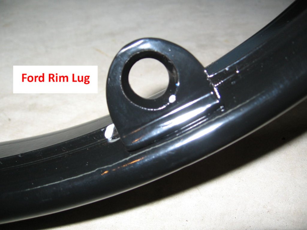

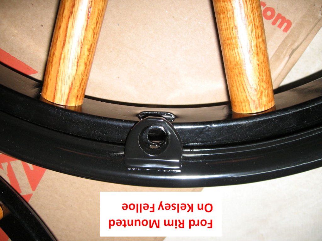

Others may argue, but I found that later Ford rims with attached lugs but no "feet" do fit with full contact on the Kelsey felloes, see pic.

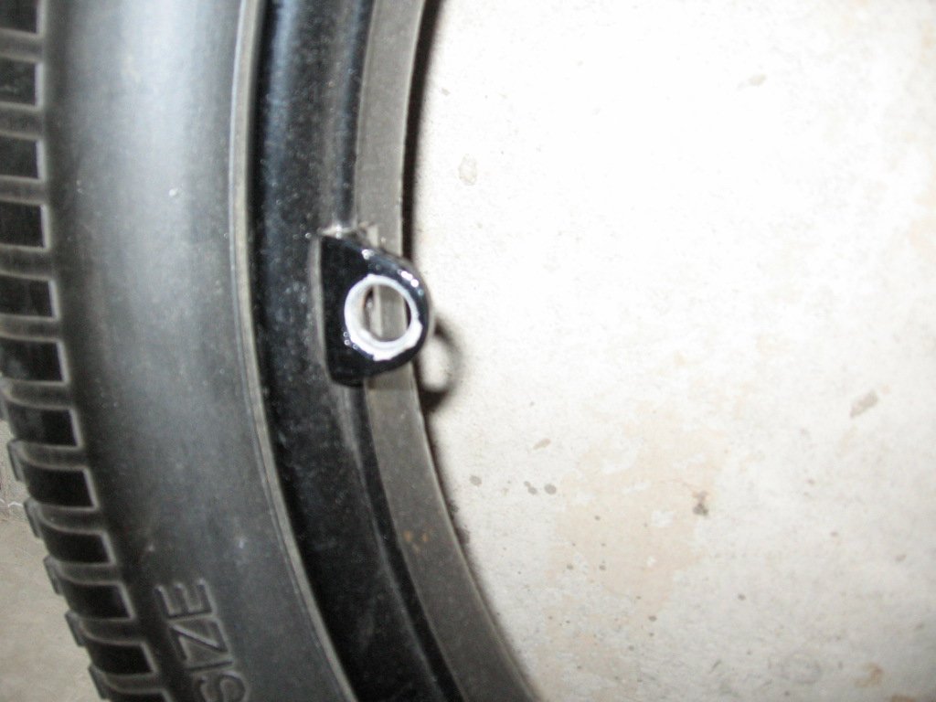

Here are pictures of the correct Kelsey 88 rim for those felloes:

Excellent photos Mark. The Kelsey 88 you show is one of two types. Your photo shows the rim with the rolled in land to engage on the felloe and the milled lug rests which accept the short end of the U shaped lug. This type of rim allows water into the assembly, causing rust problems. Also, the land for the lug wears more quickly due to the thinner rest for the lug.
The better Kelsey 88 rim has a flat base to the rim with a continuous solid bead around the rim to act on the felloe in the same way as the rolled in bead does. These rims do not suffer the same rust problems, and because the foot for the lug is solid, they wear much less, and are easier to repair if they do wear.

I’m so disappointed. I have all Hayes rims. Anyone need these wheels for what I paid .. $175
