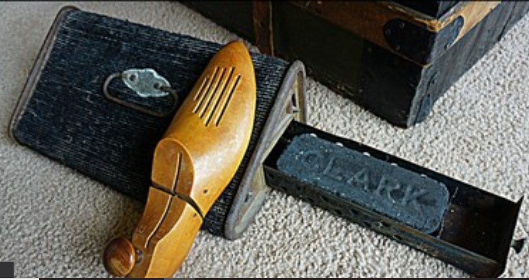

The Clark Foot Warmer using a charcoal brick. So as it burns Carbon Monoxide is being released inside the passenger compartment. Passengers then are subject to Carbon Monoxide poising - first headache, nausea they turn green and if not exposed to fresh air they may die. Asbestos dust & fibers are what's dangerous. Vinyl flooring installed between 1952 and 1986 likely contains asbestos, BUT if left undisturbed shouldn't be a problem. The same is true for hot water & heating units back when, but these require professional removal. Both require proper disposal.
