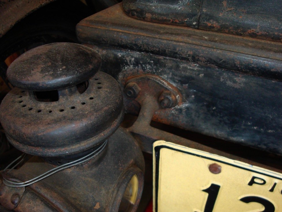

My unrestored 1917 roadster has hex nuts. Note the lack of quality control as one bolt appears longer than the other.
1917 has a one-piece tail light bracket but the location is the same as 1915. I presume hex nuts were used in 1915.

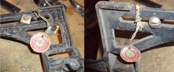

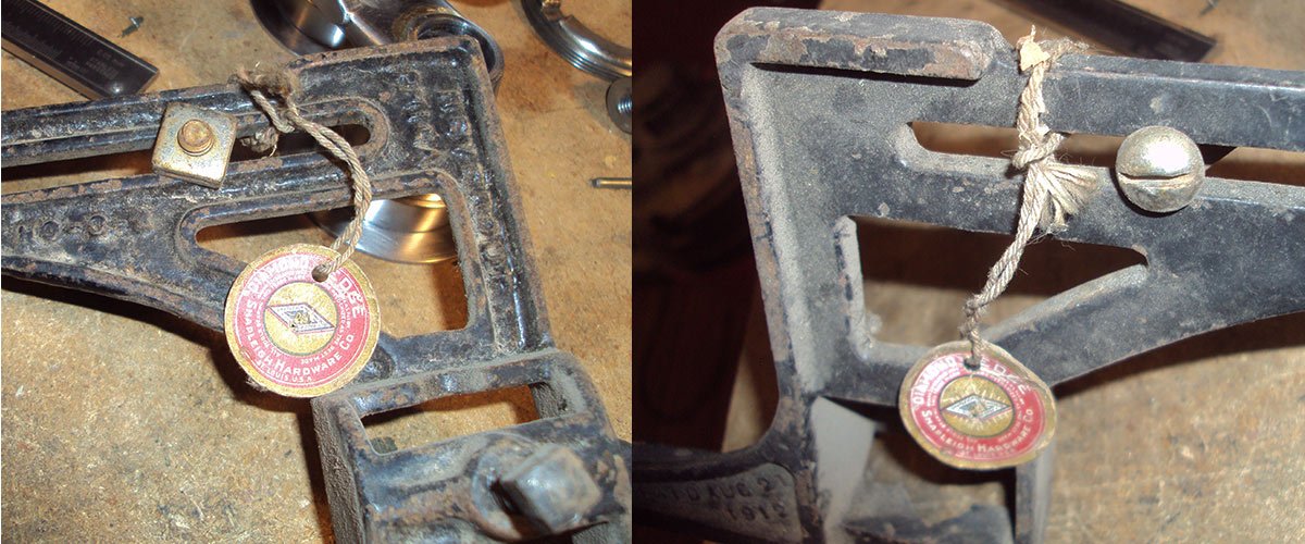

My thought is the factory would not supply bolts there. You would furnish your own if and when you bought your license plate. I have seen bailing wire there several times on survivors. I use stove bolts thinking they were readily available. That being said, this nice nickled bolt came with this accessory bracket (Pat 1912).

The question is about the bolts used to fasten the license plate bracket to the body, not the fasteners used to attach the plate to the bracket.
Re: 1915 roadster license plate bracket to body bolts
Good call Erik. We should all read more carefully. It would make sense that the carraige bolt head stayed in the wood and the threads stuck out to mount the bracket. The question would be if square or hex bolts would be used. My guess is large hex with lock washers as your photo shows.

5/16" carriage bolt. The head sinks into the wooden sill from the front of the car. The nuts go on the outside. You should be able to determine the length of the bolt by trial and error. It goes through the wooden sill, the tail lamp bracket, the lock washer, the nut, and has 1 or 2 threads left over. I don't remember whether it's a square or hex nut.

There are no lock washers on my roadster tail lamp bracket (see photo I posted earlier).
