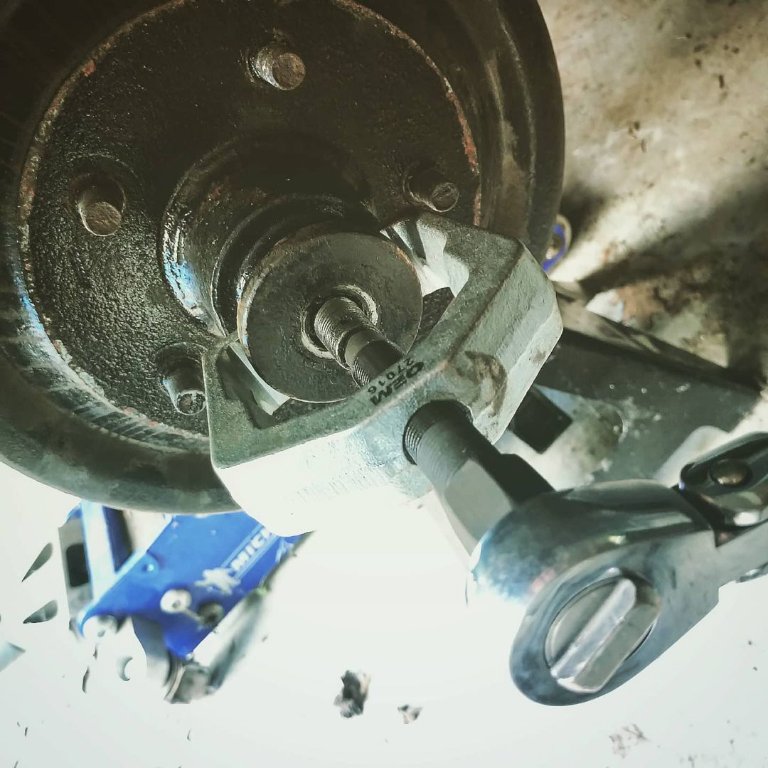

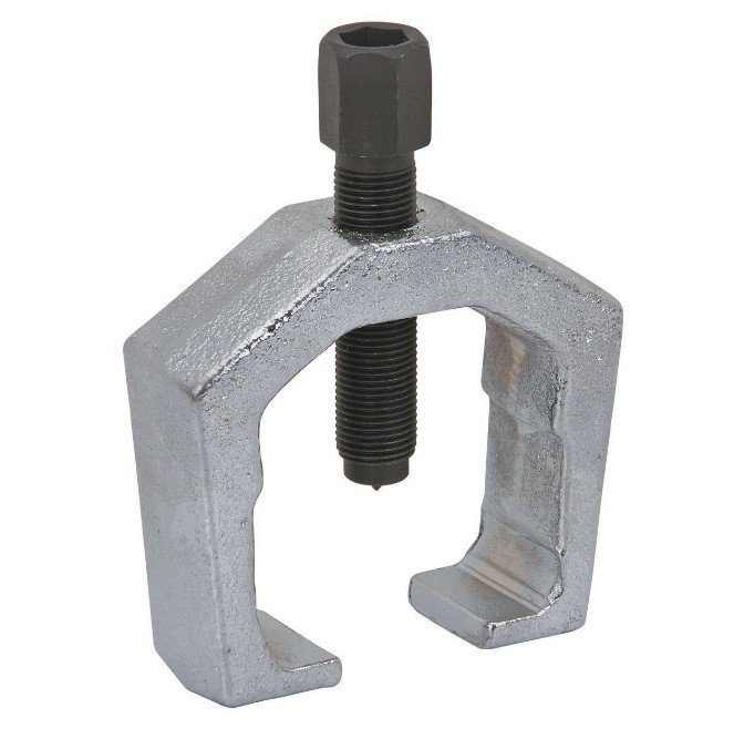

You can buy this pitman arm puller from Harbor freight for $16.00. with a little grinding it makes an excellent puller for the wire wheel hub.

You can buy this pitman arm puller from Harbor freight...
Does it fit the Model T pitman arm?
jsaylor
Posts: 427
Last Name: Saylor
Location: Citrus Heights, Ca
Re: Rear Hub Puller
Post by jsaylor » Mon Jul 18, 2022 2:53 pm
Unfortunately it does not fit the Model T pitman arm. It's too wide.
Yep, it works great!
