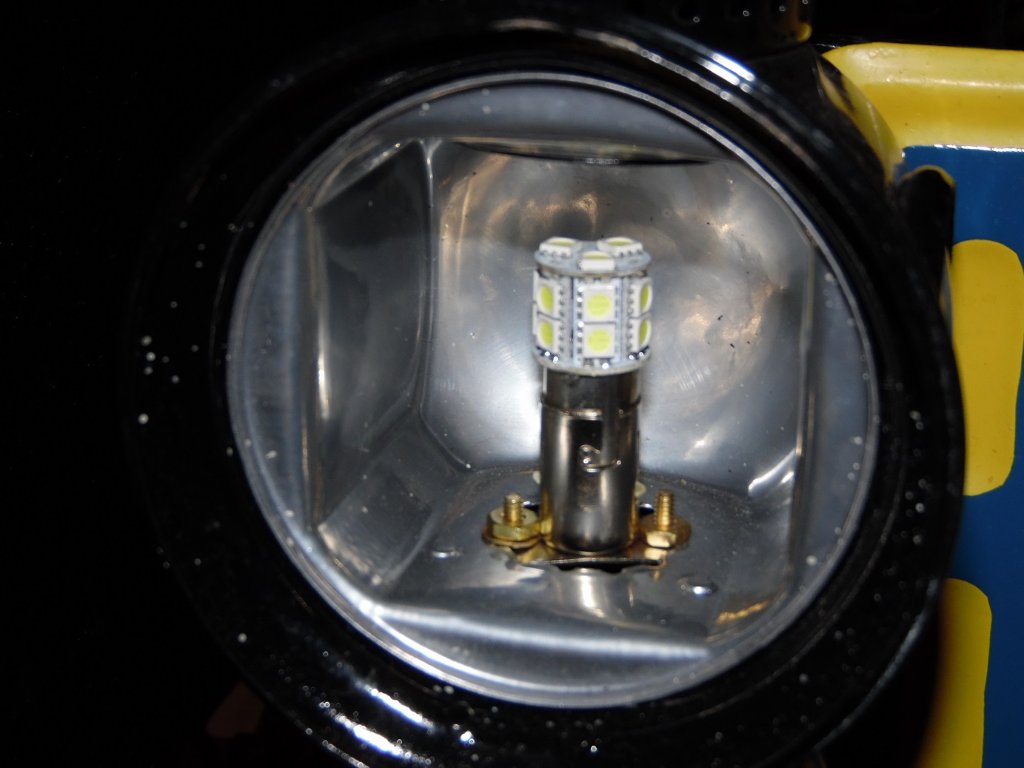

I made mine. Hardest part was finding metal sockets so they could be soldered to the wire. Mine came from 80's Japanese tail light assemblies at the wreckers. Later stuff is all plastic.

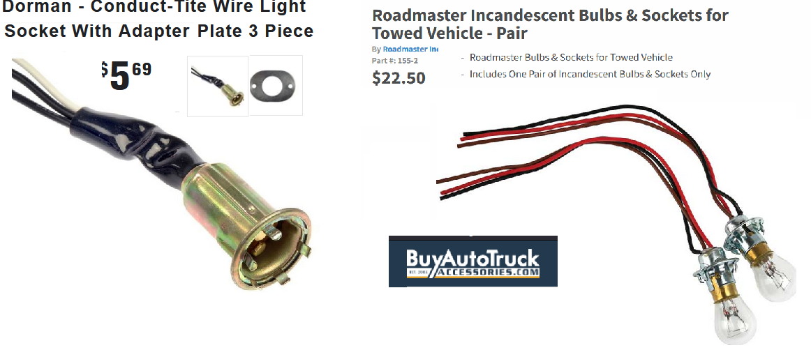

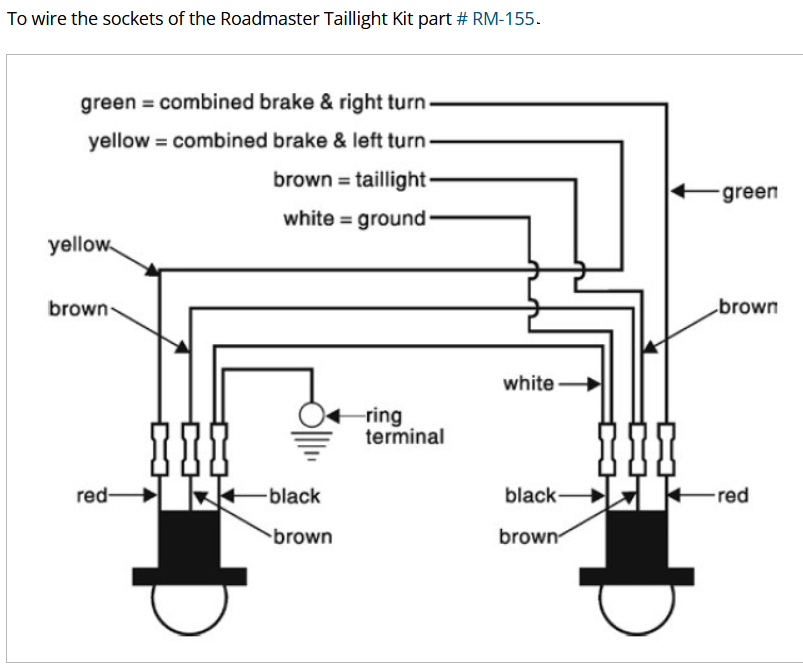

I found an old ad on the internet for one that Lang's sold. It appears to have 3 wires similar to what a trailer might use. After looking at Internet search results for Model T oil Lamp conversions there were a variety of solution. There are many 2 & 3 wire sockets available that could similar to what you have. So do does yours have 2 or 3 wires and is it set up for brake, turn and running light or what ? The number of wires would be tied to how they were connected to the rest of the car - like
A picture will help as well. By the way converting an oil lamp use to LED's would also be a possibility. I'll be glad to see if I can find a solution for both.

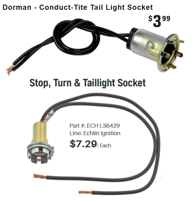

If just 2 wire these would work and there are many more styles

Frank,
Thanks very much for your diagrams/pictures. I already have a three wire socket in the lampo fixture....works brake light and directional. I want another light - a running light, if you will. My electrical skills are negligible, and the easiest solution for me was to by the accessory years ago. Adding a bulb is overkill, yes, but as I say, it was easier to wire that than to mess with the existing wiring...although I may attempt that, thanks to your diagram.
Attached are the pictures of the one I have. Although the white wire is apparently ground, the snap ring works for that purpose as well.

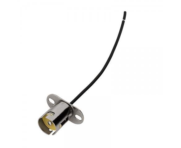

Post by WayneJ » Wed Jul 20, 2022 10:59 am
You don't need anything fancy. I bought bayonet sockets from NAPA, but this socket illustration is from Superbrightleds.com, so they carry them also. I replaced the tail lamp and side lamp burners with this type of socket, and secured it with two small screws, nuts, and washers. I ran the wire through the hole where the wick raiser went. Other than removing the burner, no modifications were made to the original kerosene lamps. I used two filament LED bulbs in the taillights, and a conventional one filament bulb for the front turn signal / side lamps. The conventional bulb in front gives enough resistance to make the flasher work properly. The LED taillights bulbs allow me to run taillights full time, if I choose, with a low current draw. I run the lights from a small 12 v battery. I found it helpful to run a seperate ground wire from each lamp to a good ground on my car.
Wayne Jorgensen, Batavia, IL

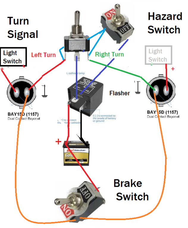

A two filament socket with 3 wires has 1 for the ground,. One way to wire is for filament for parking(dim) light and another the taller filament for for the brake & turn lights. So this is just a simple diagram (example) to show how things are wired WITHOUT overrides. Overrides are needed to cancel a function like turn signal when brakes are applied. The diagram shows to light switch boxes but there is only one
So the turning on the hazard Light or a Turn signal switch would light the lower filament but only the Brake switch would light the higher filament.
The Flasher shown has 2 prongs because the case is plastic and a ground connection is needed. Metal two prong flashers are usually grounded
Relays are used to manage the overrides.

Thanks Frank....
admittedly, I am challenged by the mysterious forces of electricity...but stubborn, and want to learn. (Dangerous, I know).
Where do the relays (overrides) plug into the system?
I have a two prong, 12 volt flasher - located under the rear seat, near the power source - unlike the adapters used in households to plug three pronged appliances into two pronged outlets, there is no ability to plug a relay into the back of the flasher. Do relays have that ability....can I go wire-relay-flasher? But, if I can, that still gives me the challenge to rewire the directional switch under the dash.
Looking at your diagram, I would need to rewire the directional switch...under the little bitty "dash" panel on my '15.
I already have a brake light in the left lamp (two bulbs there), I am just trying to find a simple way to put a brake light in the right lamp. As you probably know, the car came with only the left side lamp...years ago, I acquired a similar lamp and mounted it on the right side to get directional signals.
Signals and running lights I have in the right side....it really seems simpler to add another socket and bulb into that lamp to get the brake light I desire.
I do like the ability to have only one bulb in the lamp.....a rewire project for the future.

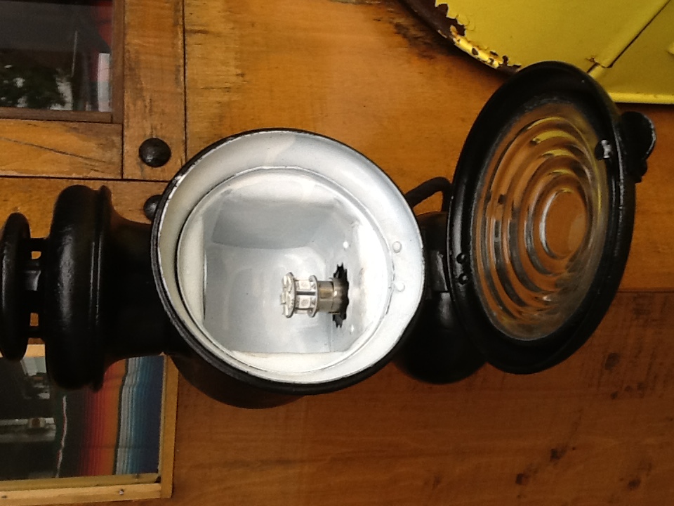

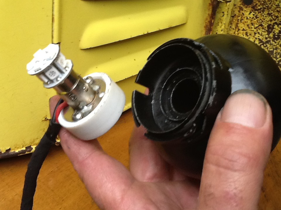

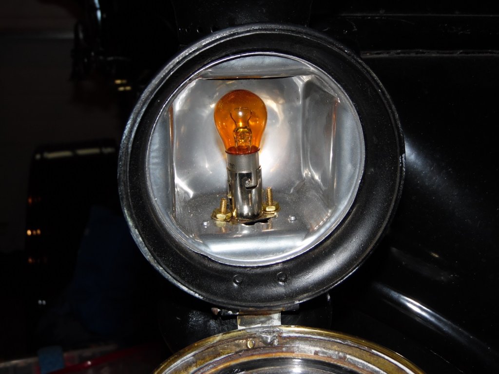

I found a way to electrify your tail or side lights without butchering anything, i took a lump of nylon and turned a piece that was the same height as the wick holder and mounted a generic bulb holder on it. That way you can change out the wick holder for the bulbholder in a matter of seconds, the bulbholder is held in place exactly the same as the wick holder by mounting the oil reservoir. the wires go out through the hole where the adjusting knob for the wick goes out.
I used nylon because it was at hand, but a piece of wood and some simple hand tools should do the job too.
Leo van Stirum, Netherlands

The original vendor supplied units clipped in place. i made mine that way. There are no holes to drill in any Ford part. The burner assembly can stay in place. The wiring can be fed down through the chimney. A connector can be used so that the electric light is easily removed, allowing the lamp to be lit for night parades. What's not to like about this?

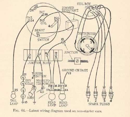

I have a non-starter 1915 which apparently was equipped with mag lights...headlights and taillight, which also illuminated the license plate (clear lens on the side of the lamp).
Light control is by a pair of push button - NOT 'PUSH-PULL' . the pair are arranged sided by side imbedded in the left side panel, where a door would be. Pushing the top button of one pair closes the circuit, lighting a headlight (dim or hi), the tail light, and pushes OUT the lower button. To turn out the lights, push the lower button, lights go out and and the upper button pops out.
Now, to the question: there are two wires going to the taillight...when those wires are separated, and not connected to anything, the headlights do not work. DOES ANYONE HAVE A DIAGRAM THAT SHOWS HOW THOSE WIRES ARE CONNECTED TO THE BULB, and, if possible, any thoughts as to how a directional signal could be wired into that bulb? The diagrams I can find on the internet show only ONE WIRE going to the taillight...I have two going there...to what should each be connected?
Thanks,

Your statement of magneto power to all three lamps, and that disconnecting the tail lamp's two wires kills the head lamps, strongly suggests that they are wired in series, much like the Christmas tree lamps of yore.
One of the wires to the tail is power FROM the head lamps and the other tail lamp wire is BACK TO the frame of the car to complete the circuit.
I hope that this helps.

Posts: 6588
Re: tail light electrification
Post by TRDxB2 » Sat Jul 23, 2022 11:13 am
aDave wrote:
Sat Jul 23, 2022 7:39 am
Digging deeper raises another question, but first, some explanation.
Thanks,
Dave
A non-starter car was wired differently than a starter. But the attached diagram doesn't mean that is how your T is wired, someone may have rigged it up differently. As BHarper says the headlights were wired in series. That's because the Magneto puts out more than 6 volts and is known to burn out headlight bulbs. See Diagram. I am working on a taillight setup, my diagram above, (brake, turn & parking) using the same LEDs used for that in modern cars they are extremely small. I have some parts ordered, the pigtail sockets prices in the Auto Supply stores were way high. These LED bulbs have dual filament type meaning the one bulb is for brake, turn and parking. While they are for 12v - I am looking into some options for powering from 6v Model T voltage [generator, battery with a BOOST converter (6v to 12v up to 10amp)] as well as running off a motorcycle battery. The amperage draw is so low recharging isn't needed that often.
non-starter disgram.jpg (43.2 KiB) Viewed 5875 times
