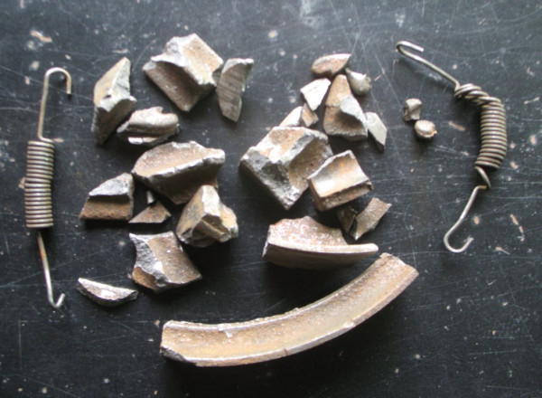

Mine did the same thing. I think it was the brake shoe on one side where the lining had separated and was flapping in the wind. I still replaced the thrust washers inside.

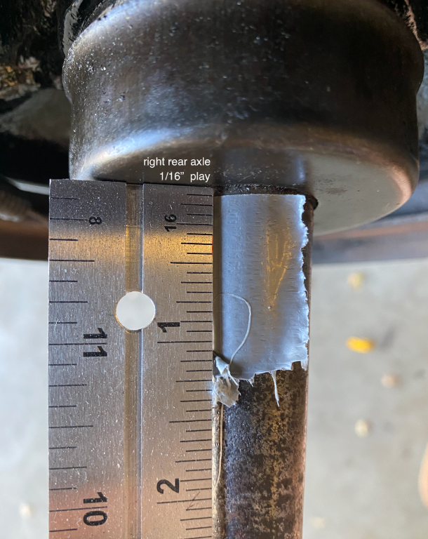

I tested the rear axles today as suggested. The left rear axle was firm with no in or out play. The right rear axle could push in and out by between 1/16 to maybe 1/8". I'll measure it more securely this weekend. I don't recall getting the same thunking noise, or feeling a pause, but then it's different rotating a wheel as opposed to a bare axle. I cranked the engine over and both axles rotated. The engine chuffed as expected.

With that much play I'd recommend taking it apart and checking. There shouldn't be any movement if everything is correct. May be time for new thrust washer(s). Or it may be as simple as needing additional spacers between the axle ends in the differential. Also as stated earlier, no gasket after the 4th main. The collar needs to be right against the fourth main to keep the ball tight.

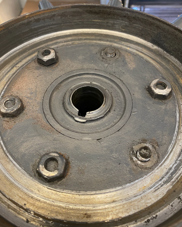

It definitely looks like I'll be opening up the rear axle. The bolts holding the wheel to the brake drum were actually too short, not even going fully through the nuts. There is some wear on the bolt holding the right hand brake shoe on. I'll check the left. Doesn't remove the axle play issue though.

The bolts should be just about one thread beyond the nuts and then peened down so the nut won't come off. They might have been the correct length but not peened so the nuts began to loosen. That could be the only problem causing the drum to move toward the backing plate and become worn. However it could also have been caused by wear on the thrust washers between the inside of the axle housing and the differential carrier. Note wear on the washers at one end of the axle will pull in the axle on the opposite side of the assembly.. This type of wear could also be caused if the nut at the end of the axle is loose causing movement between the end of the axle and the hub and wear causing the hub to go farther on the axle than normal So a thorough inspection of the entire assembly is a very good thing to do and replace or repair all worn parts.

The wheels are getting new bolts, so I'll cut and peen them properly as you suggested. Thanks for the "one thread" note. One of the axle nuts was very firmly set, the other not so much. Neither had cotter pins, probably because they were removed when re-restoration started. Looking forward to getting into the axle.

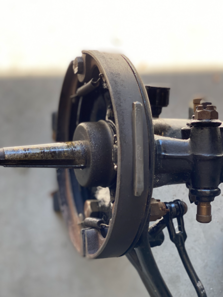

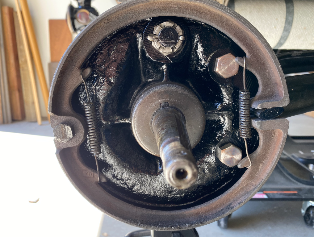

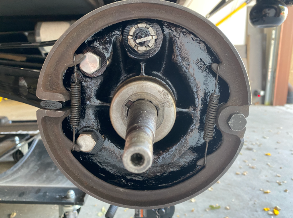

Here's a view of the rear axle after the wheels came off. I'll take a few more of both axles over the next few days.

Just curious you do see there is a axle key on your brake. What’s that about? Ha, probably just put there after wheel was removed, i at least hope so.

The axle taper looks fretted and the key looks a bit worse for wear. Was the hub tight on the axle shaft? If not, it may have made the noise. It should have been somewhat difficult to get the hub off the axle shaft.

looking again at your drum, the wheel has been running for a long time "too far in" on the axle. The parking brake shoes should not be touching the drum, and there should be NO marks on any bolt/nut heads associated with the backing plate. Such installation will most certainly involve wheel bolt/nut coming in contact with stationary features on the axle backing plate (and there is evidence of it). If ever there is or was a cause for a "thunk" when rotating the wheel, this is it (and it may be the ONLY "it").
The axle shaft, well it is it's own subject entirely and possibly worthy of its own thread after test-fitting your wheel(s) and seeing what you really have going there.
Once you get the correct bolts/nuts on your wheel you may even find that the wheel will not even rotate at all. If so, you can be pretty certain you found the "thunk"...and if adding some shims to the axle moves the wheel out to where it should be and solves it, then you definitely found the "thunk". Here's a hint: when installed and socked down, when new, the brake drum would NOT cover over the backing plate. In fact, when things fit correctly, you can sometimes even see a hint of brake shoe peering out from inside. Cars like yours...well they almost always overlap to some extent...that extra inward seating invariably starts to let rotating bits foul with non-rotating bits.
even so, you may wish to do a complete teardown to assess the internal shims (the endoscope will show if passenger side is bronze or babbit and if bronze, all but obviates the need to tear the axle down to see what you already saw with the endoscope...the likelihood of a bronze washer on the right side and babbit still on the left is pretty remote, I think). Now, I don't disagree with the wisdom of tearing it down to be absolutely sure...I just disagree that what you described "had" to be an internal problem (from a probability and design standpoint there is little internally which would cause a bind or bang once every revolution of a wheel...pretty much any as-is T that ever came through my shop exhibited that exact issue to some extent or at least had evidence that it had in the past).

From that photo of the hub bolts it looks like some new, longer ones are called for. Since we lost RV, are his high quality bolts or their equivalent still available from the parts dealers?

Here's a view of the left rear axle, with no wear evident on the brake shoe mounting bolt.
Also, a view of the right rear axle, showing the amount of play. With the dust cover held firmly in place, the axle has 1/16" play. The left rear axle has no play. I haven't gone through the differential housing yet, and will this weekend. I'll look for an endoscope as well.

Either your new dust cover is not seated far enough or your wheel is going on too far. Or both. The wheel is scrubbing on the dust cover and it appears that the key went on too far up the axle shaft at one time, bending the cover and "pecking" at the cutout for the key. This catching would happen when the wheel was rotated. That could well be your "thump".
they're never (or rarely) there, but a front wheel felt seal is supposed to fit in the recess of the rear hub...the wheel should never come in contact with the seal cover...only the outer wheel-felt should. As it is, your wheel is grinding against it.
Go here for more info: http://www.mtfca.com/discus/messages/82 ... 1541507398
