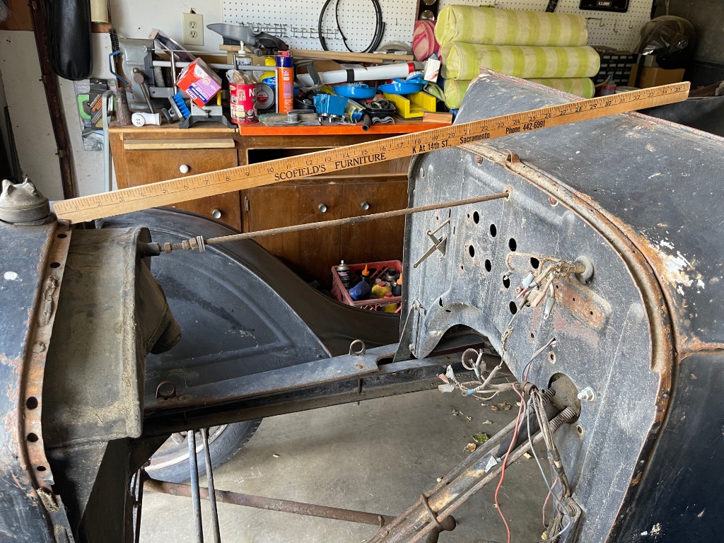

Verifying Year of Manufacture: Touring Car

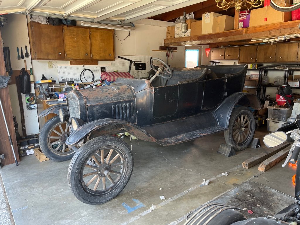

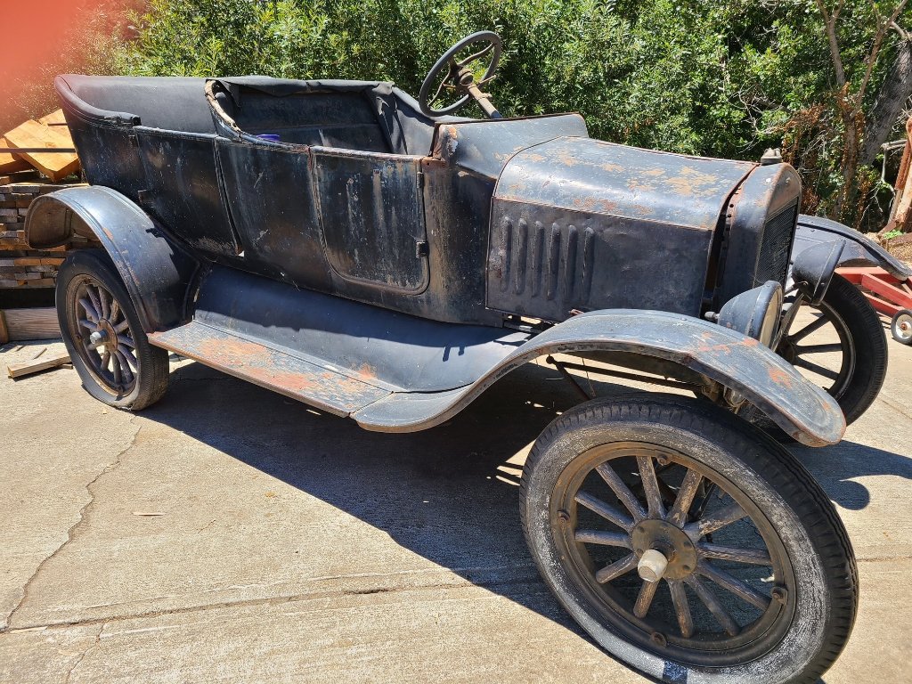

Picked up this little gem just a couple of days ago and can't wait to get back on the road. Engine has been overhauled and rebuilt 3 years ago but not put in as other work was not yet done. The owner then had to sell the car off which was my lucky day.
The engine serial number has been researched and shows a "production time frame" of May 1926 (s/n 13676708). I was told, as was the prior owner, the car was a 1925. Looks like it may be a "low cowl" but I need more practiced eyes to confirm.
Thanks!!
Tom

Re: Verifying Year of Manufacture: Touring Car

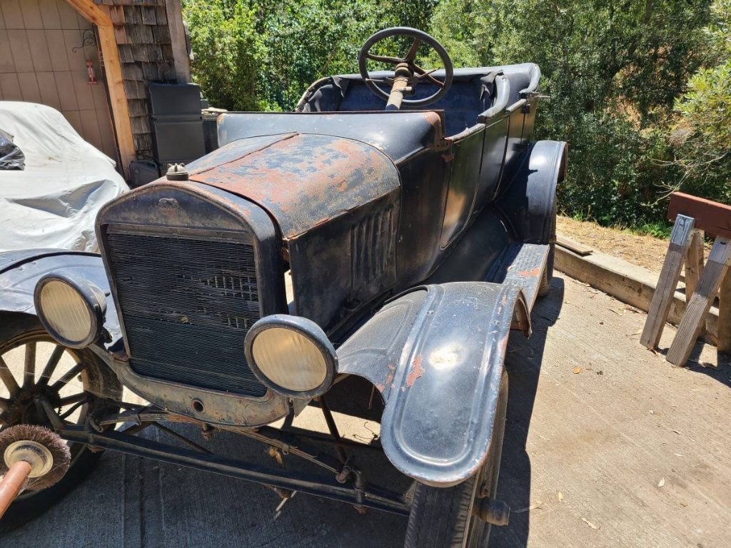

The car is a high cowl. Others will have better knowledge of the year.
Art Mirtes
Art Mirtes
- Posts: 4694
You have a high radiator and the splash apron under the radiator, which were both typical of the 1925. The engine is a 1926. The body is NOT 26. Almost all Model T's on the road, unless restored by someone very particular to have everything date correct, have parts from various years since most can be interchanged with very little modification.
First of all the May 1926, 13.6 million engine number, is a replacement engine. Second the body is high radiator type and the front door hinge is the trapezoid type, ( door swings up a little when opened ), of 1924 and before. The 1925 hinge is more square. The radiator and the hood is for a low radiator car but shell is 24-25. The front fenders have the front lip of the high radiator cars and look to have the 1924 type exposed beed at the splash apron. The 21 inch straight side split rims were first offered by Ford in 1925 but were refitted to many a T in later years threw WW 2. Check your hand brake ratchet and look for the number of mounting rivet’s, four rivet’s were used in 1924 and two rivet’s were 1925. If your car uses the 1926 type brake drum and hogs head the pedal spacing will be a little different from 1924-25. If your car’s DMV paper work shows a year model of 1925 and matches the 1926 engine number then just go with the 1925 year model but when ordering body parts there will be some small difference’s with the 1924 bodies.

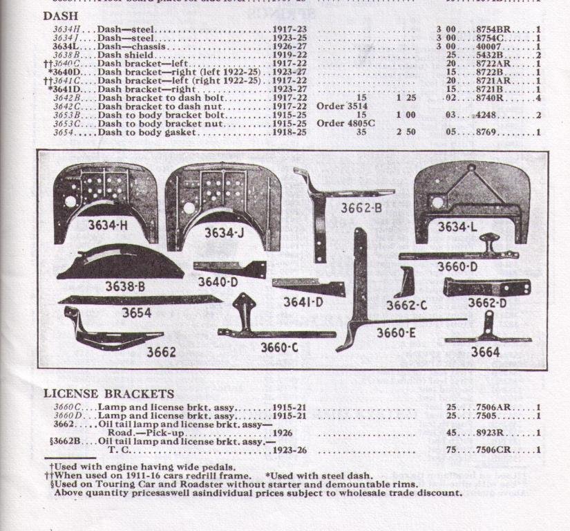

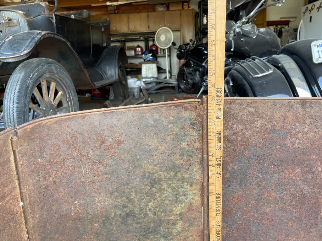

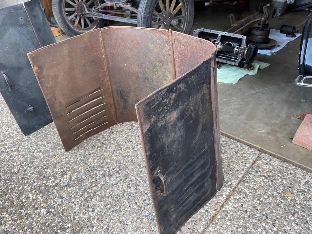

Very good observations. So late 23 or 24 primarily. I do see a divot in the hood for the latches. That would make the hood a high one.kmatt2 wrote: ↑Fri Jul 22, 2022 1:36 pmFirst of all the May 1926, 13.6 million engine number, is a replacement engine. Second the body is high radiator type and the front door hinge is the trapezoid type, ( door swings up a little when opened ), of 1924 and before. The 1925 hinge is more square. The radiator and the hood is for a low radiator car but shell is 24-25. The front fenders have the front lip of the high radiator cars and look to have the 1924 type exposed need at the splash apron. The 21 inch straight side split rims were first offered by Ford in 1925 but were refitted to many a T in later years threw WW 2. Check your hand brake ratchet and look for the number of mounting rivet’s, four rivet’s were used in 1924 and two rivet’s were 1925.
- Posts: 6579

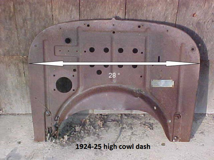

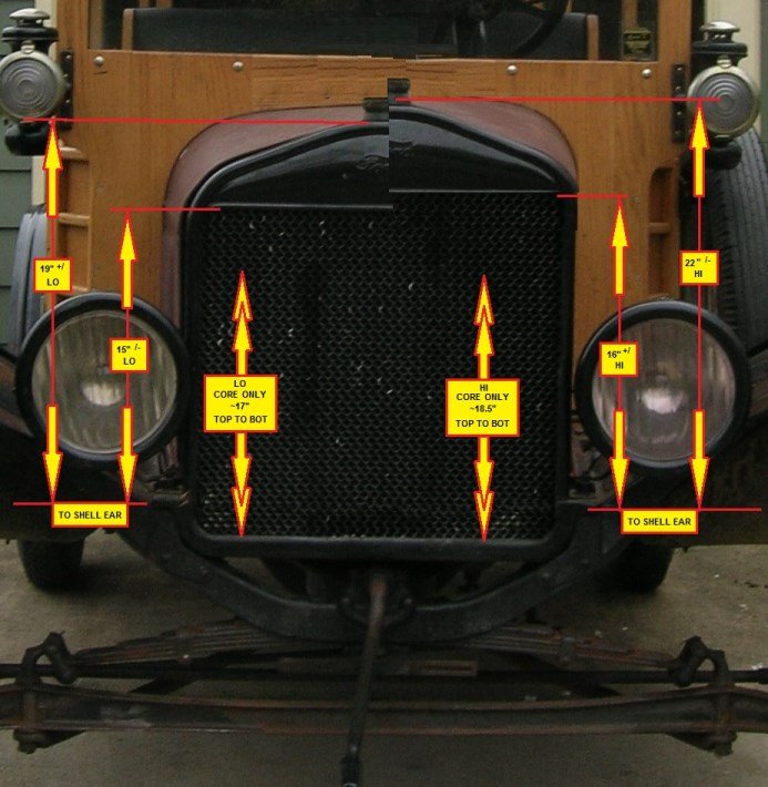

Running Boards are 1925 and prior

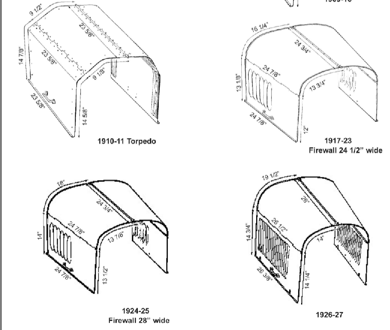

Here are dimensions for the dash(firewall), hood and radiator shell -- -- --

Another reason I believe its a ‘24 are both rear fenders. Altho’ they could’ve used up earlier parts on a ‘25, I’ve learned 1 year only 1925 rear fenders had a small ‘curve’ where they attached to the outboard of the running boards.

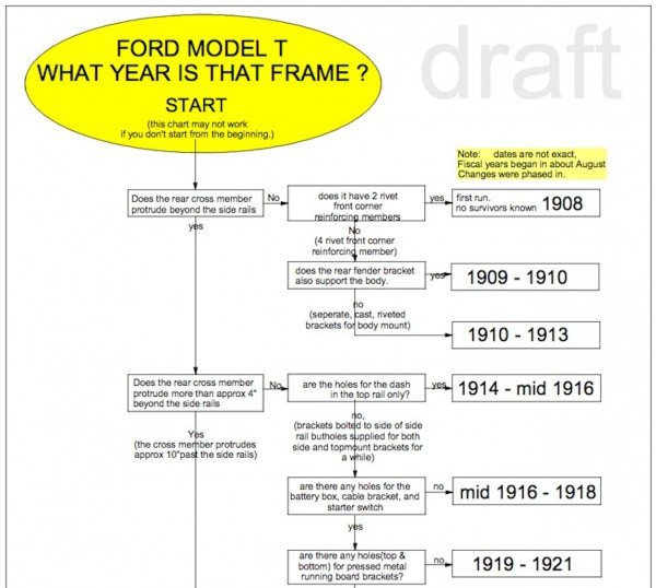

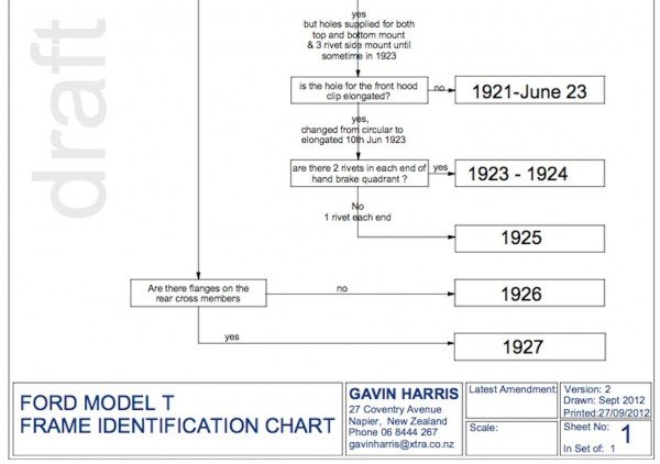

There are not a lot of part differences between 1919 & 1925 and in some cases they are very subtle. So before you start you need to decide what you are attempting to do with your restoration (as it came of the assembly line, show competition, period correct, within a budget. So far there is agreement that the engine number is a 1926 and the car is not (24 or 25). It has been stated in the Model T Encyclopedia that the engine number should not be used to date the car because they are often replaced.Tom Dove Jr wrote: ↑Fri Jul 22, 2022 1:33 pmThank you Norm and Art. I’ve got reference material on the way but needed that question answered for registration and parts buying.
Tom
Now for the "Registration" but I think you mean the Title in CA. So what document do you have now stating what the car is. You said the owner "said" it was a '25 but do you have a Bill of Sale stating what you purchased? Reason for asking - a Title is just a document reflecting who owns the vehicle; and that's where things get fuzzy for a vintage car that does not conform to current Title definitions. The CA DMV can be your friend or your downfall - its best to just follow there guidance rather than try and argue about what is what (the California Members will chime in). My personal opinion is that the car is what it is and the Title is what it had to be to get approved.
Pictures of your leaf springs (number count), front spring clip, and front perches are a few other differentiating clues.

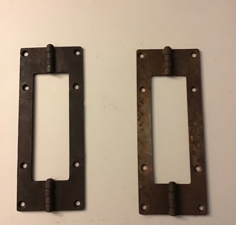

- Posts: 3948
- First Name: Larry
- Last Name: Smith

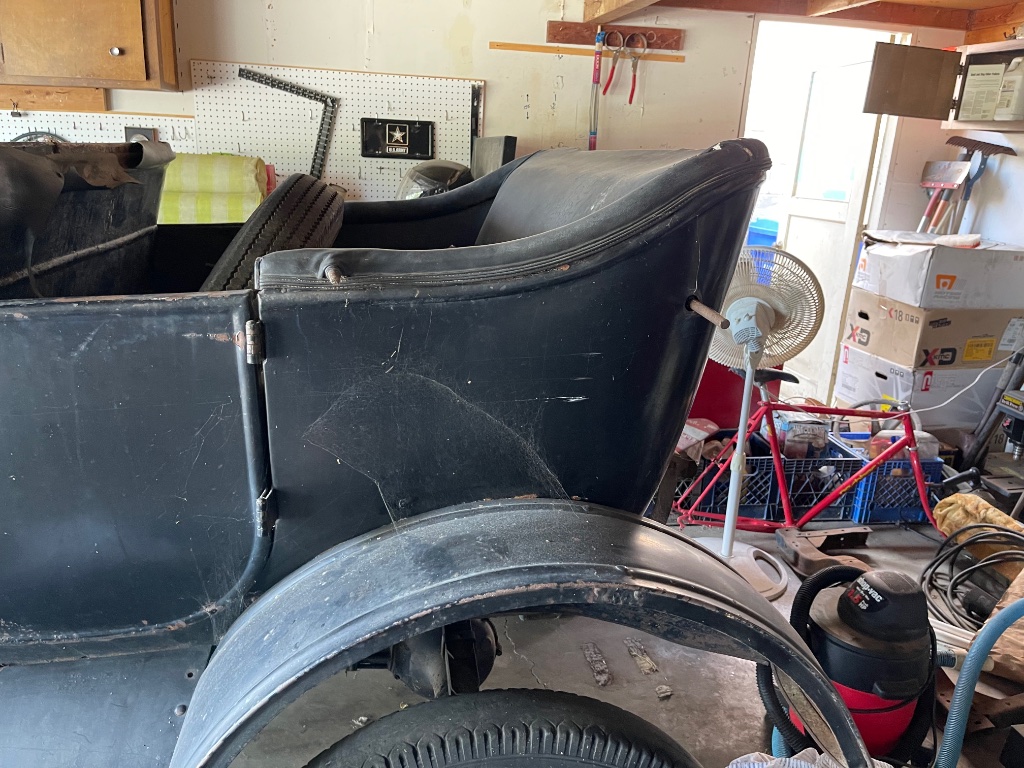

That body is most likely a 1924> Look at the door hinges.

- Posts: 4681
Yes the body appears to be a 24 going by the door hinges. Just noticed that as O Smith pointed out. The 25 hinges are a straight hinge and don’t have the offset like the earlier hinges.
They were made for the 25 cars. The earlier hinge was used from as far back as 14-16?? thru 24. I thought they were the same until I realized the difference when I restored my 21 Touring.

We’ll, it’s been 3 months but I did get some pics to verify a couple of things.
1924/25 high cowl.
1924/25 high cowl.
1924/1925 hood
Rear Door
I have never let my schooling interfere with my education.
Education consists mainly of what we have unlearned.
- Posts: 5248
Judging by your door hinges, I think you can narrow it to a 24.
Will_Vanderburg
- Posts: 948
- First Name: William
- Last Name: Vanderburg
- Location: Jackson, NJ
The door hinges are not equal length, therefore it’s a 24. 25 hinges are equal.
Will and Speedy, thanks for the updates!!

- Posts: 4681
Here is a pic of two 25 hinges. Notice the difference from the earlier hinges that were used on T’s from around 14-24?
The 25 hinges are straight and the earlier are angled. Not straight like the 25 hinge. The pic shows two 25 hinges opened up. Your car is a 24 using the hinge style as verification.
Also going by the earlier photos of a side angled view of the radiator, you have the earlier low radiator on the car and the radiator is about 3/4 “ lower than the 25 shell. That’s why the pic is showing the radiator with a downward slant using the yard stick to show it’s not level with the cowl. You can run the car with the lower radiator but the hood will not fit correctly and not be straight with the cowl and won’t fit well with the hood hold down clamps.
As others have stated different year parts were used to build up a T or for replacement parts to keep them going. Not uncommon.
