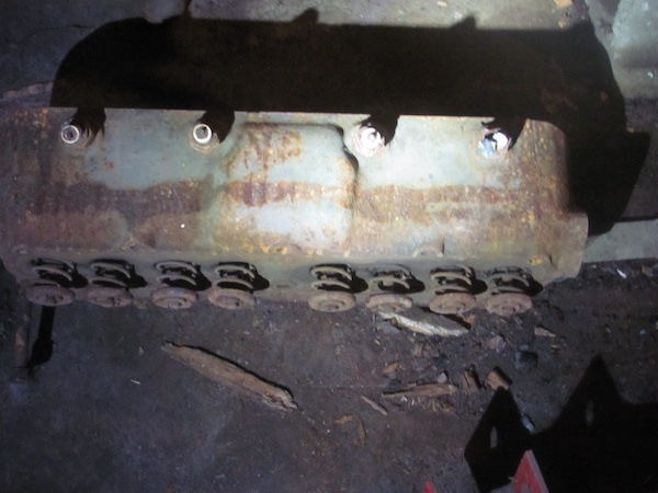

I have a rajo head I found 50 years ago. How do I tell what model? 4 or 8 valve? Have the manifold, but not tthe cover.
Posts: 5471
Re: Rajo head
Post by RajoRacer » Mon Jul 18, 2022 1:10 pm
Post a photo if you can - they have several different port configurations - 4 valve is just that - 4 valves in the head & uses the stock exhaust valves in the block - 8 valve is 8 valves in the head.

If it weighs 80+ pounds... it’s an 8 valve. Pictures obviously will help, but a simple count of ports and note what side of the head they’re on will yield a solid answer. Also measure the combustion chamber depth and count the spark plugs while yur in there

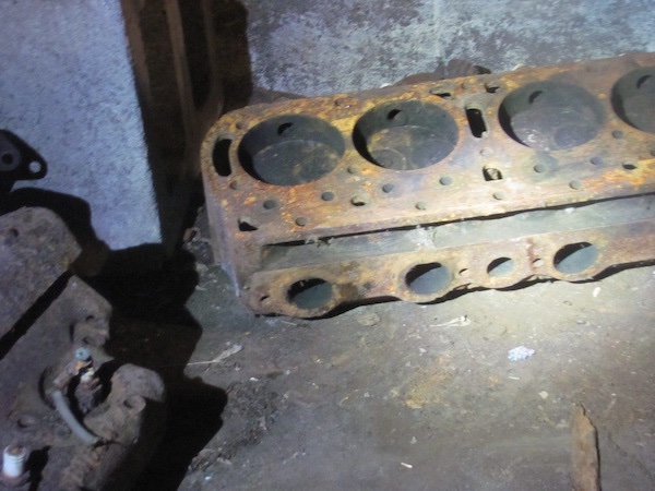

it is an 8 valve head. looks good, adoes not seem to be rusty and is in good condition. The manifold is rusty, but should clean up okay. Do not havwe the cover. What model is it?

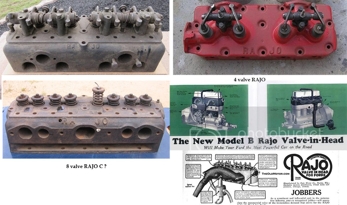

I found some photos. The top 2 show the difference between the 8 and 4 valves. The 2 at left were called Model Cs but I don't think both are. Someone will be able to tell you more.
This thread has some good info including the last post by Mark Chaffin describing different models.

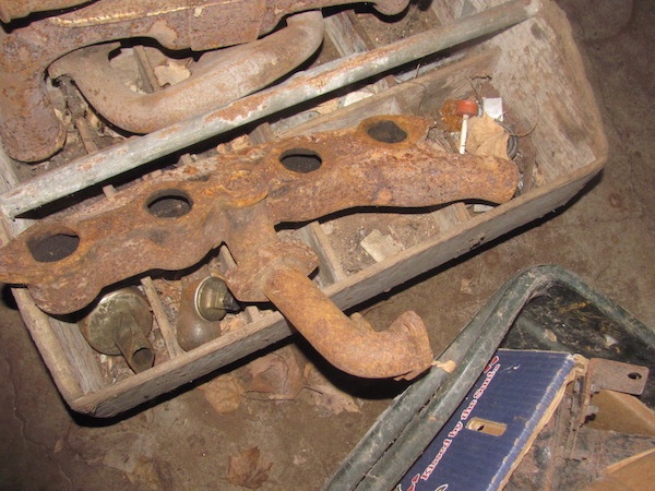

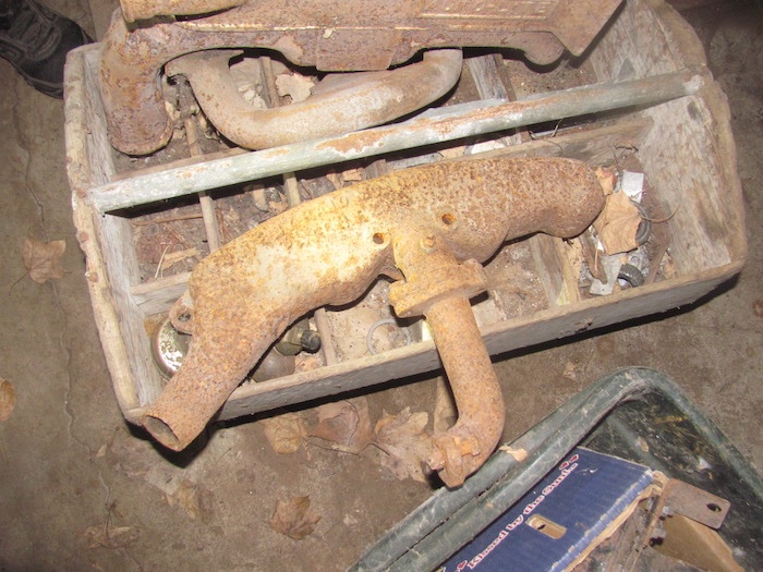

does someone have a photo of the manifold for an 8 valve head. The one I have is an all in one.

If all the ports are on the same side, it's not a B or BB.

It seems to be a model 30. I am probably wrong that the manifold is an all in one. Will check this evening.

The later Rajo Model 30 manifold is all in one, four exhaust and one intake port on the right side. The above Model 30 picture from early Rajo advertising shows a early type head with a different manifold .

It is a model 30. The manifold is similar to the illustrated one, but the intake manifold (Atached) is plain. I will post some photos.

Here are some photos. The head is in better condition that the photos show. the chambers are clean, the manifold is rusty, bt should clean up. I have the rest of the parts in a box (no rust on them). I have had this head for 60 years. I amy sell it, but I want to determine value. If I did sell i t, I would use the $$ for a new set of wheels for my 1910 touring. I have the correct hubs.

Nice that the intake manifold extension is still on the manifold.. Most of those got lost along the way.
