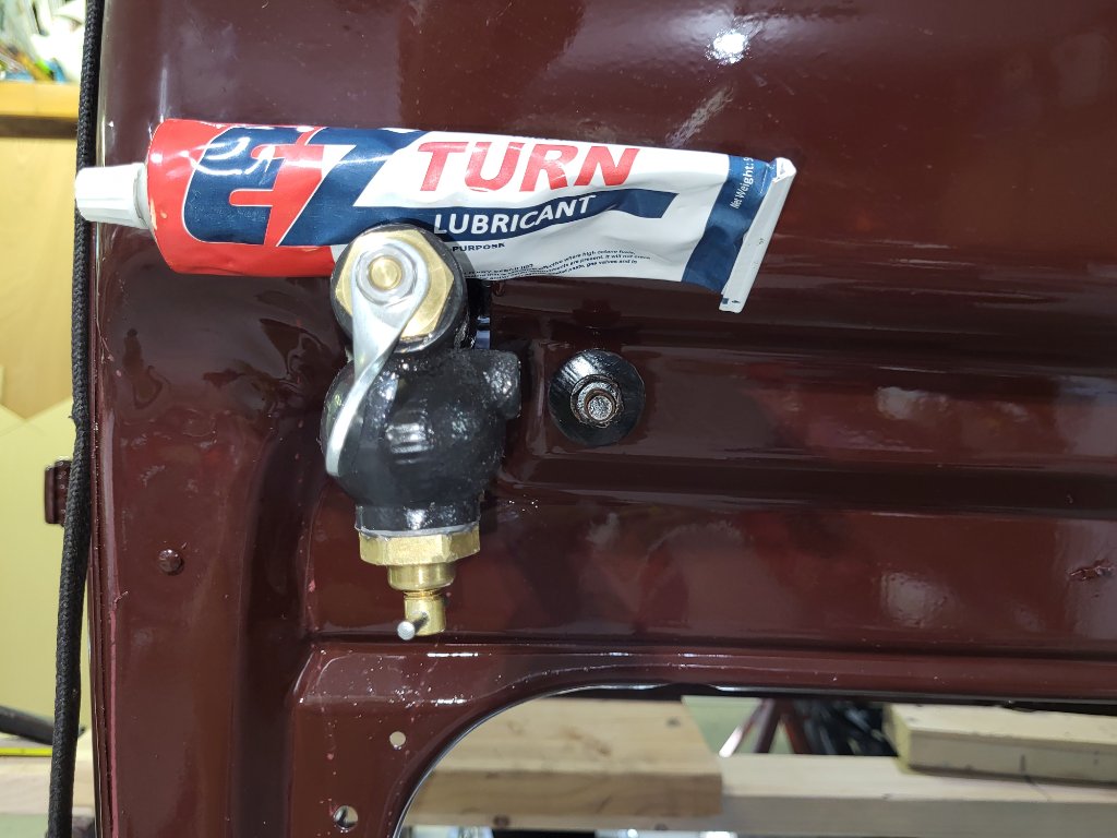

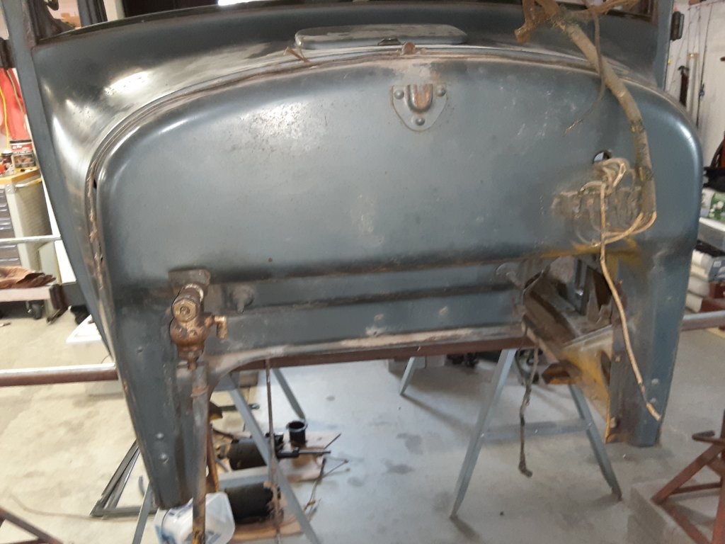

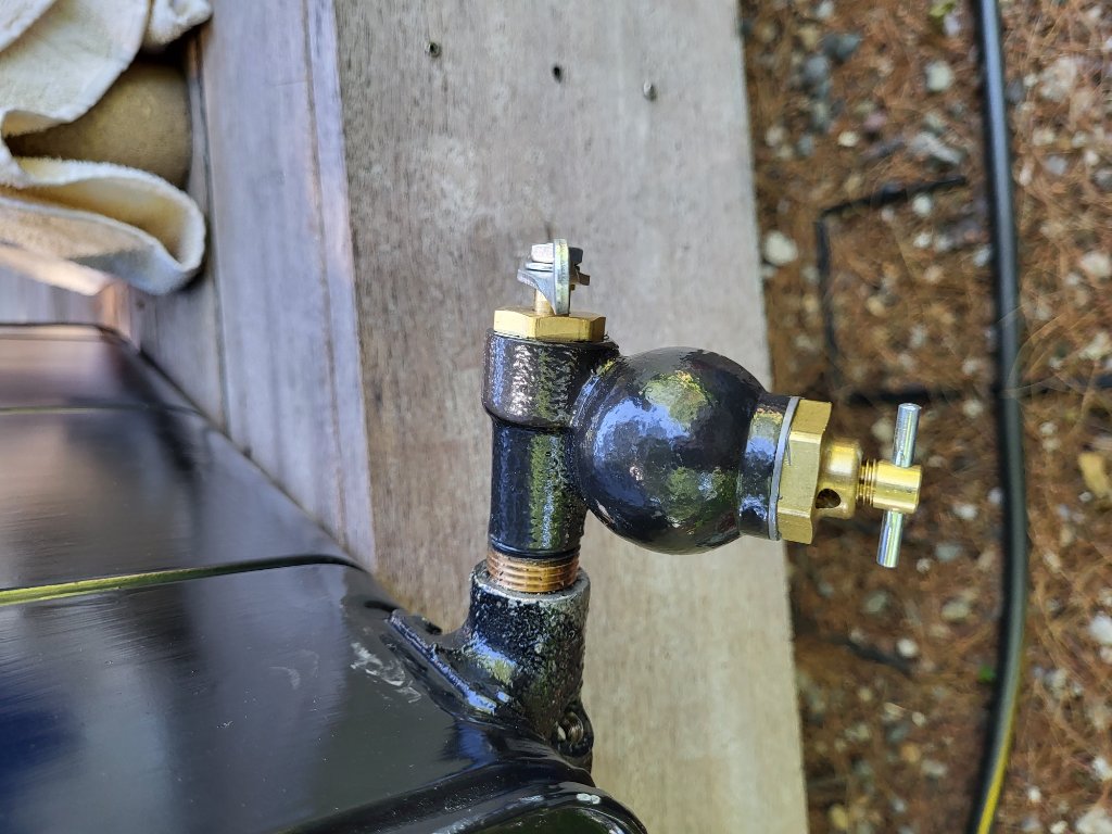

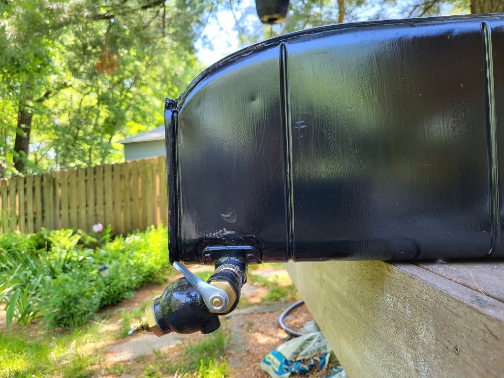

The two photos show a new sediment bowl I am have installed on the gas tank for my 1927 coupe. I hand tightened it to the position shown. I filled the tank with gas to check for leaks, and left it set for a couple of days. No tank leaks, but there is seepage at the bowl threads.
As can be seen, the bowl is not in a vertical position. How do you get a sediment bowl in vertical position and still have it tight enough so it does not leak at the threads?
Sorry, the last photo had to be rotated for it to be accepted!

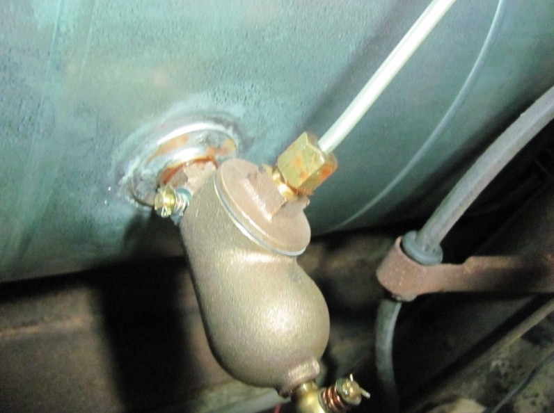

Hello.
I have the tank under the seat, but the principle will be the same. I had to install a new sediment bowl because the old one was total crap. It had a cast-iron bulb with brass parts screwed in, but some super smart guy drilled it up from tank side (through the petcock, too) and soldered in a piece of copper pipe... So the tank had no shut-off valve anymore, this I wanted to be solved...
I bought this sealing product years ago. Product "Ulith 240"/"TWINEFLON". Plumbers swear on it.
It is a thin thread of Teflon but not as smeary as usual Teflon tape. It is absolutely resistant against gases, oil, and most chemicals. Temperature range from -200°C - +240°C (should be sufficient
). I am pretty sure you find something similar in your local DIY market.
https://www.babo-team.de/Verbrauchsmitt ... -175m.html
I decently roughed the thread on outside of the bulb by dragging a file edge across the thread in 90deg, then I wound up this sealing thread and turned in the bulb.
The connection is 100% proof even after 1 year, I am pretty sure this will last forever.
If you want to screw the bowl deeper into the tank (to make the thread vanish), I would not recommend that. Simply turn in the bowl without any sealant until it is in place and doesn't go further, then measure the gap width. Find a brass muffle in a DIY market and cut a ring in previously measured width from it. You can also take a piece of pipe or a flat G1/2" nut, but the muffle will be easier to get and has a round outer shape.
If this ring doesn't go all way up on bulb thread, use a file and increase inner diameter until it does. There is no need to make it proof!
Finally use the sealing tape of above and put things together. The Teflon will fill the joint (so it will sit now strong) and you will get a perfect look and 100% proof joint.

Here is some more information on the situation with the sediment bowl.
I just removed the bowl, cleaned the threads in the tank with a dentist type of pick and lubricated the threads. I reinstalled the bowl by hand, and it reached the same previous position. There are eight threads on the bowl. Three turns gets it to that position, and 2 3/4 turns gets it to vertical. I think it needs to penetrate the tank more than that.
I am pretty sure tightening it by a wrench would not get it to a vertical position.

I tried to tighten the bowl with a wrench. It moved to the position shown here. It turned very hard. There is no way that I will get it to the vertical position with just using a wrench.
I believe I should try using a "die' on the bowl threads, being careful not to overdue the amount I turn the die. Scott was clear that I should not use a "tap" on the tank threads.
I appreciate the comments and suggestions I have received. I welcome any additional ones.

You still have more than 1/2 a turn on a very coarse thread, so the thread needs chasing. If that is a new reproduction outlet, it most certainly needs some work on the thread. Your local old time plumber is your new friend. He should have the die necessary to do the job. Less is better. Tell him you need 1/2 a turn more, and trial fit. You can always go back for a bit more.
Keep in mind that the receiver in the tank is cast iron, it is riveted in place, and it is sealed with solder. Too much moxie on any wrench may compromise the fitting. Fitting is the word here, not forcing.

Re: Installation of New Sediment Bowl
A person holds the tank down.
Bruce. There is something seriously wrong if you can’t turn the sediment bulb any more than 1/4 of a turn from hand tight! It should easily turn 3/4 of a turn from hand tight. In your first picture, the exposed threads look new. Did you recut the threads? If so, did you use the correct TPI (threads per inch) tapered pipe tap? All I can think is that you, or someone used the incorrect tpi tap. Scott, what do you think the problem is?
I would take both the tank and the sediment bulb to a plumber and explain the problem then tell him “fix it”. I think it is probably beyond your experience and a good plumber should have the proper tapered pipe fittings with which to do the job. Jim Patrick
Jim, I have done nothing to the threads on the bowl or tank, except using a dentist type of pick to clean the threads in the tank. Those threads look good.
I want to clarify "hand tight". It is not just turning the bowl to where some slight resistance was felt and then stopped. I used gloves and really turned the bowl hard.
NPT = National Pipe Tapered
Carefully chase the threads in the tank with a tap and be done with it! Running the tap by hand (no tap handle/wrench) will likely do it. Take the tank to a plumbing shop if you don't have the 1/2 NPT tap. Any shop that installs black iron gas pipe will have this tap. Don't bugger up the new thread on the sediment fitting, good luck jb
I took the sediment bulb to a machine shop. The machinist used a 1/2 npt die on the threads, not much but it worked. I used lubricant and got it to the vertical position with a wrench.
Good job! I am still confused as to why you could not get your sediment bowl in the proper position. I am posting a picture of your firewall before you removed the sediment bowl back in April, 2021 showing it in the proper downward position. That is why I was so adamant that you should be able to tighten it to the proper position. It would be nice to know why you couldn’t. Do you think you might have cross threaded it! That is a possibility. A note of caution. When threading, go slow, making sure the fitting is going on straight. If you feel it is crooked and tightening far too soon, back it off, straighten it an try again. Jim Patrick
jiminbartow wrote: ↑Sat Jul 30, 2022 10:57 amGood job! I am still confused as to why you could not get your sediment bowl in the proper position. It would be nice to know why you couldn’t. Do you think you might have cross threaded it! Jim Patrick
Jim
The reason is that was the original Ford bulb, he used a Reproduction new bulb, today's NPT is just enough different, or else the repop thread lead began at a different point than the Ford part, NOS Ford parts work best
BTY, had similar issue with the under tank new repop bulbs into a repo new tank, the thread won't quite align, but isn't too big an issue with the under seat tank, and you can curve the fuel line to make up the difference of position of that bulb. Permatex #2 to the rescue.
At the rate the Ford shops were running to keep up with production the folks probably had it down just right when machining parts. Probably having the bulbs fixed in the lathe or threading machine every time in the same position and so on. When you were doing boxes full of bulbs you got the knack of it and knowing the exact position where to jig the parts up every time.
Just guessing !
Just guessing !
Jim, Dan has the reason it would not go vertical.
I had a new petcock for my new radiator that would not screw on more than a few threads. I took the radiator to the machinist, and he used a tap on the radiator threads to get the petcock on.
Question.... don't you put the tank in first and then install the sediment bulb on a '26-'27 cowl tank?
Pic shows installed out of car.
Professor ... Maybe he was anxious with that new part to see if it fit his tank ?
Yes Dan. On the 1926-‘27 cowl tank, the sediment bulb can only be screwed on after the tank has been installed. The tank cannot be installed with the sediment bulb installed. Jim Patrick
