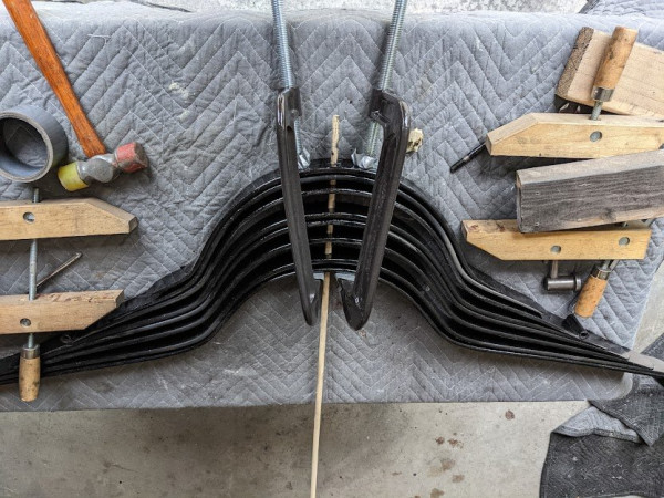

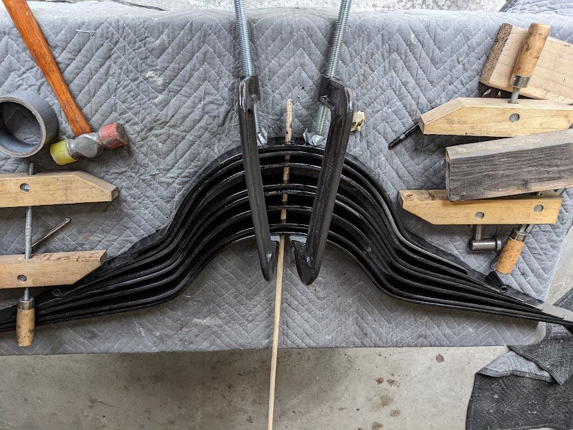

Restoring or working on a Model T is hard work, but generally pretty easy. Some projects are easier than others though. This is the second T that I have done a frame up restoration on, and it was time to reassemble the painted leaf springs. The front springs are really easy to reassemble, and can be done with a couple of wood parallel clamps and a large Phillips screwdriver in the bolt hole to keep things aligned (first picture).

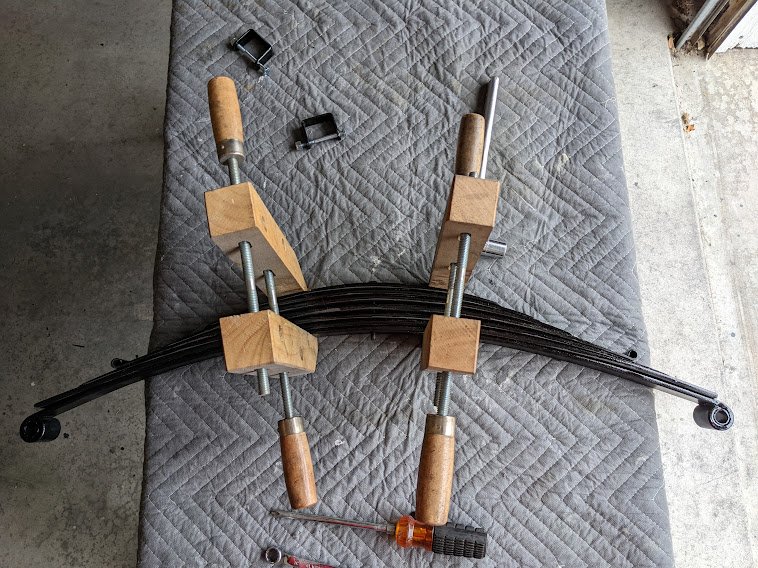

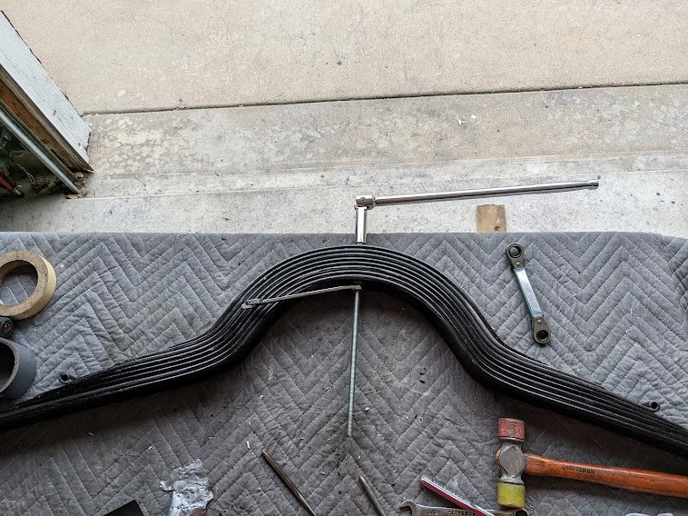

I quickly had that one assembled yesterday and moved on to the rear leaf spring. I didn't recall having any problems assembling the rear spring on the first T restoration, so I approached assembling it based on how I remembered doing it the last time (second picture). Well that really didn't work this time. The leafs kept shifting as I compressed them and I could not keep the center holes lined up enough that I could get the center bolt through. I tried various ways of doing it and after a couple of hours had enough for the day. During that process I realized that I had to get the various spring pieces in the right orientation because some appeared to have a bit of a set on one side relative to the other. That was contributing to the shifting center holes.
I finally searched the MTFCA forum site and found a tip buried in a general thread about rear springs. That was to use a 12" piece of 3/8" all thread and run it down, clamp it TIGHT with C clamps, and then swap out the all thread with the bolt. I wish I had seen that thread earlier. A trip to the hardware store this morning for the needed pieces and the rear spring went together. It took a couple of assemble/disassemble/reassemble steps as I saw which pieces needed to be flipped over to better nest between the adjacent leafs. After that the center bolt slid through all the holes easily and soon had it tightened up.
Anyway, if a rear leaf spring assembly job is in your future, I would suggest using this approach to compress the rear spring. The same approach could be used on the front spring assembly, but it is pretty easy to compress that two wood clamps work fine. I found on my front spring that I had to flip one of the leafs to get them to nest better. You can see that the second to largest leaf is not fully riding on the bottom leaf at the left side of the spring in the front spring assembly picture below. That is the one that I flipped around and then they all nested like they are supposed to when it was compressed all the way.

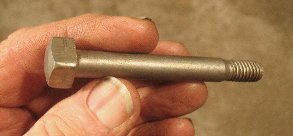

That has been the recognized way of doing it for years and is how I did mine in 2010. After the spring leafs, lubricated with slip paint, were compressed and tightened with a long piece of all thread, I clamped the leafs tightly together with a wood clamp, removed the all thread and replaced it with a tempered rear spring square headed bolt, made for that purpose from Snyder’s or Lang’s. Do not leave the mild all thread in place. I don’t believe that grade 2 all thread would hold up for long to the stresses of holding the powerful flexing leafs together. Jim Patrick
I totally agree. It was there until I got my two 8" clamps on and then removed and replaced with the tall squared headed bolt from Langs.

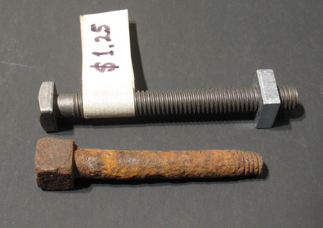

I believe I've always used the all-thread method. No problem.
The bottom bolt here is an original. Note the high head Larry mentioned.
The top bolt is the one Lang's was selling at the time. I didn't use it.
I believe I got this NOS bolt from Bob Bergstadt.

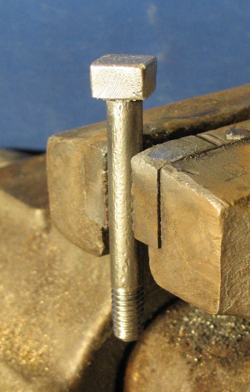

On one project I used a regular bolt and built up the head.
Not perfect, but close enough for me.

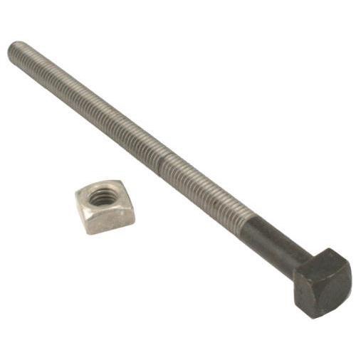

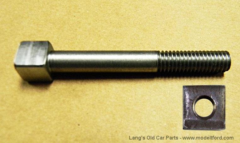

Lang's sells the thick headed rear spring bolt and spring for $8.25. I don't know how someone can make and sell those for a profit, but I'm glad that they do! The thicker head does make it easier to get the spring properly located in the chassis channel.
If they were made by RV, I hope someone else will continue to do so
https://www.modeltford.com/item/3838OR.aspx

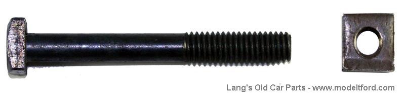

Here is an extra long Rear spring bolt from Snyder’s. It is long enough to pull the leafs together like all-thread and once tightened, can be cut off at the nut and bradded. Jim Patrick

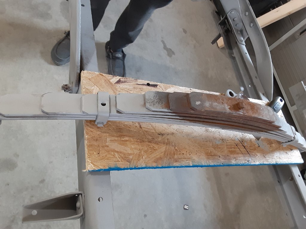

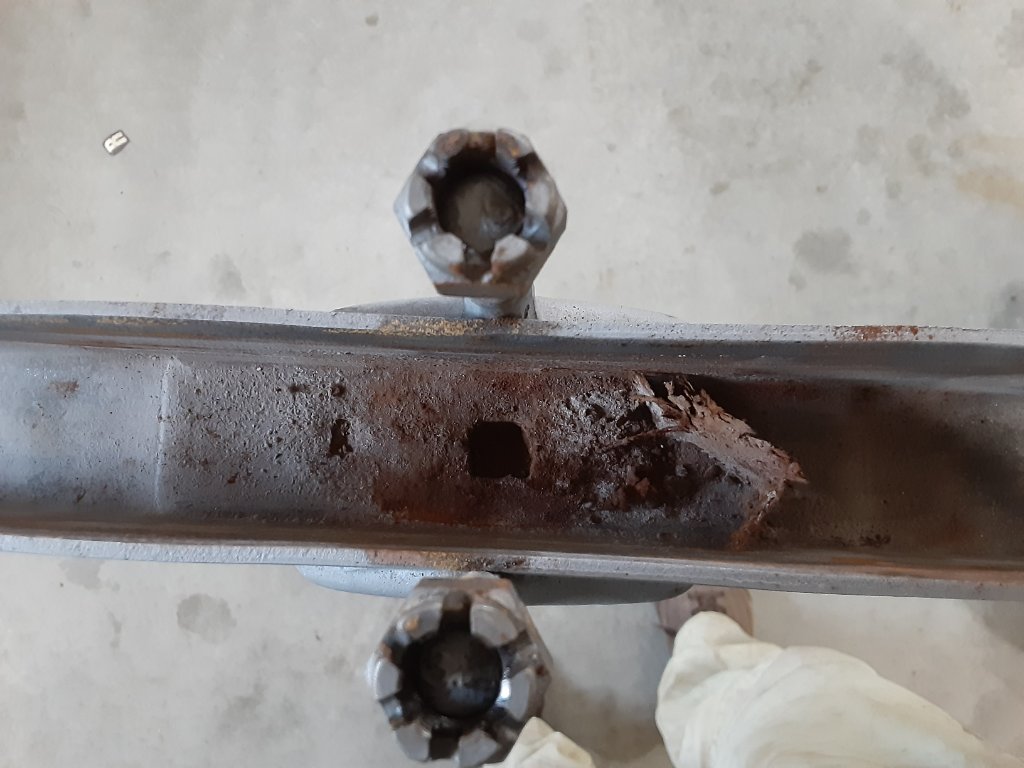

My 1927 coupe was built in January 1927. There was a pad between the front spring and the cross member as shown in the attached photos.
I don't have a photo of a pad between the rear spring and the cross member, and I don't remember if there was one there or not.
