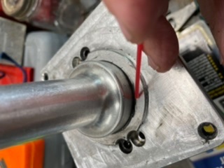

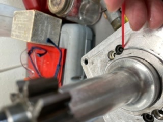

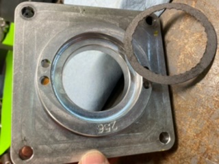

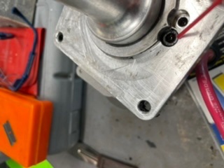

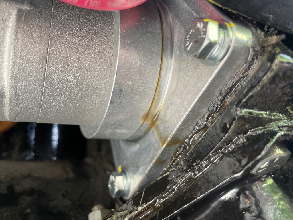

I purchased a WOSP starter from Snyders, an oil leak at starter was noticed. Contacted Joe at Snyders.. a fresh starter at my door in 48 hrs. Replacement starter leaked also, contacted Joe, he in turn contacted WOSP. They provided info how to index the case on the 3 surfaces, remove the 2 Allen head bolts and remove the aluminum block on body of the starter. After multiple attempts with a gasket and RTV, the correction is just RTV on inside of aluminum flange block, also RTV under the heads of the Allen bolts and a light bead of RTV on the 90 deg joint at block and starter nose. This procedure sealed the oil side of starter with success.
