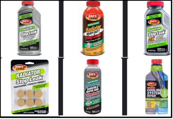

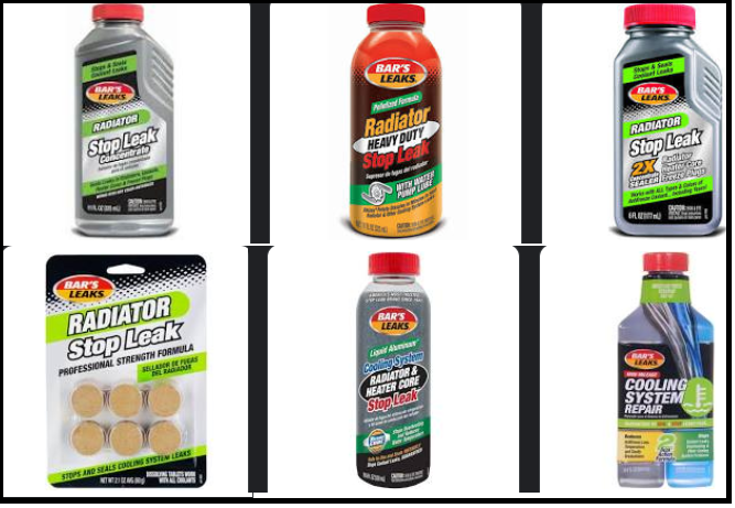

Can we start from the beginning. If it ever ran hot before you used Bar's why did you feel you needed to use it? A leak usually leads to running hot. May help others to know which Sop Leak product of Bar's you used and how much of it. Lots of stories about the pellets. Since you reach a point of: Why not use Irontite. If it doesn't work then your still looking at a new purchaseRGould1910 wrote: ↑Sun Jul 31, 2022 8:06 pmRadiator is a Brass Works. Never ran hot before Bars Leaks. Unless I can think of something else, I'll run clear water for a while. If it still runs hot, I'll try the flush and cross my fingers. If the flush doesn't work, I'll take off the radiator and check for junk. I don't think that's the problem, though. Thanks for the comments. It helps to get feedback.

The stop leak can plug your tubes because of the lack of pressurization flow. It simply settles out of suspension and clogs in the areas of least resistance. It clogs the tubes in heater cores in older cars the same way. You will have to have the radiator boiled and flushed out.

Adding to Ed's --- The following is a general description of how stop leak products work and not any specific Bar's or other brand. AND we don't know what Bar's product was used
How a stop leak works https://www.autozone.com/diy/performanc ... -leak-work
Each type of radiator stop leak works in a slightly different way. While the end result is similar, filler particles, ceramic fibers, and sodium silicate all attempt to seal by hardening and solidifying where the leak is occurring. Another area that Stop Leak can help is with your car’s Heater Core. A Heater Core is basically a small radiator inside the cabin of the car, that radiates engine heat for heat in the winter. Heater Cores can suffer leaks similar to a radiator, and are much, much more labor intensive to repair.
Fillers, whether ceramic, metallic, or organic, circulate through your radiator and are forced into the gap in your radiator piping when the system is under pressure. These particles bind and create a temporary seal. Once you flush your coolant or even top off your coolant, you may flush out enough filler to remove the seal and form another pinhole leak.
Instead, ceramic fibers use what’s called a micro-sphere nano-technology approach to create a more fibrous patch in your radiator. Once heated, these fibers cure and create a semi-permanent seal. It may not be as durable as a brand-new radiator, but it can withstand flushing your coolant without breaking the seal.
Finally, sodium silicate, also known as liquid glass, melts at around 212 to 221 degrees Fahrenheit. As the liquid circulates your cooling system, it reaches a leak in a hot portion of your engine. Once it reaches the correct temperature, it melts to form hard seal. Sodium silicate requires temperatures up to 1,490 degrees Fahrenheit to melt again, so it creates an extremely strong seal.
Find out how to use radiator stop leak and when you can effectively use it. Some leaks can’t be effectively sealed with radiator stop leak. In these situations, your radiator needs to be repaired or replaced in order to form a proper seal.
