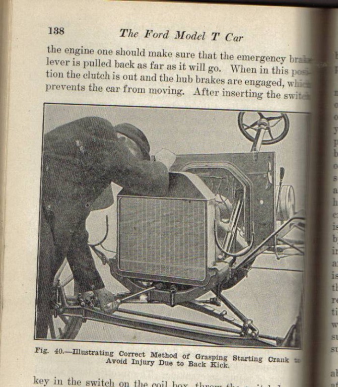

Look close at the hand crank instruction picture and you can see the guy has his thumb behind the crank handle and NOT wrapped around it whichever hand you use!
Accidents like this bring us back to reality that hand cranking a T is dangerous and to not take it for granted.
And always retard the spark control!
Yes I know we all know this BUT never take a T for granted. Ford knew what he was doing when he introduced starters in 1919.
Wishing you a speedy recovery.

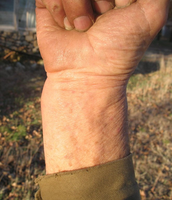

The majority of "crank start-only cars" often are "spun".
Not mine. I say if it won't start by simply pulling up on the crank, fix it. Any Model T should crank start without "spinning".
https://dauntlessgeezer.com/DG101.html
I'm gung ho on safe starting since I permanently damaged myself with stupid cranking. I can still use the hand, but it's always numb and weak. I did this with a tractor, but I doubt that it would hurt any less with a Model T. And boy, did it hurt! I don't recommend it.
