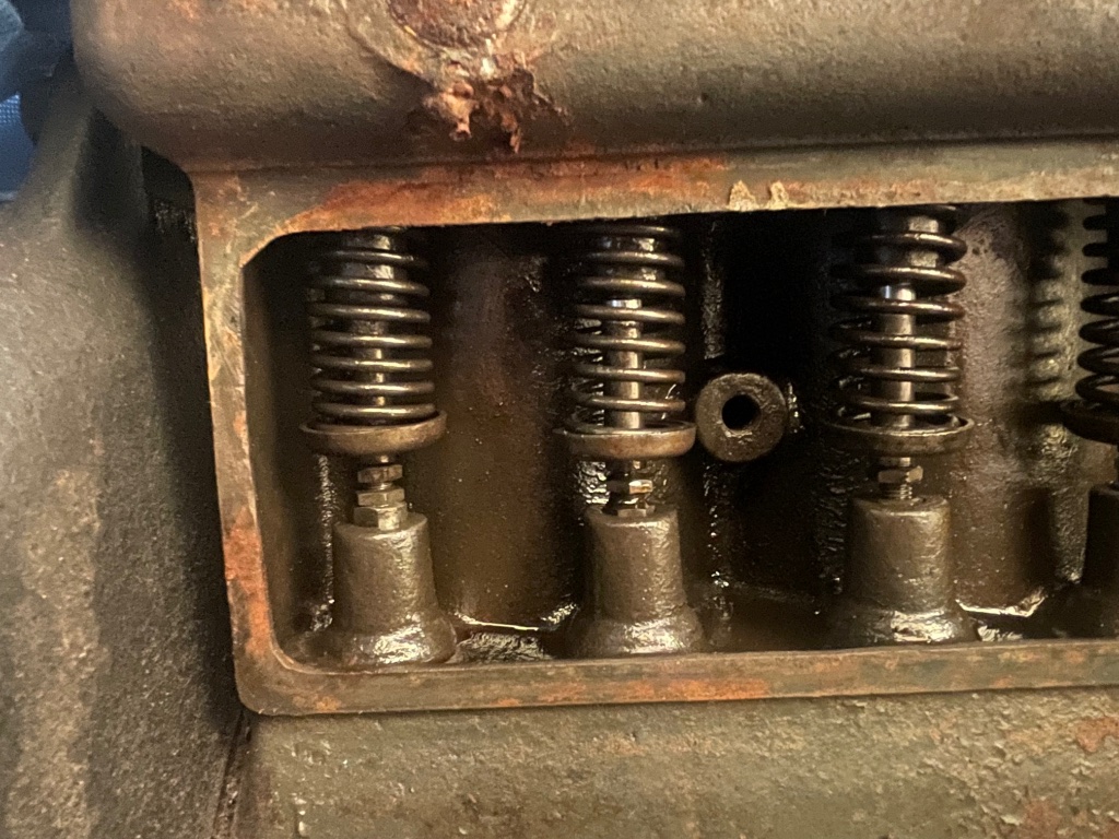

Hello All,
New to the world of Model T and loving it so far. I have a 1926 Model T Touring. I was working on the engine since it has sat for a while and wanted to check on the status of everything. I took the head cover off and there was a lot of carbon? buildup. I started cleaning and noticed one of the valves doesn't move when I turn the crankshaft. Any suggestions on how to remedy it? I have attached a picture, it's the one all the way to the left. I have a short video but not sure how to share, if at all possible.
Thanks in advance for the suggestions!
Dan

I had taken the side cover off and looked but didn't see anything abnormal. When I went back to look just now with the pistons at a different position I saw the problem.

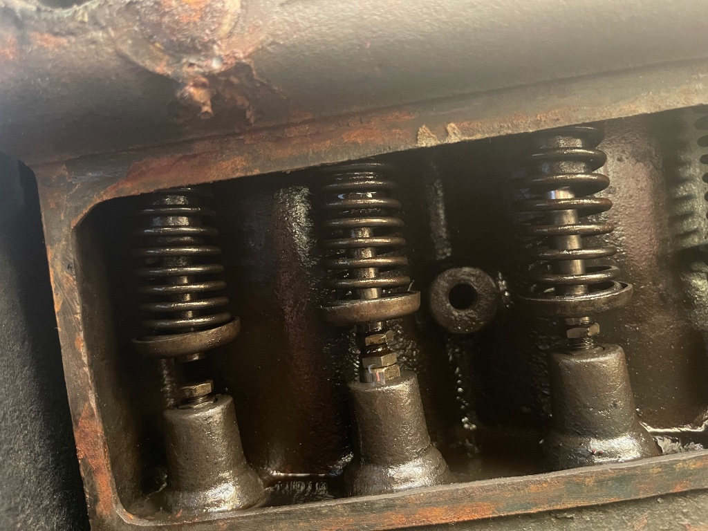

Another photo where there is no gap.

Yes stuck valve. Use some penetrating oil(kroil) Try rotating the head to loosen. Not with a channel lock. Depending on the stuck, a gentle tap (with the lifter down) You dont want to damage the valve. You can put a spacer in the gap(1/8' piece of metal) with the lifter down to move the valve up when cranking the motor around. The key is to get it broken loose to where you can remove the valve & clean it & the guide.

The stuck valve is an easy fix. Squirt some WD-40, or some kind of penetrant down the valve stem. You can wait a while or gently push or tap with a rubber faced hammer to push it down. It doesn’t look like it’s stuck badly going by the condition of the rest of the valve train.
Turn the crank over and do it several times if necessary to free it up.
BUT look closely at the freeze plug right above it. It looks like it’s been slowly leaking going by the rust stains on the freeze plug and on the valve chamber. If that plug is rusted it’s probably almost through or getting close to it.
Now would be a good time to replace it and the other two. The vendors sell them and there aren’t hard to replace.
Also since you have the head off clean out the water passages in the block and in the head.
Use a long piece of wire or long flexible slim cable to go back and forth in the passages. Then use air to blow out the rust scale and dirt.

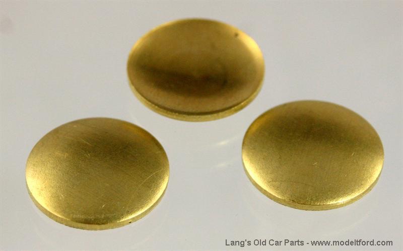

Everything I would have suggested has already been posted however, not to change the subject, it looks as if your freezer plugs are getting ready to rust through. From their appearance it looks like there is a rustsicle forming below the freezer plug. You should plan to replace them. The ones pictured are brass, which will not rust. Jim Patrick

Thanks Jim, I'll order some! Yeah, there is rust in quite a few places.jiminbartow wrote: ↑Mon Aug 01, 2022 10:27 pmEverything I would have suggested has already been posted however, not to change the subject, it looks as if your freezer plugs are getting ready to rust through. From their appearance it looks like there is a rustsicle forming below the freezer plug. You should plan to replace them. The ones pictured are brass, which will not rust. Jim Patrick

welcome to the hobby. Your issue isn't particularly unusual, and the good news is your valves were replaced at one point, and they fit well enough to stick!
proceed prudently and slowly. Don't be tempted to whack things with a big hammer. Time and penetrating oil is your friend. From pictures, it appears that you have the most common type of sticking; that being condensation or leak into the combustion chamber, with the lower part of the stem being clean. I have found that oiling the stem through the chamber door, inserting a bit of aluminum bar around 3/32" thick (or stack a couple pennies on top of the lifter) and rotating the engine will OVER-lift the valve, bringing more CLEAN oiled stem up into the guide. Once broken free, the spring is now doing more work with/for you and you can gently tap the valve down at least to where it was to start with, repeating the over-lift multiple times until the valve can be coaxed home and then generously oiled and exercised from there. When over-lifting, have a friend watch to see that you do not coil-bind the spring as that will lock up the engine and you could hurt things if that were to happen.
