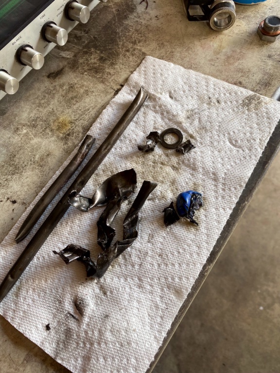

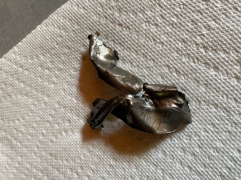

Had a car making noise and thought I might have a clutch issue but I found this in my magneto. I thought it might be a dipper from the end of a connecting rod but it is the funnel end of the oil tube which runs to the front bearing. I have an out side oil line on this engine and everything else inside looks good. Can I get by without tearing this engine apart at this time?

There are likely to be witness marks on other components as that was chewed up, but if everything works as it should and there are no funny noises, I'd just drive it and keep an ear out. I would be interested to know if the inside oil line is a reproduction. The funnels on those are not always well fixed to the tube, and when fitting/aligning the tube when mounting it, the piddly weld can break. I learned early on to add a bronze weld to that joint. Your outside oil line should suffice until you have to do a tear-down.

Not the first T that it happened to. My 1919 Roadster had some slight internal noise for a short time and then suddenly died. The funnel end came off the internal oil line and tore some insulation on the mag ring and did damage to it but it was enough to kill the car. I could hear it make a scratching sound as I pulled on the crank.
Had to tare it down and install another oil line and a rewound mag ring. Of course it took a major a tare down to fix it as us T folks know if you have to replace the oil line. I don’t recall if there was anything else that was loose. It happend about 20+ years ago.

Re: Transmission noise
John, I did that, just reassembling now. There was a lot of debris and I’m sure the magneto is done. The car runs on battery powered by an alternator with an old Bosch distributor. It is my only car that runs this way, my older ones all run how Henry designed them. This is a nice running modified car which kind of surprised me. Allen’s guestion were right on. . I cut the tube inside the engine and removed it, but you can see how it got mangled.
