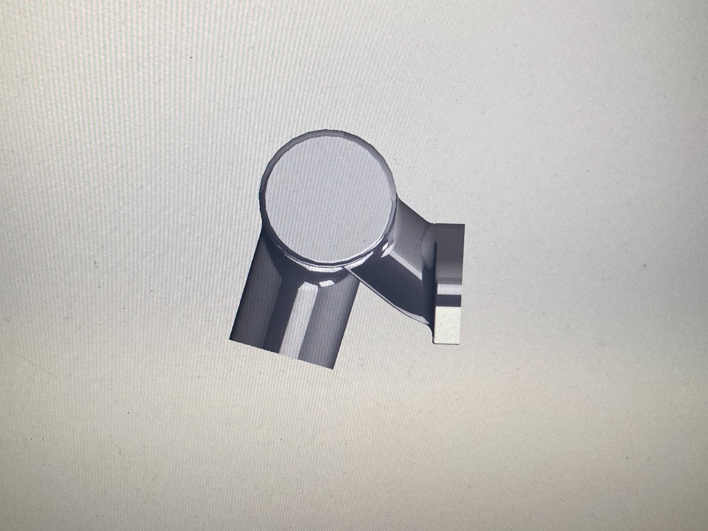

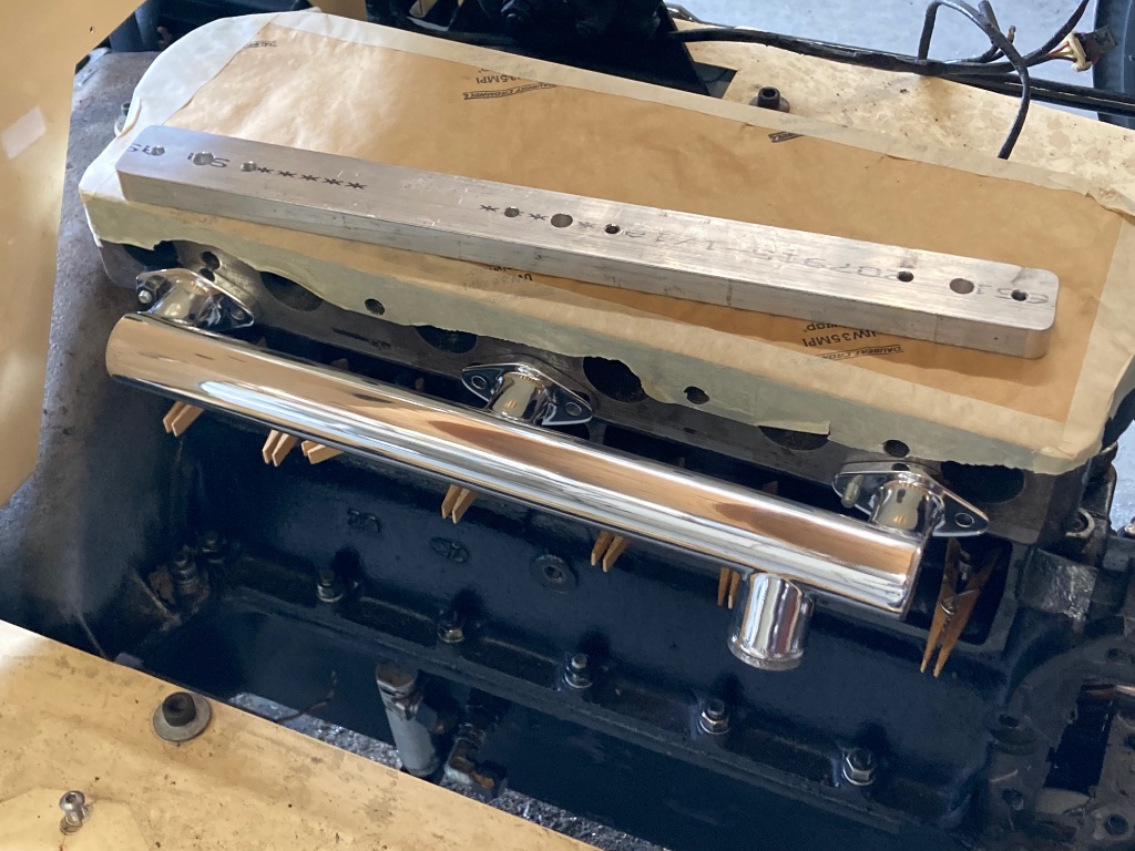

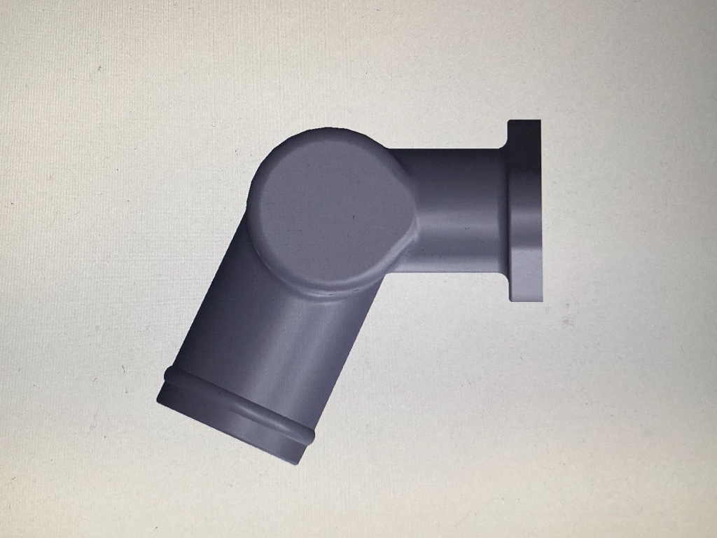

I have been pondering for years a way to circulate extra water to cool the rear cylinders in my speedster engine. I always imagined something similar to a Fronty water manifold fed by a water hose tapped off of the standard water inlet casting. The more I think about it... the more I consider making an authentic Fronty water manifold to do the job.
This is the design I have roughed in, but would like a few extra pics and dimensions from a few originals before I decide to do anything with it. I would prefer to have this cast in aluminum via 3D printed sand rather than make a pattern.
Many of these water manifolds are straight over the top of the mounting holes, but I saw one on the Speedway website that has a kick up that would provide additional mag and water pump clearance, allow bolts to be installed, and also not obstruct the valve cover. I chose to start with this version as it seemed to make more sense.
Either style, I would like flange dimensions, tube diameters, and inlet tube angle dimensions if possible...

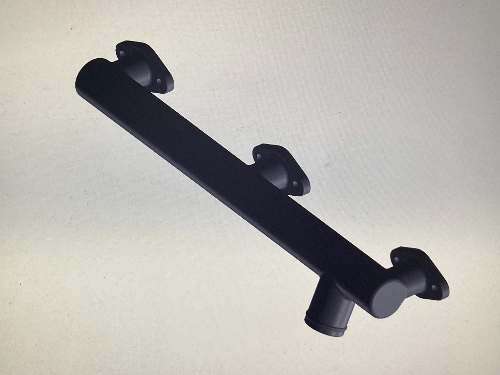

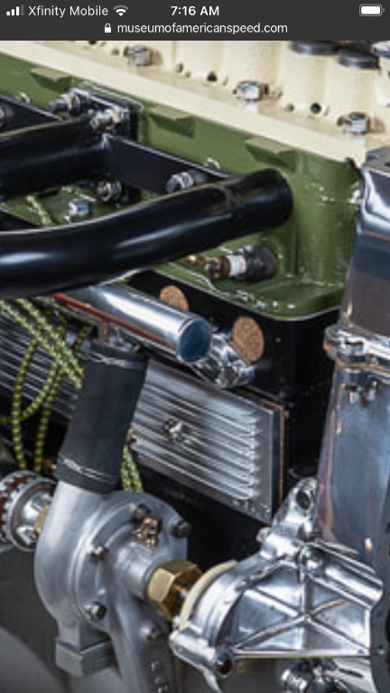

After loosing track of which engine on the Speedway website that had the offset water manifold, I finally found it again...
Dan McEachern
- Posts: 1509
- First Name: DAN
- Last Name: MCEACHERN
- Location: ALAMEDA,CA,USA
Re: Fronty water manifold
Kevin- I'll get one to you. Dan

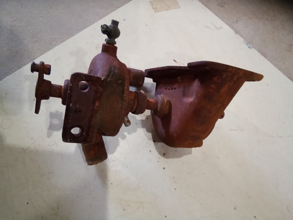

Kevin:
i have looked into using an early Dodge Brothers water pump on an overhead project ... they are cast iron with an angle bracket that makes mounting easy ...they are shaft driven , with a thru shaft for additional drives ( distributor drive in the case of my Dodge Brothers ) ...sorry i don't have a picture handy ...always an optimist Gene French

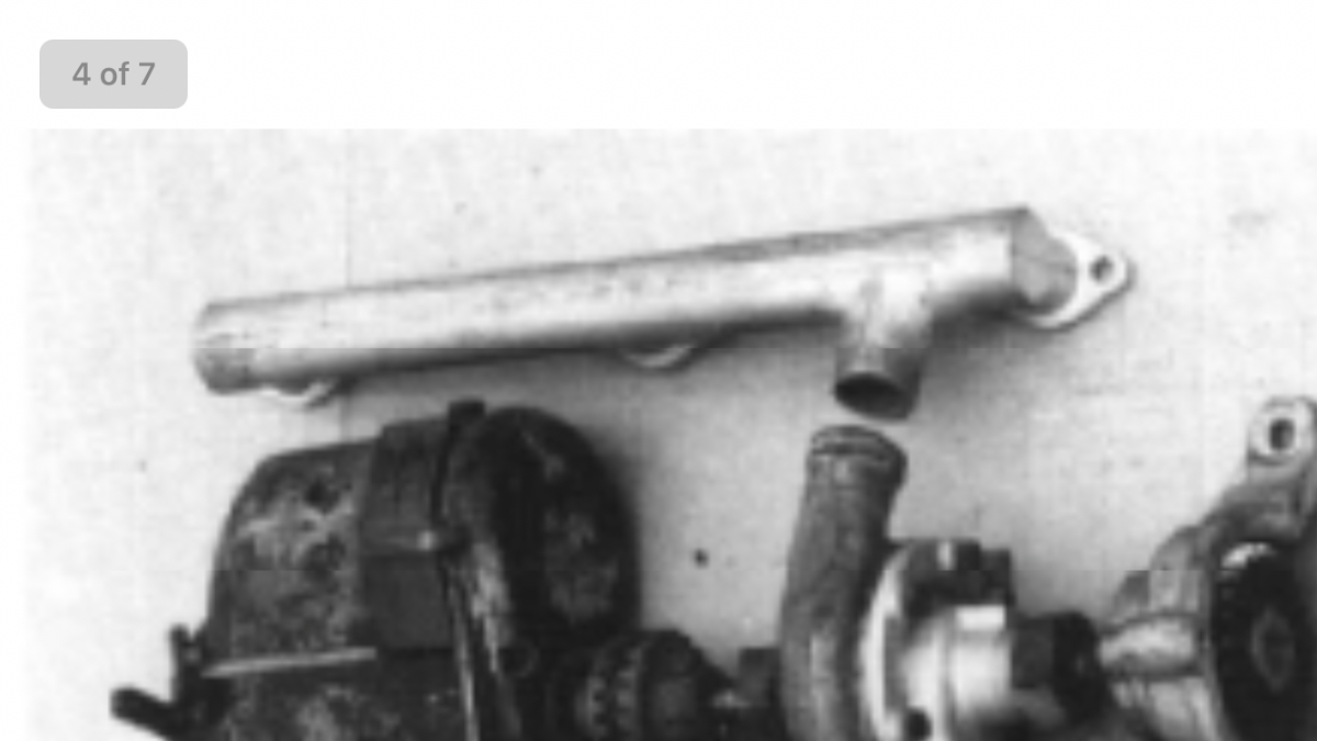

Similar in design as yours Kevin. Dick McKee years back had one that was like a block off plate but had the water porting like yours and the outlet like yours going to the water pump. Wish I had a picture, a very good design.
Hank
Hank

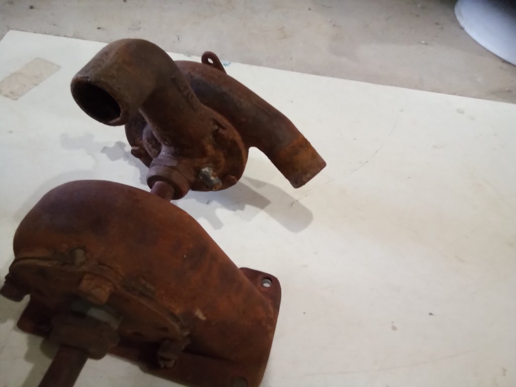

Kevin :
was digging around thru my parts and found this Dodge Brothers water pump ... this is the style i am looking at to use on the Mcmillon head i purchased last year ... a simple pump that rotates clockwise as viewed from the front ... the shaft is 5/8" diameter and driven at crankshaft speed for the DB engine ... the mount is 2 bolt thru the angle plate cast in pump base ... these work well on the DB engines ... i have had 7 DB cars and all ran very well and never had problems with running hot even in our sometime 3 digit temps. ... the impeller is cast bronze , the pump body is thick enough to re-tap the bolt holes for the inlet to position as needed ... hope this helps ...always an optimist ...Gene French

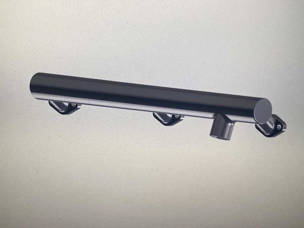

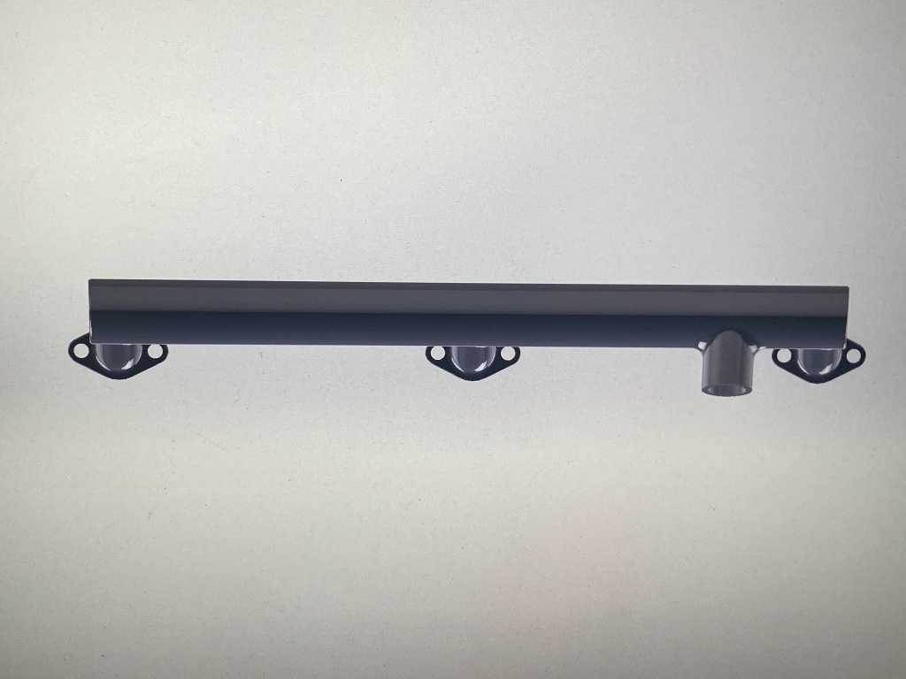

Thanks to all that contributed pictures and details of the many variations of Fronty (or similar) water manifolds. And a BIG THANKS to Dan, who sent over an original!
It seems that no 2 are the same! If you look close enough, the main differences are in the various fillet radii, and a few have rotated mounting flanges on the outer ports, and the 1 at Speedway with the elevated manifold.
After many revisions, I have opted to go with the typical water manifold design. The main concern was trapping an air pocket in the offset manifold, and needing to put a bleed port in the top. Other concerns were lining up with a Fronty pump, should anyone ever try to use one for the designed application. I have had several folks express interest, and so have requested a quote for a small quantity of castings. These will be cast via 3D printed sand molds, and so the castings will have excellent accuracy. I will finish machine the castings, and supply dimensions for drilling the blocks for mounting studs. I may even have some gaskets cut if I can pull in a favor...

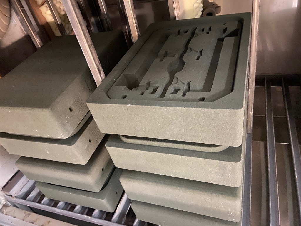

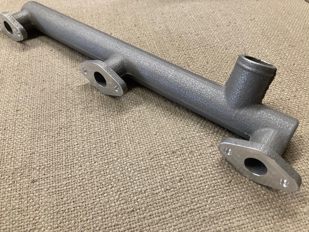

The sand is being printed, and the foundry is lined up to pour. Shouldn’t be too much longer now…
Kevin Pharis
Topic author - Posts: 1655
- First Name: Kevin
- Last Name: Pharis
- Location: Sacramento CA
Kevin Pharis
- First Name: Kevin
- Last Name: Pharis

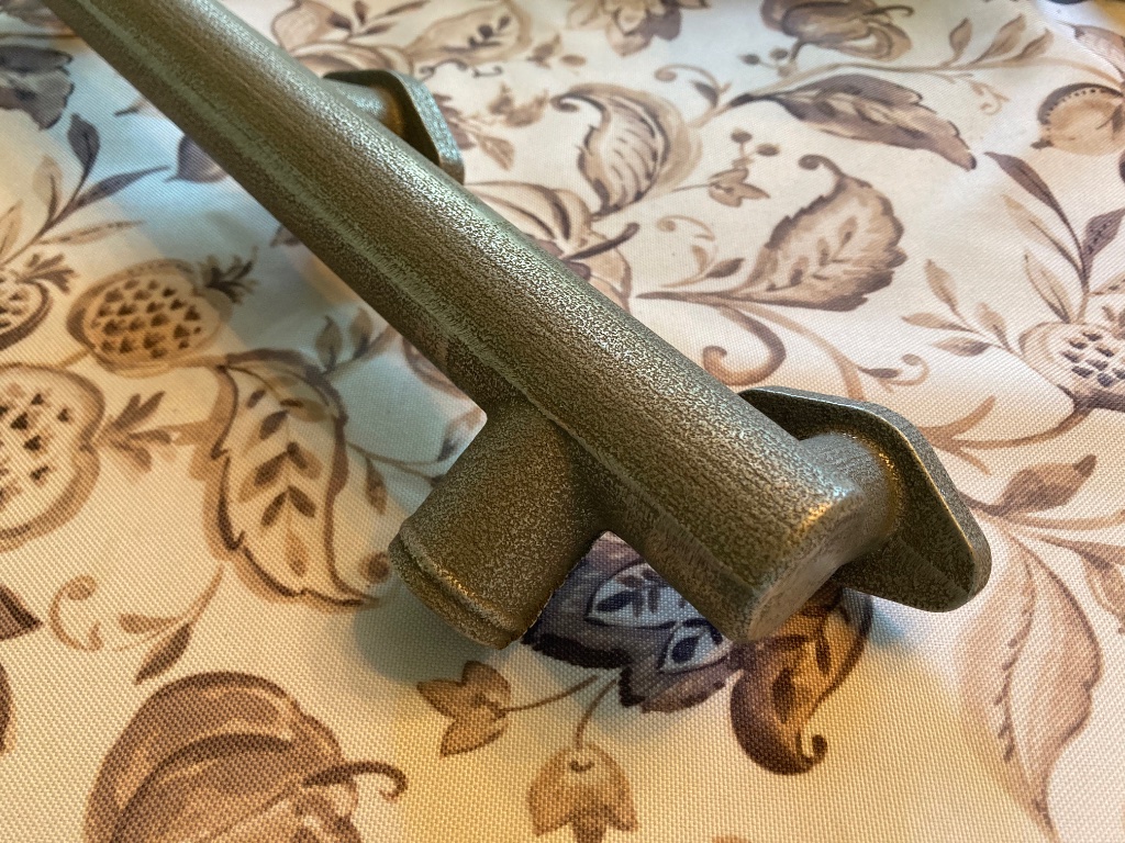

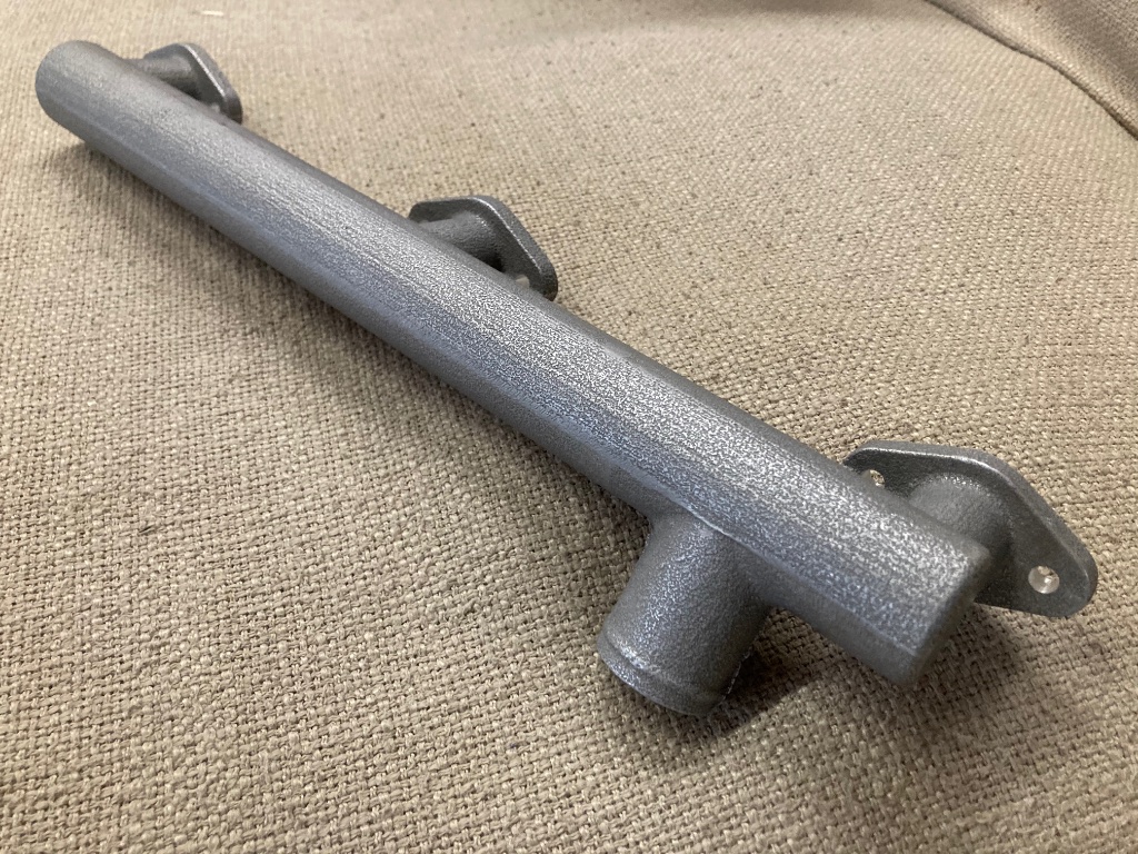

The foundry has shipped my order! Time to start planning the machining fixture…

That’s a good question Scott! The sand printer sends the molds to a foundry somewhere in Indiana… this same foundry has poured several other printed sand molds for me, and all have been fantastic quality materials and mold assembly. Please note that they charge accordingly for this attention to detail as well
- Posts: 6793
Oh, I have no doubt that they charge!
I spent a stint as a Supplier Quality Engineer in Aerospace and worked with a Foundry in New England and in Canada, casting very complicated avionics chassis. They were investment castings; quite the operation, and the products were as expensive as can be. A different process than yours, but I am acquainted with both, and there are fewer and fewer outfits doing this work...thus my question.

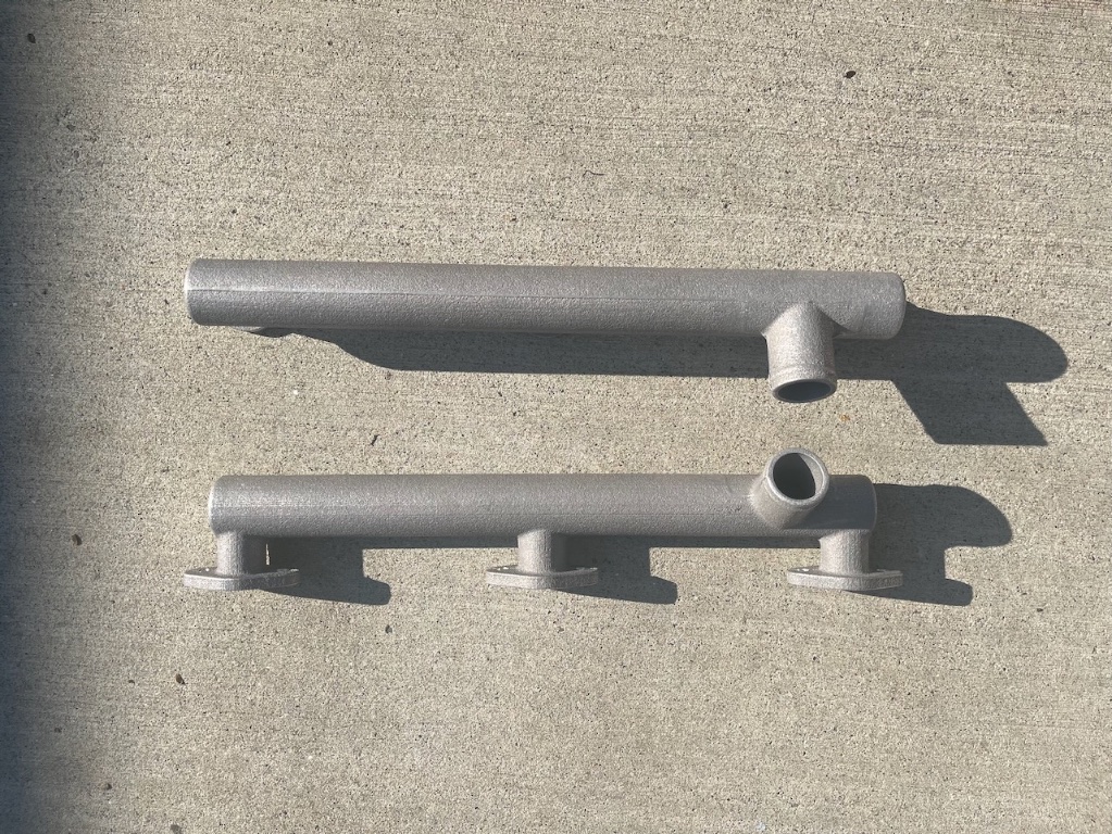

Before engaging with this 3D sand printing outfit… I had given up on having parts cast! Too many excuses! I was waiting 8-12 months for parts… and they were ugly when I finally got em! Nothin like payin full price for a casting that the foundry forgot to put the core in! I picked up a batch of Buffalo wheel centers recently… only took em 16 months! Good thing I got my order in early
For small batches, this is the only way to go! You have to be savvy with modeling software… but the parts are right the first time, with no excuses!
Kevin Pharis
- First Name: Kevin
- Last Name: Pharis
I hope to have all the castings machined tonite! If you are on my list, expect an email this weekend

The 2nd batch of water manifolds is machined, packed, and ready to ship! Emails have been sent to those on the list

My new Fronty manifolds arrived.
Kevin did an excellent job. They look fantastic and will look even better on some engines.
Thanks to Kevin for making these parts available.
Tom

Kevin Pharis
- First Name: Kevin
- Last Name: Pharis
Finally getting to install my Fronty water manifold! I made a drill jig out of 5/8” thick aluminum bar, clamped it to the block, and ran a drill bit thru to the water jacket. Turns out the iron is pretty tough! A few of my tapped holes look like they were drilled by hand, the rest look pretty good. My aluminum drill jig was wearing as I struggled to drill thru the hard spots… I suggest using a steel jig or better yet a mill!
