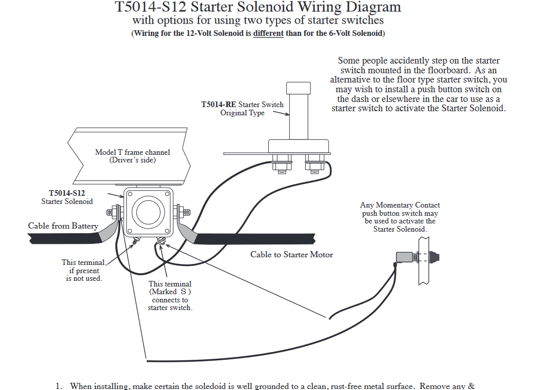

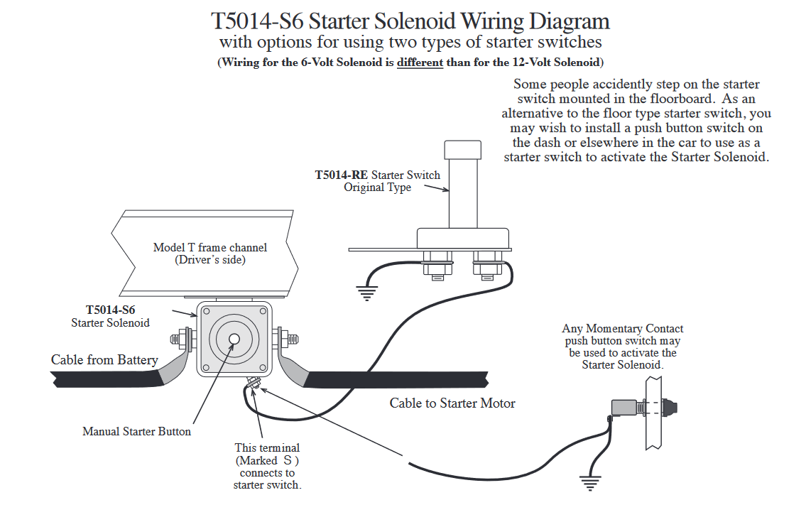

In discussions regarding starter switches, there is mentioned of a "Ford Type" solenoid. Is that a particular solenoid that is preferred when using one in addition to the original floor switch? If so, how do they differ from other solenoids?

I believe the reference to a Ford solenoid was to the 3 pole configuration since a distributor lead was not necessary. 4 pole normally unused , but if necessary for a ballast resistor or distributor ignition coil (not really necessary)

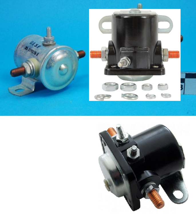

You can bye modern style solenoids 6v or 12v with 3 or 4 poles at any automotive parts outlet. The "Ford" style refers to the 3 pole 6v not really a specific look, but mounting hole positions. https://www.google.com/search?q=6v+star ... V6BQgBENsB

Early Ford solenoids 30 and 40s were activated by grounding the small terminal . The push button in the dash had one wire and used dash mounting connection as ground. They look like the one that uses battery voltage at small terminal. Be sure you know which type you have.
I use a stock Ford solenoid on my flathead and T. Both are g rounding type.
