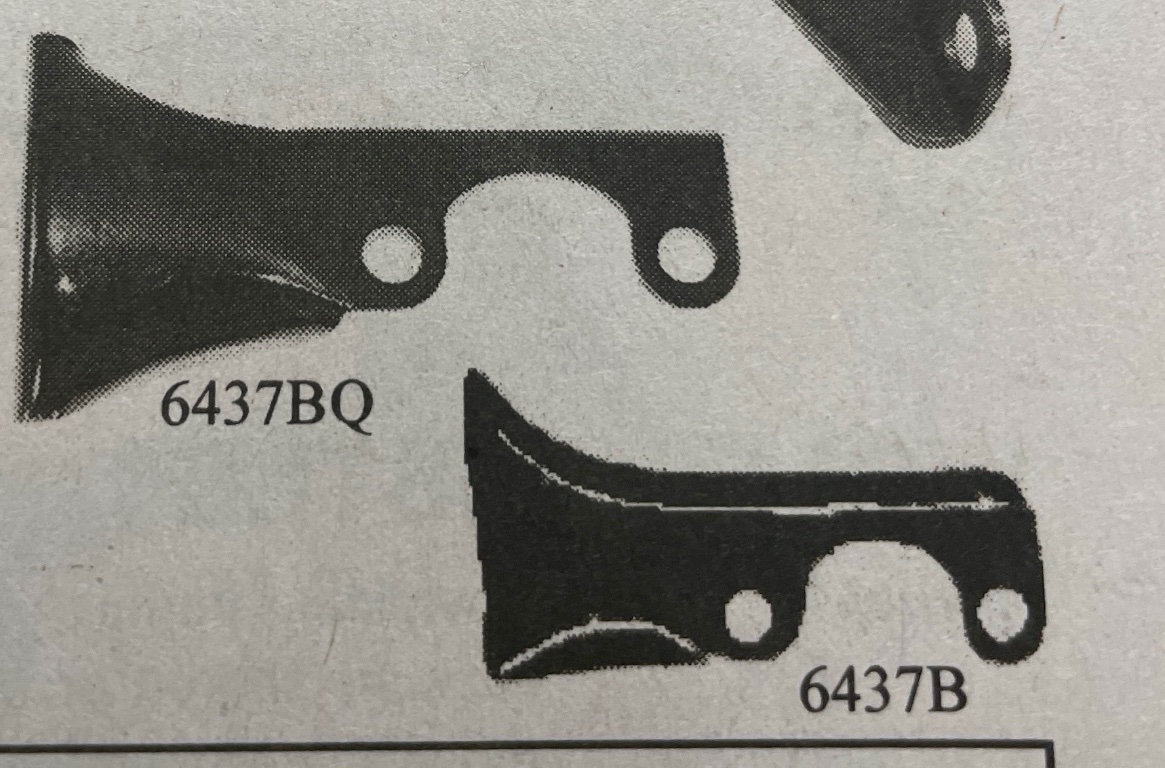

https://www.modeltford.com/item/6437B.aspx
This is the bracket you will need.

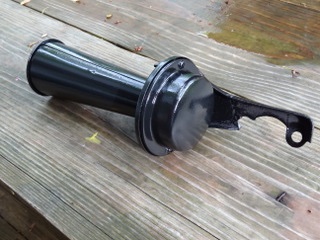

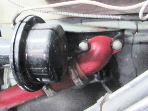

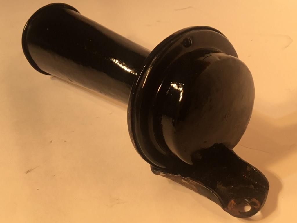

'26-'27 electric horn with the proper bracket to mount due to the coil box on the engine with the Improved Car
Note: Bracket is busted away at spot common to fracture due to shaky motor!
IMG_0610 (600x450).jpg (123 KiB) Viewed 1842 times

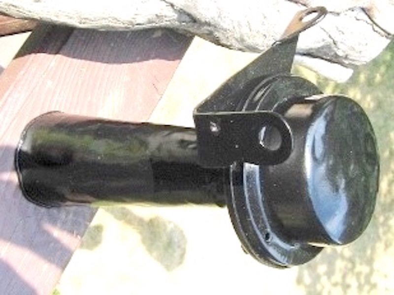

And easy to convert any late T elec horn to 26-27 just by changing the bracket.

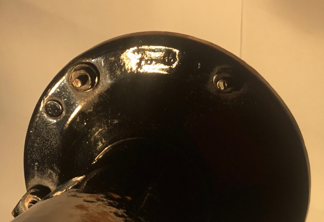

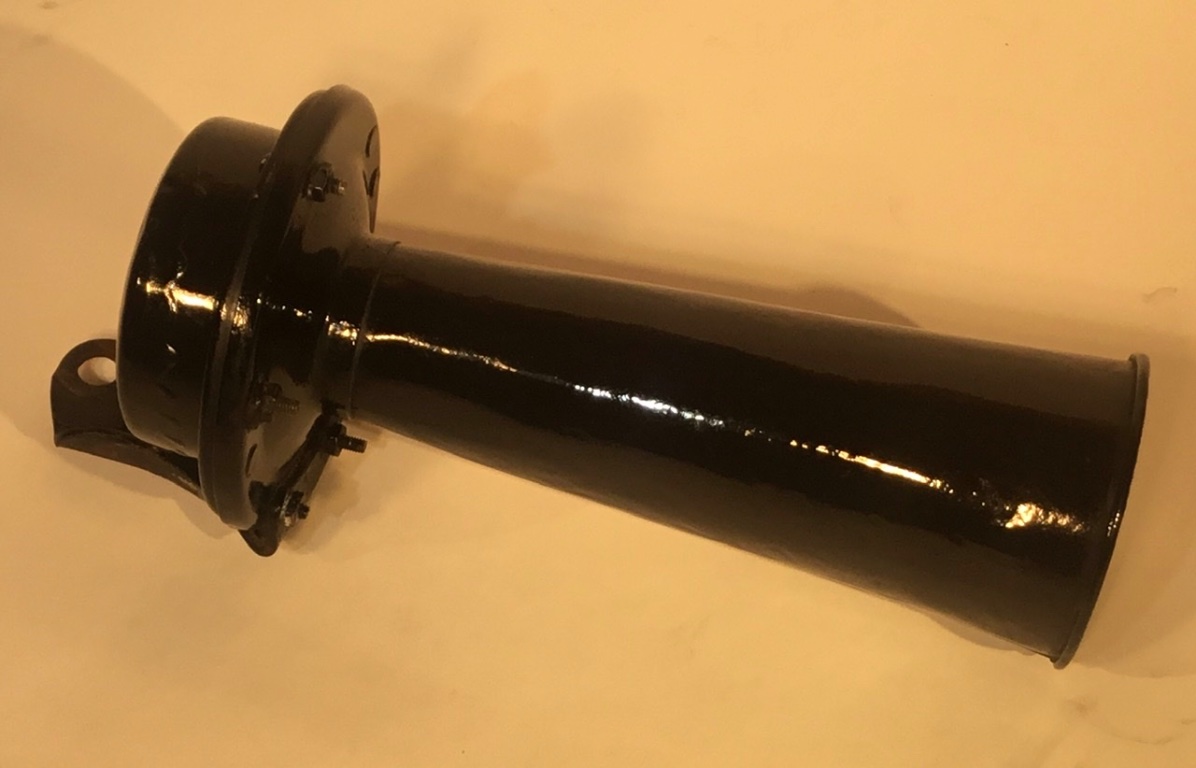

Here are 3 pictures of the original Ford script goose horn that was on my 1926 coupe when I bought my T in 1970. Jim Patrick
