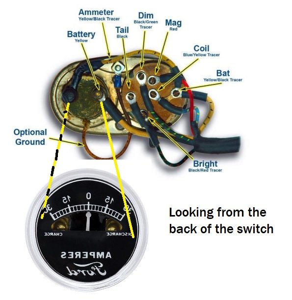

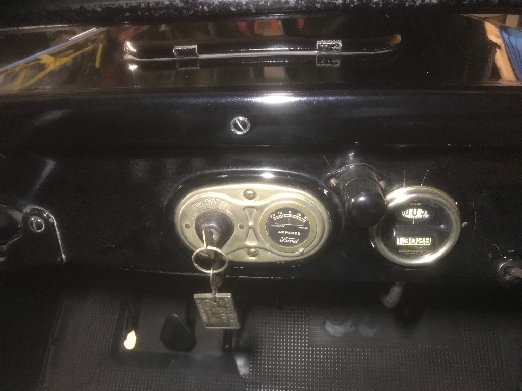

The needle on the ammeter on my '27 moves to the charge side when the lights are turned on and the engine is off so I reversed the wires but when I reversed the wires the lights don't go on and the needle doesn't move. I put the wires back the way they were and the lights work again and the ammeter still shows positive when the lights are on and the engine is off. Is the ammeter bad? I would assume that if it works with the wires one way it would with them reversed as well. Any suggestions?

There is nothing inside the ammeter that will prevent it working only with one polarity. It's just a current shunt which actuates the needle. It should work both ways round, although of course the discharge/charge indication does depend how it is wired. Model T and A ammeters are the same.
Reversing the wires causing it to become inoperative suggests some physical problem with one of its terminals. Particularly with repro ammeters, the terminals can be problematic. Paul Shinn, of Model A fame, addresses this in one of his videos https://www.youtube.com/watch?v=n85WuQa ... =PaulShinn

The correct connections are to have the battery negative ground and the positive goes from the battery positive terminal to the starter switch. At the starter switch on the same side of the switch with the battery cable is a yellow wire which goes to the terminal block on the firewall. From there it goes to the ammeter. And from the ammeter the terminal block and then to the cutout. I have not included all the wires to lights and coil box etc. But have given the direct route from the battery to the generator. Everything else is connected to the wires which go through the ammeter in such a direction that if you are using the battery the ammeter shows discharge but with the generator turning, it shows a charge. Note, depending on how many amps the generator is set to charge, you might show a discharge with the lights on, but less discharge than they would show with the generator not running. Now that I have confused you thoroughly, Hopefully, someone will post a wiring diagram for your year car.
If either the battery is connected backward or the ammeter backward, it would show discharge with the engine running, or charge when the lights are on without the engine running.
The Model A ammeter looks like a T ammeter, however it reads opposite a T and if used, the wires should be reversed at the ammeter.

I had an earlier Ford script larger ammeter that I hooked up temporarily and it worked fine so I guess the ammeter was the culprit. I have another original ammeter in Florida and will replace the defective one with that when I get back to Florida in the fall. In the meanwhile I will just live with what I have as it seem to be functioning except for showing charge when it is actually discharging. Thanks again for all the help.
