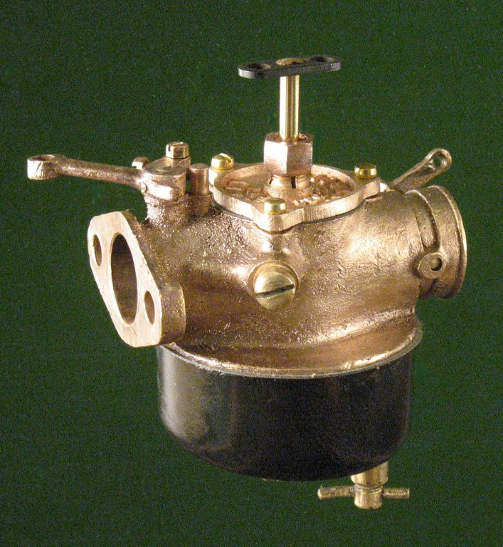

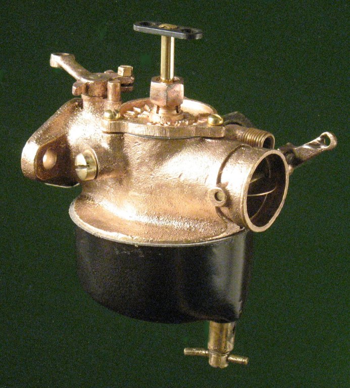

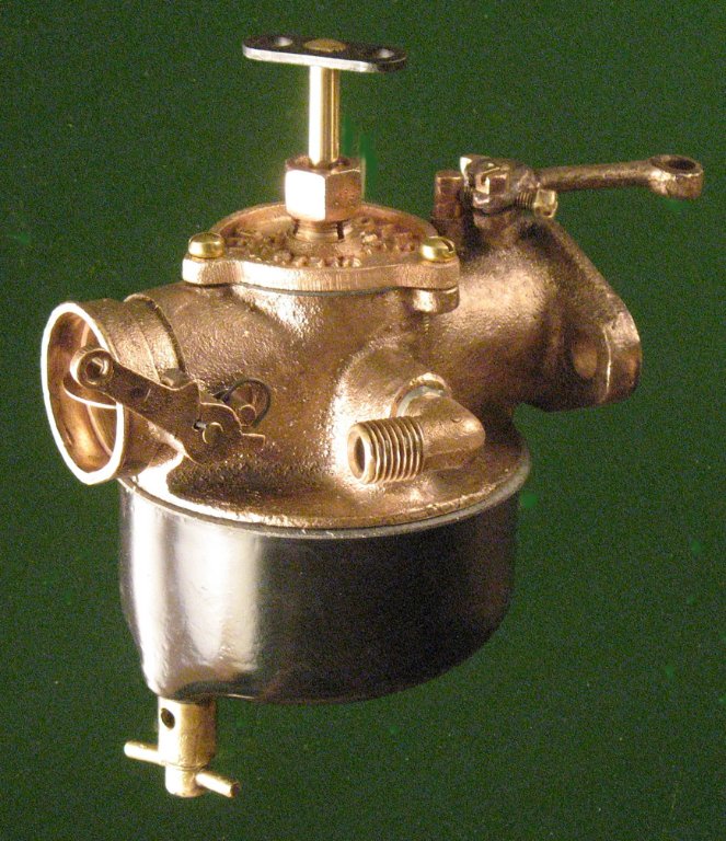

- Posts: 7411
Re: What carb is needed for a 1915?
Here are a few more G photos. They do clean up nicely.
Note the flange around the hole at the choke end of the carburetor. Some have that and some don't. I prefer it as it's helpful in mounting an air filter.

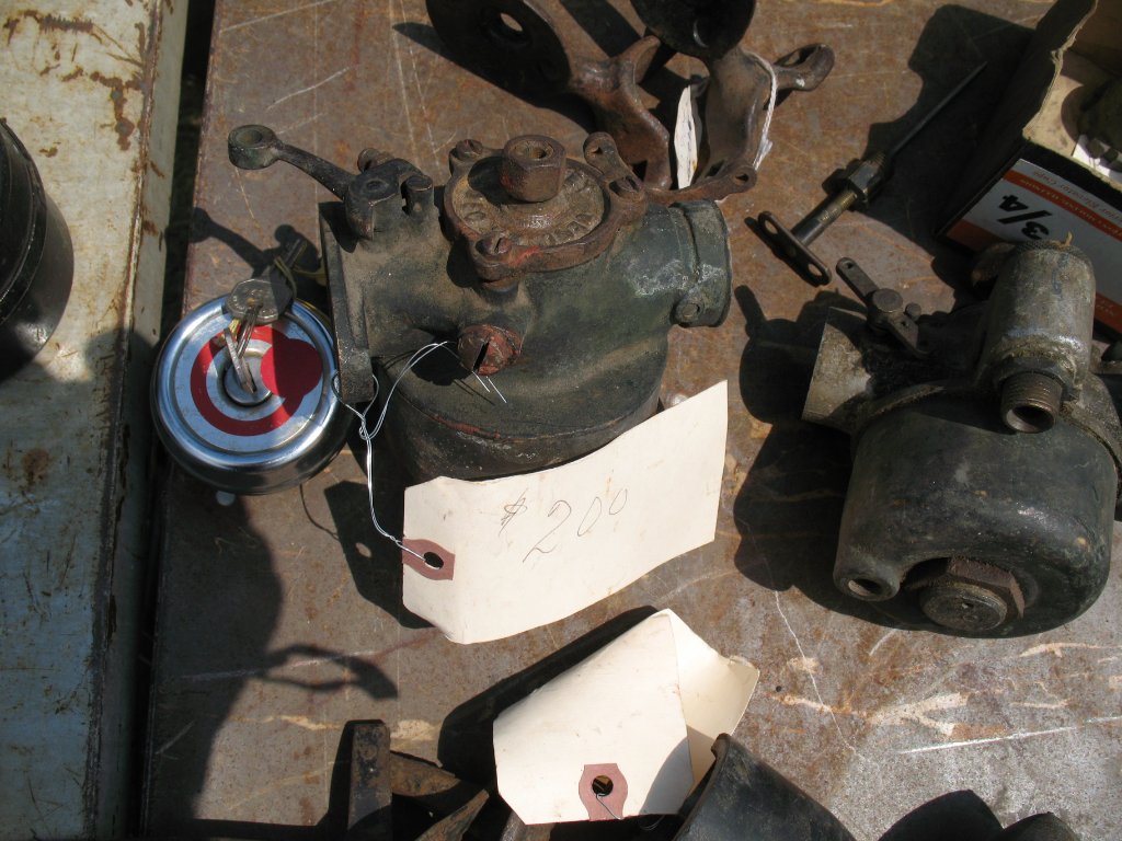

Years ago at Iola I saw this G that was desperate for cleanup and repair. I asked the guy why the price was so high. He said, "Why, that's a three-screw carburetor!"
I put thousands of miles on a '15 Touring with a Holley G and had absolutely zero problems with it. They are great carbs. I've seen reports where the NH flows more volume, yada, yada. But even at 50 mph, my car showed no signs of needing more volume. I believe the ones with the depressed ring around the intake, as Steve posted, are correct for '15.
