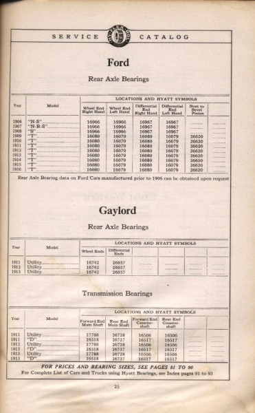

I recently obtained an original copy of the Hyatt Roller bearing catalog covering the period from 1897 - 1916.
In it, Model T Ford axle bearings are listed as part number 16080 for the RH side of the car and 16079 for the LH side.
I wonder why Ford specified different part numbers for the two sides, perhaps the rollers are wound in different directions?

That might be so - does anyone have a later Hyatt bearing catalog that covers the years after 1916? If yes, does it show a change to a single part number for both sides, and if so, when?
Never mind, the light bulb just came on, duh! The different part numbers are because of the sleeves being different from side to side, not the rollers!
Right and left side sleeves have different locations for the locating dimple and grease hole. If I recall, the chevron cuts are opposite as well.
