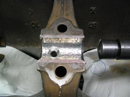

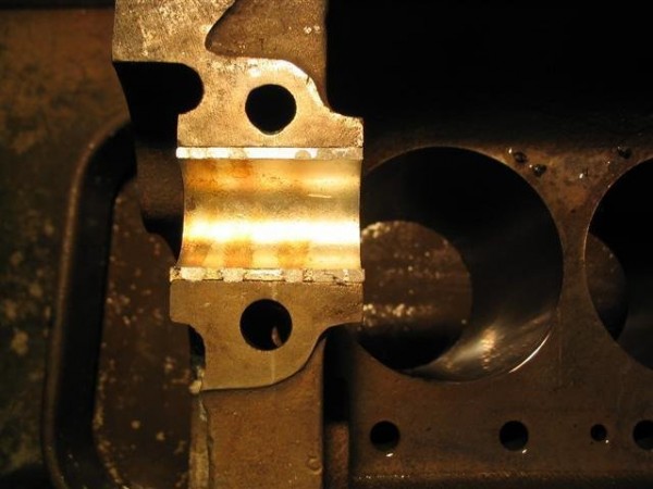

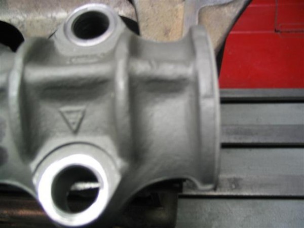

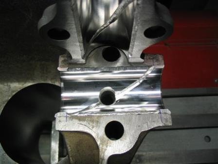

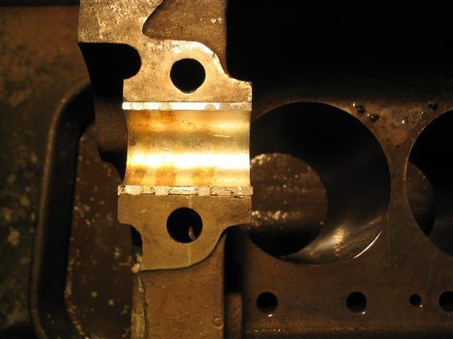

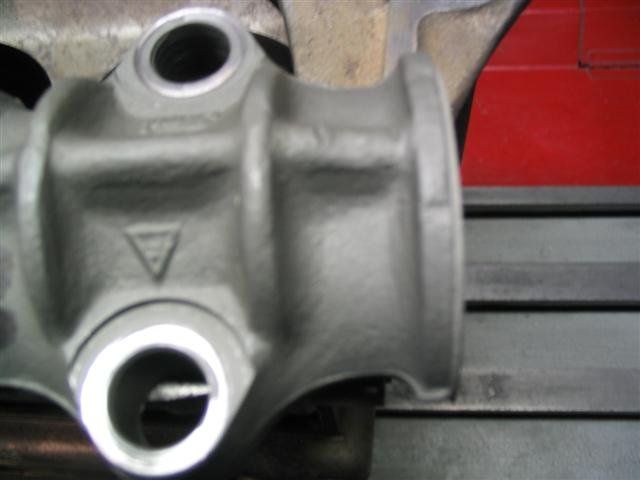

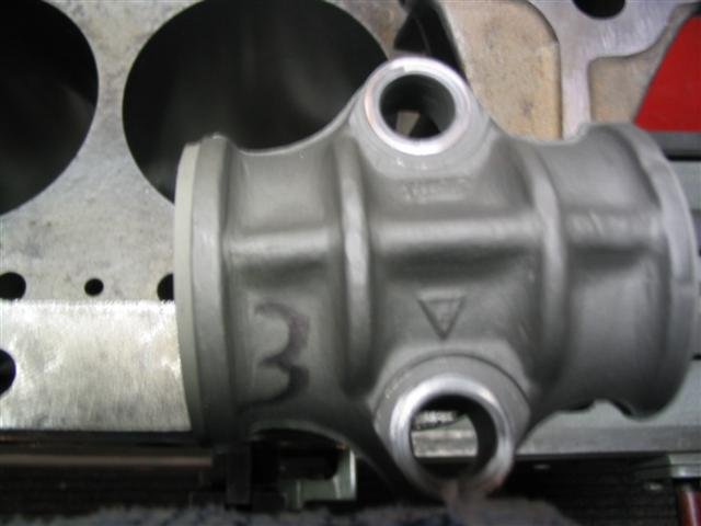

Of all the scat cranks we used, 3 were about .052 to short, in the rear main, the flange was thicker also, so Vern opened them up. These came out of older production, I called them at that time, and made them aware. It was cheaper to fix, and had control on the fix, them send them back.
We always check New, or reground cranks before we even think about babbitt.
Anyway, when the crank was set, the center main had equal distance on either side, and the time gear on the crank was .010 short, of flush, to the cam gear, in length.
The rear cap, normally has more babbitt on the front of the rear main, then the back, because of front thrust wear.
Always punch the oil holes out, clean with a drill, at the last.
Herm.
