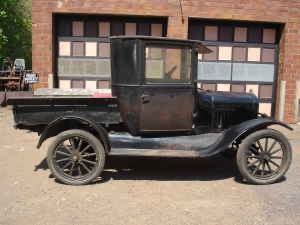

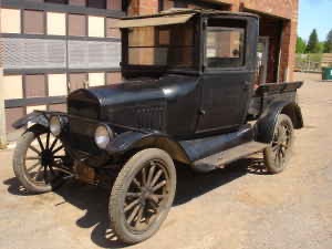

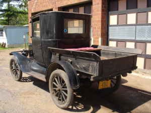

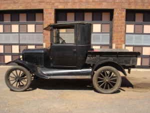

While I realize Ford never made a closed cab pickup, I wonder if I could get opinions on what year and model of closed car this one started out as. Sure looks nice!

Shortened 4 door sedan...?🤔

If that had a metal bed modified a bit to fit better to the back of the cab,that would be 1 of the coolest T's I have seen in a long time.

‘24-‘25 coupe. LR fender points to ‘25. Rear of cab too nicely done for a sedan.

While I can’t say for sure on this one, many of the closed Model T’s converted to closed cab pickups were done using 1924-25 or 1926-27 Tudor’s. On the 1924-25 T’s the Coupe’s attached deck made this conversion harder. I would say this T pickup was once a 1925 4 door in this case, because of short front doors from a 4 door and the 1925 rear fender although the front fenders look like they are the 1924 type with the exposed bead.

I believe this shows that it was a 1924-25 Tudor. The door proportions, visor, cowl and splash apron look exact to me. The rear upper body panel does look different but I don't believe it is Coupe or Fordor. Maybe custom or extended. There is a vent in the cowl although not clearly seen. Coupe and Fordor doors were not that wide.
We had a '24 Packard and some Buicks with that treatment in our area. It was a typical modification.
It would certainly be a fun car.

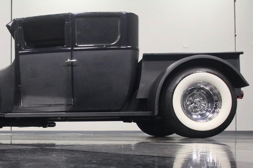

P.S. This shows the same view of a coupe. Notice the narrower window and transition to trunk.

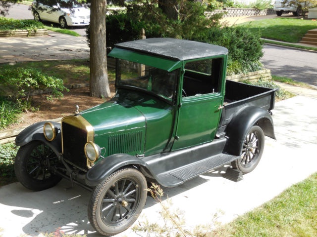

This one is a shortened Tudor

Wow! Thank you one and all, this is some really great information. Makes it clear it was a Tudor.
