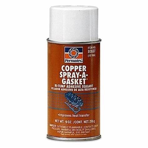

Re: Head bolt keeps turning

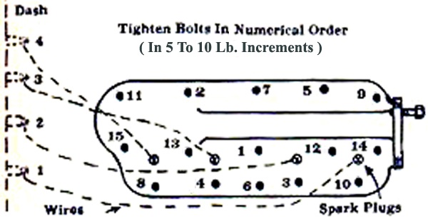

While you are at it, chase the threads of all the bolt holes and blow out with compressed air. Before doing this, using duct tape, tape over all water jacket holes and cylinder holes to prevent metal shards from going into the holes. Tape over the threaded holes not being cleaned out for the same reason. When installing the head, stagger the tightening of the bolts and be sure to torque no more than 50 lbs. Hopefully, you were able to salvage your head gasket. Be sure to use copper head gasket sealant on both sides of the gasket. Jim Patrick
