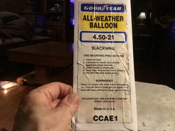

A couple of months ago, I installed (5) brand new 4.50-21 Goodyear tires on the 21” split rims of my 1926 coupe. I took a picture of one of the labels. While I think I know what the numbers 4.50-21 mean, I am not absolutely certain. I have no idea what the CCAE1 means. Jim Patrick

Jim-
4.50" is the sidewall height.
21" is the rim diameter.
Twice the sidewall height + rim diameter = tire outside diameter:
(2xx 4.50) + 21 = 30"
CCAE1 is probably an inventory code.
Yep, manufacturers part number.

Thank you. I was wrong. I thought the 4.50 was the width of the inflated tire. Jim Patrick

CCAE1 is a tire code for a 4.50x21 polyester ply tire black rated just over 850 lbs. capacity each...
CCAE2 is a tire code for a 4.50x21 polyester ply tire whitewall rated just over 850 lbs. capacity each....
