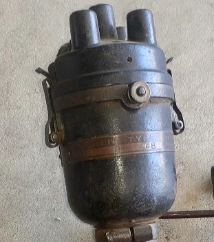

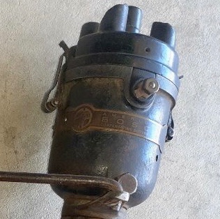

Iam looking for any information related to the American Bosch front plate distributor. Parts books, installation information and the like.
this is a type T448 that I have obtained. Any help is much appreciated.

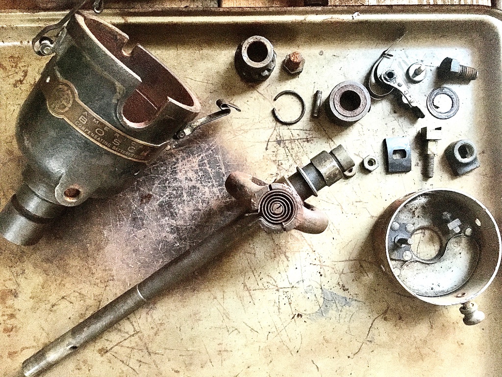

Post by Bryant » Sat Aug 13, 2022 7:35 pm
For anyone interested and wondered what was inside I disassembled the distributor earlier. The main shaft has a interesting centrifugal fly weight set up. Everything seems worthy. Thou not to hateful the main shaft I would consider having duplicated.

Post by Howard Tomlinson » Sun Aug 14, 2022 11:37 am

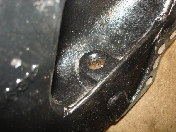

I have an original cast iron unit with the distributor. When I bought it the front plate had no bearing or bushing where the bottom of the distributor main shaft would be supported. Is this correct?
I also have one of the aluminum reproductions and it has a roller bearing at that spot.

Howard I also did not see any bushing in there. Iam thinking there is plenty of oil splashing around by the drive gear it’s well lubricated. Mine looked to be in good shape.

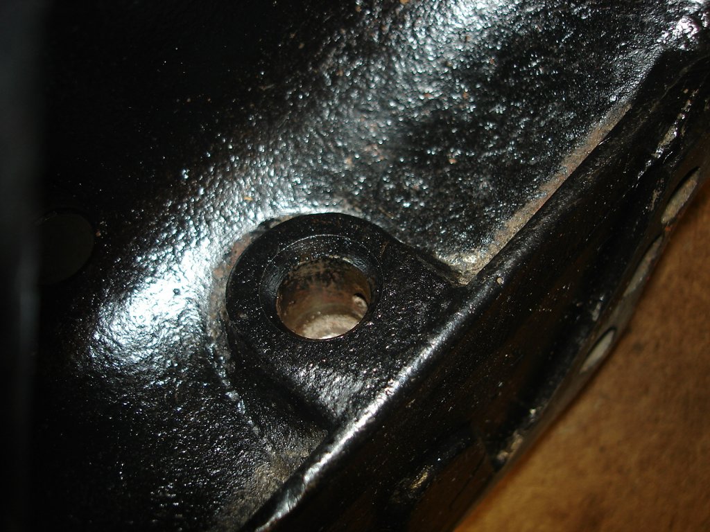

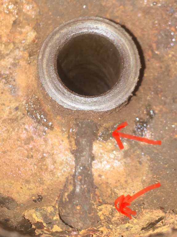

Post by Bryant » Wed Aug 17, 2022 8:52 pm

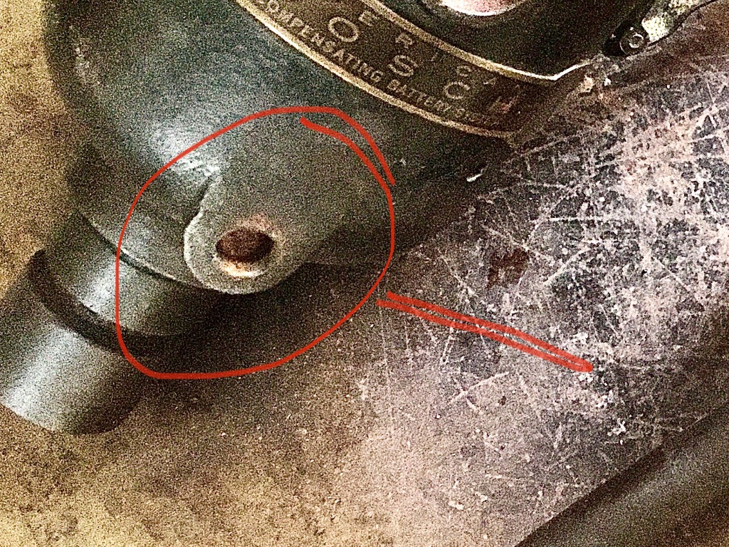

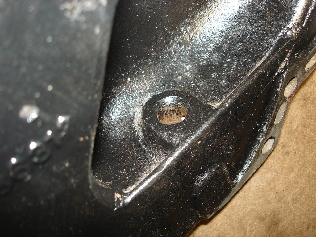

Iam guessing but is there an oil cup that goes here? Maybe one that has a oil wick inside to go to the shaft?

Post by Jerry VanOoteghem » Thu Aug 18, 2022 2:47 pm
Iam guessing but is there an oil cup that goes here? Maybe one that has a oil wick inside to go to the shaft? 2D6408C6-2430-44AE-A129-E1C730AF43C6.jpeg
Yes, that's for an oil cup. I don't recall if there's a wick or not, but it would make sense if there were one.

Post by Bryant » Thu Aug 18, 2022 3:52 pm
yeah it has a trough between the two holes marked by arrows on the inside. Thanks jerry! Guess I will be looking for something else.

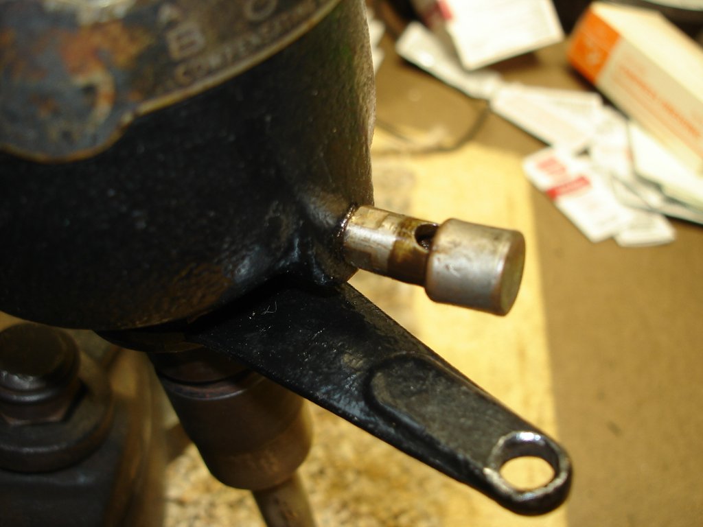

Post by Jerry VanOoteghem » Thu Aug 18, 2022 7:04 pm

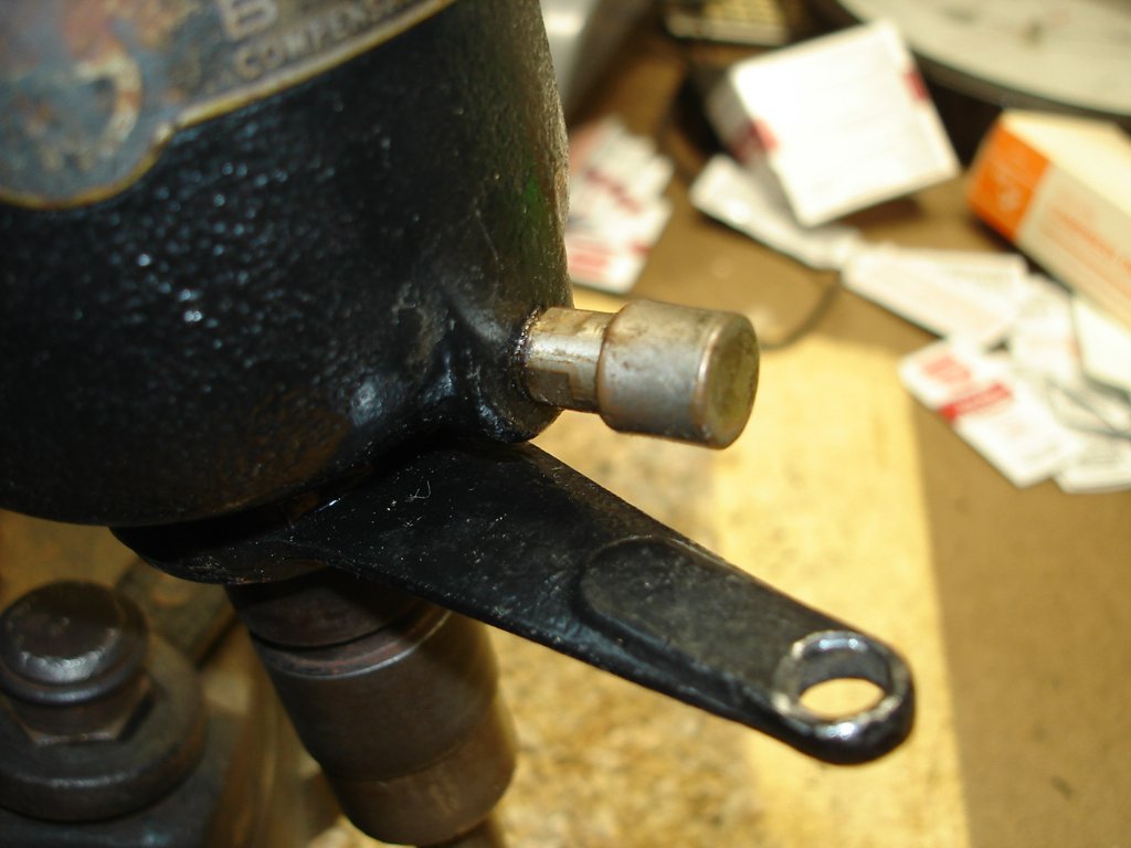

Here is what the original oiler looks like. As for the bottom bearing, there is no bushing, but there is a lube hole running to the bottom of the bearing. Make sure it's cleaned out.

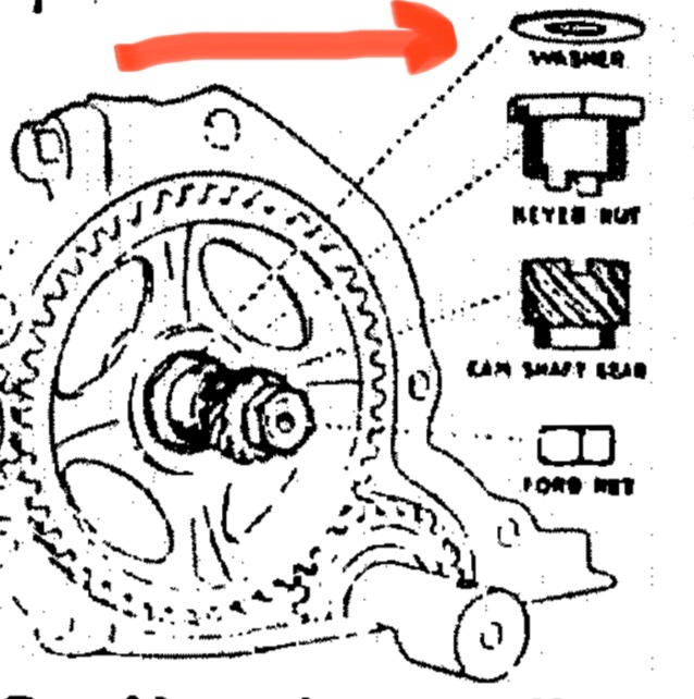

I have purchased the keyed cam nut, cam gear and ford cam nut. I can’t seem to find a source for the washer. Does anyone know where to get it? Or maybe it’s dimensions so I can source it by size. I am thinking it’s acting as a shim for the proper alignment of the drive gear to the distributor gear. Information on the gear lash for these two gears would be helpful also. Thanks

I have never run a washer under the cam nut (didn’t know I was supposed to). You will find that the reproduction cam nut drive tangs need to be relieved to make clearance for the driven gear teeth. Adding a washer under the cam nut will only make this gear mesh interference worse.
Gear lash is difficult to set up as it is the crank seal that decides the lateral position of the front plate. A little extra clearance is better than none

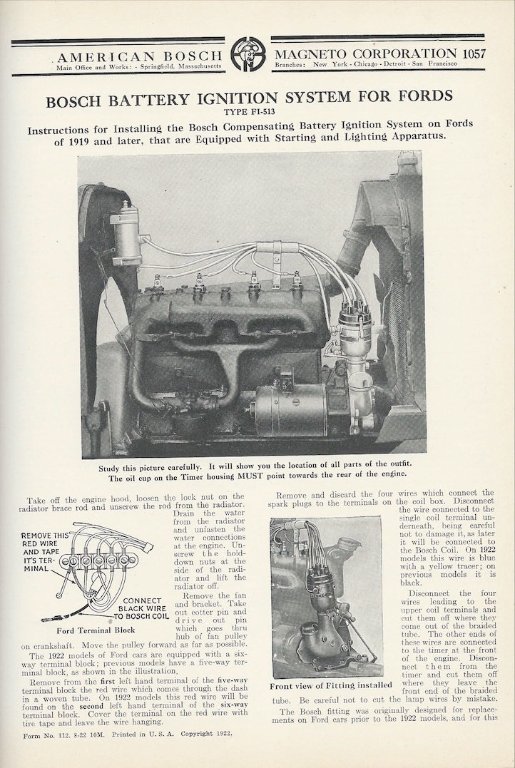

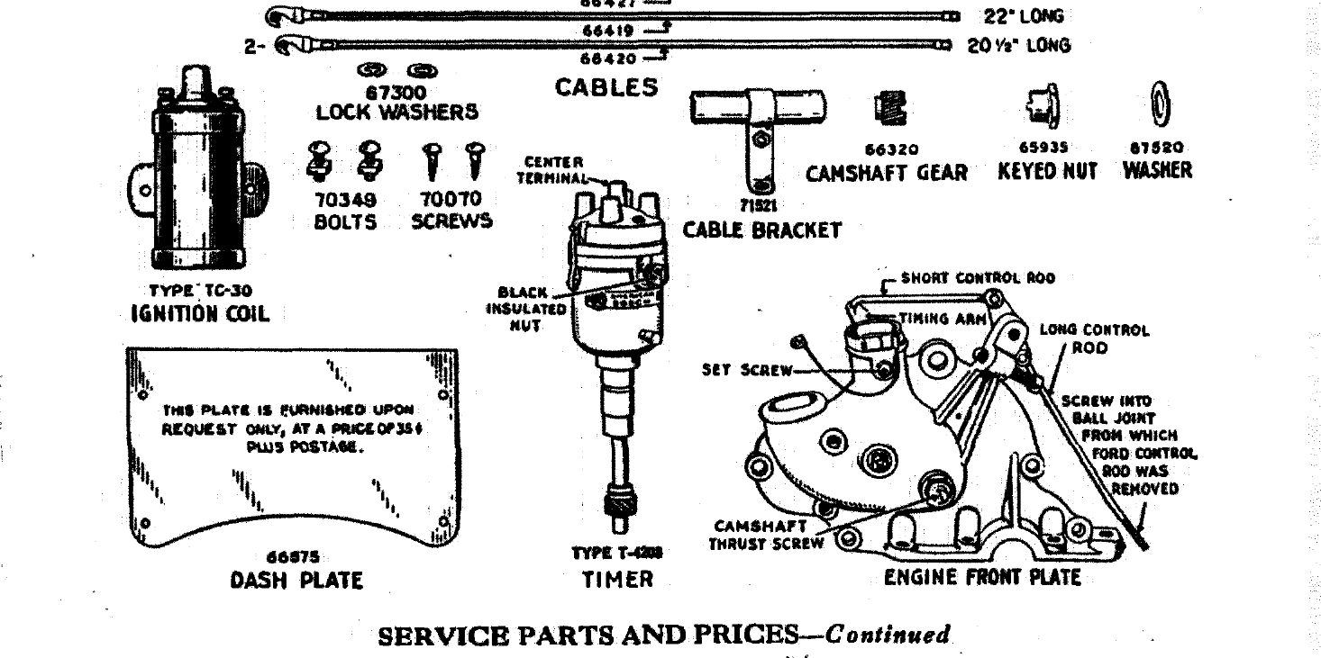

Forgot I had this
1923boschmaginstmanual.pdf
(419.76 KiB) Downloaded 113 times
Picture from PDF

Thanks for the info about the drive nut modification. I wasn’t sure about the washer until I saw the picture with one in line.

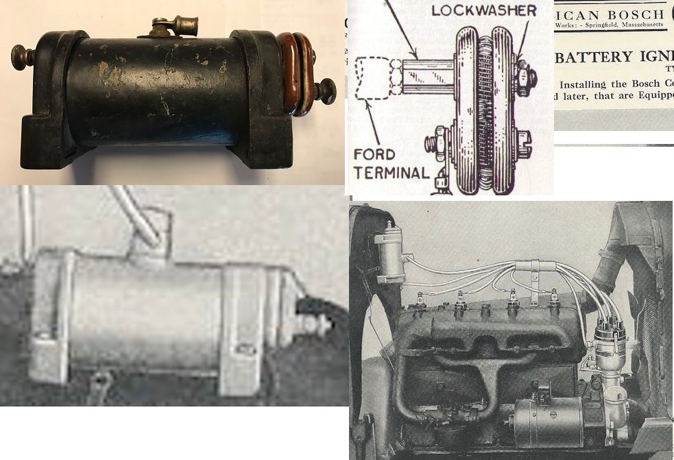

Thanks for the extra information on parts with numbers. I would love to find that AB coil somewhere.

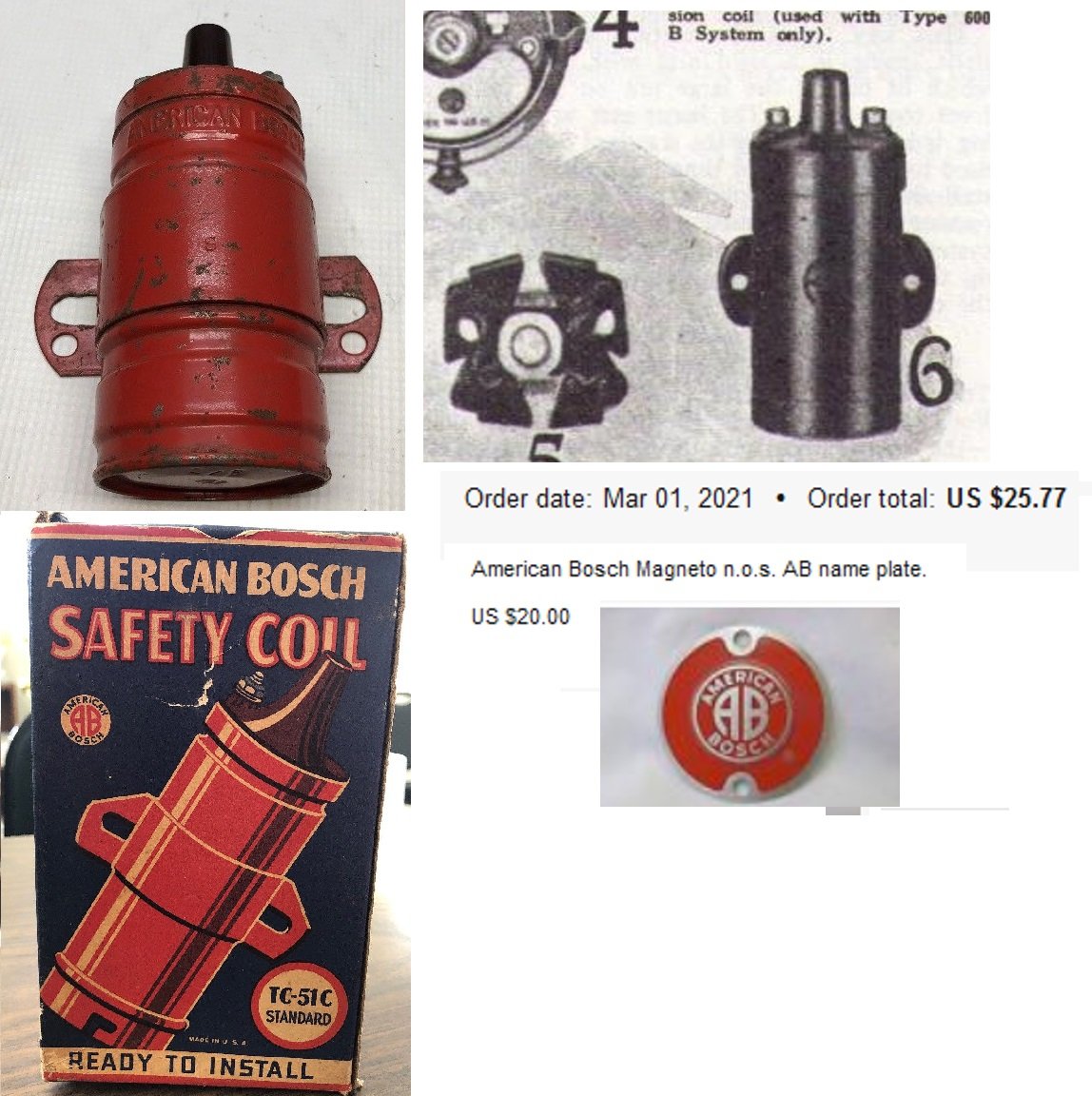

There are two different American Bosch Coils shown in their ads.
This apparently was a very early one but some of it is shown in the same ad as the more conventional one (second picture)
I'm using the red American Bosch coil shown. I replaced the coil with a new 6v (had to drill small hole in bottom of the steel holder to break the vacuum holding the old coil in place. The red coil has American Bosch embossed along the top. I purchased the tag but have used it
Here's one on eBay like I modified https://www.ebay.com/itm/115710603891?i ... R6ri0Z7OYw
This is more like what I used https://www.ebay.com/itm/275925767280?i ... R6zi0Z7OYw
The universal one ttps://www.ebay.com/itm/292991097481?itmmeta=0 ... Vh5koYxAqp

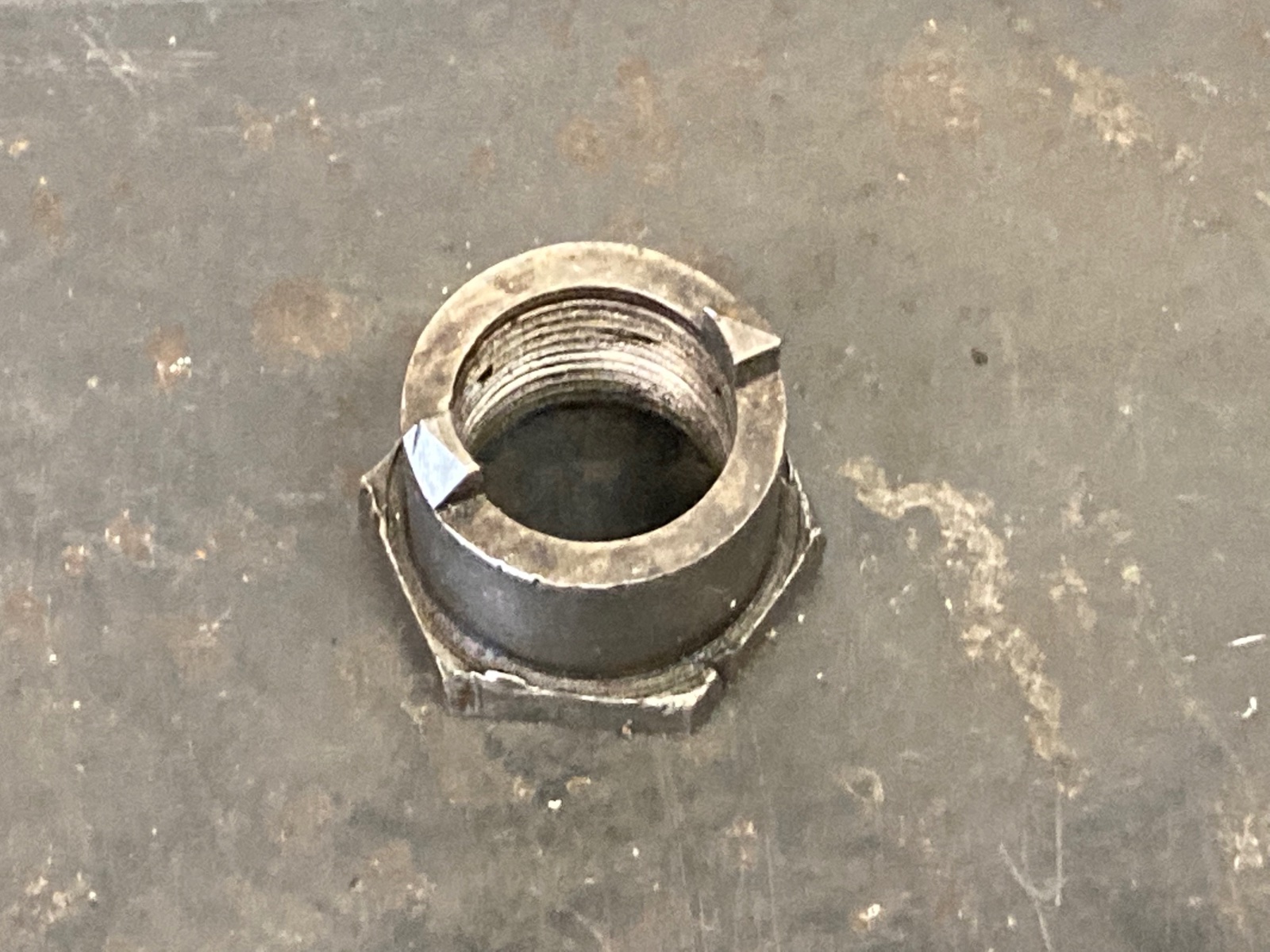

Found this little bugger laying on the workbench. Notice the relief cuts on the drive tangs

I actually have the 3rd one listed on eBay on a watch list. I always wonder if they will still work.

Thanks this is exactly what I was thinking with the driven nut modification. It’s a wonder it doesn’t come this way.

You don't need to wonder- just plan on replacing the coil - may need ask for the diameter of the unit
I wasn't sure if coil I bought was 6 or 12 volt or if it was any good. Lang's had a 6v coil at the time for about $12. It wasn't that hard to replace. Its oil filled so mounting upright is recommend - gel is more expensive.

Are the reproduction cam nuts made too long?

When installing these you need to be very careful that the drive gear is located against the shoulder on the cam shaft and that the nut is not preventing the gear from locating properly. The tangs should just drive the gear, not locate it on the cam. The marks on the drive tangs above were most likely made by the distributor gear hitting the tangs. if the cam gear hub is thicker than an original gear, the nut will sit out too far and create a problem.

Re: American Bosch front plate distributor information
Post by Gen3AntiqueAuto » Mon Mar 25, 2024 9:13 am
I just installed one here without a washer, didn't come with one. I also had no problem with the tangs, no need to file them down.
Take a look: https://youtu.be/WhMediNH1Rs

Frank
Kevin
Bryant
Frank are you suggesting putting a new coil in an old case?
Bryant
