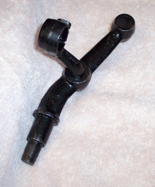

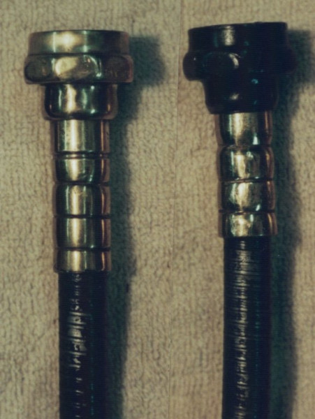

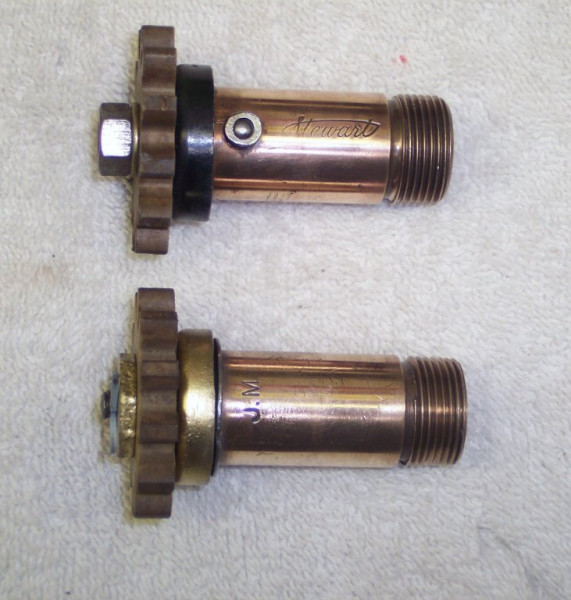

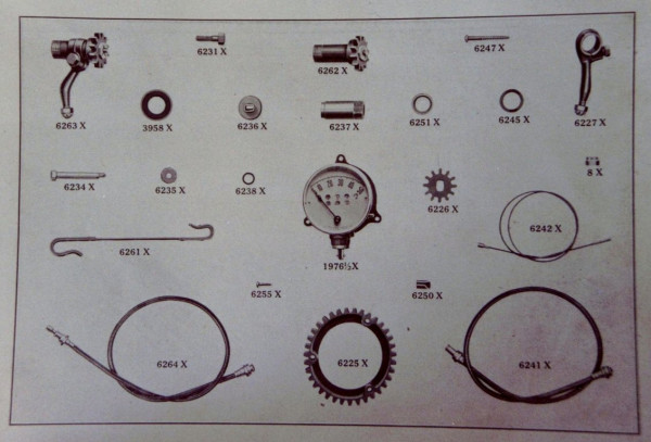

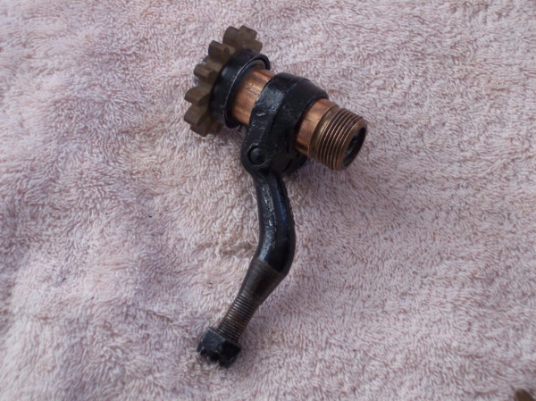

Here are some photos of the Ford Motor Company speedometer parts (commonly known as the "Ford Special"). The first attachment is from the "Price List of Accessories and Accessory Parts" dated February 1915. The remainder of attachments are photos of the drive and cable. The road gear is a 35T8P gear that fits onto the Ford machined hub. I hope this helps. Russ Furstnow
