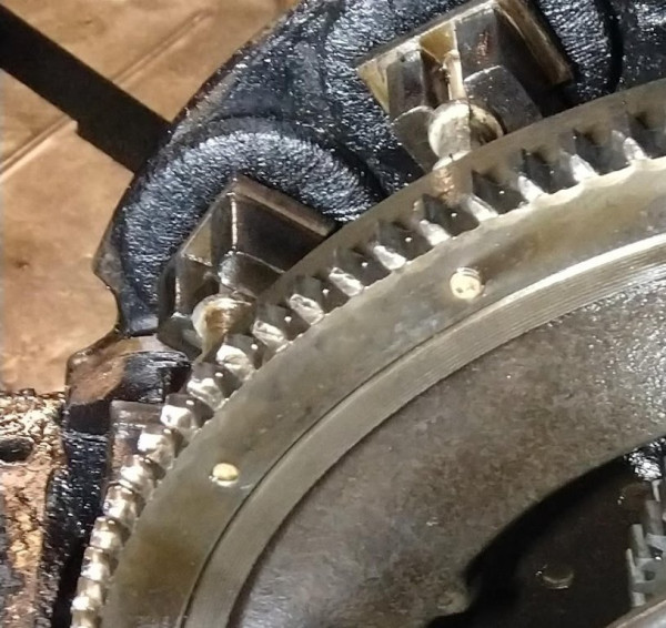

Thank you for the replies. What would be the danger of not doing anything at all? The coil is right next to the starter shaft notch and it is only uncovered about half or less (see photo). All other coils are intact. Thanks.

This is what I think has happened to your winding. Someone at some time has tried to remove the starter without first removing the bendix. when they pulled the starter, the bendix bumped the coil and damaged the insulation. You don't say whether or not the magneto worked before you discovered this damage. If your fix doesn't work, you will have to pull the entire engine and transmission and separate the transmission from the engine to replace it. So do it right the first time.

Look at the flywheel ring gear! In my opinion the missing insulation is the nat sitting on the trunk of the elephant in the room. The much bigger problem, are the teeth worn so much on the flywheel. And what all that metal in the oil has done to the babbitt. ???
