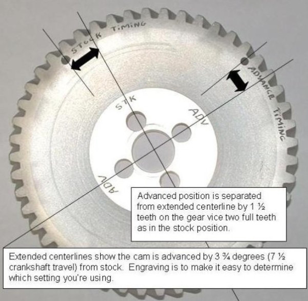

if you want to go faster with the 280, use a stock cam gear
if you want to pull harder on hills, contact Dan McEachern and discuss a 5 degree advanced timing gear (suppliers sell 7 1/2 advanced, which I have but you really don't need the full 7 1/2 degrees). Your car will still idle well and will pull harder but at a little expense of top end speed potential.
regardless of the timing gear you use, all timing marks and timer timing remain as stock.

The standard 280 has a lot of low end torque, maybe too much, & benefitted(s) by a 7.5 degree advance timing gear.
As I recall, when I set this cam @ 7.5 degrees advance, it gave me a split overlap @ tdc.
This was the set up I had (std280). I broke the advanced cam gear & put a DM bronze std timing cam gear in. It feels like I gained low end torque & lost some top end speed.(not what I wanted) My harmonic dead spot moved down to about 50mph from 58. (3.07) gearing. & is much more pronounced in rux.
The next step , I thought I might try advancing this gear 1 full tooth to get my top end back plus, but retain enough low end. Too much??
Cam timing is magical mystery to me. Trial & error. What have your experiences taught you?

I am responding to this old thread after reading several about advancing cam timing. There are benefits to be had advancing a stock cam 5 or 7.5 degrees. Chaffin's regrinds with advance built in so no advanced timing gear. Stipe may do that also. The problem that I have is with a recently-obtained 280 cam. It is a regrind in which I and the previous owner don't know who ground it or to what timing specs. I just know it has .284" intake and .287" exhaust lift. I was not looking for a 280 cam but it fell neatly into my lap at a recent club meeting. My current cam has substantial wear and due for replacement.
I am looking for suggestions of ways that I can determine if this cam is advanced while it is out of the engine. Even installed, how would I tell if timing is stock or not? This image has been posted many times on the forum. Does this offer clues? I have a spare timing gear that I can install for comparison. But I doubt that I could learn anything about cam timing.

Mark, you have a lot of good questions. When I had my engine rebuilt I had a 280 cam put in from Stipe and a 7.5° advanced cam gear installed. Engine runs nice and smooth and it is peppy ! No starting problems, no overheating, a very pleasing ride. As mentioned, the Stipe 280 cam has an increased lift with no increased timing change. Hope you will have similar results. ..... Any questions you have about the cam I suggest getting in touch with Stipe, and if the cam has been reground after purchase, send it to them to get the answers you need.

According to Glen in recent years past, Chaffin's performance (non stock) cams matured and improved over the years, with SOME advance (not necessarily 7.5 degrees) built into them for the last umpteen years. Chaffin's produced a whole series of cams for different kinds of performance. I would not doubt that different cams had different advance dialed in or out - you ordered your cam (at one time I remember 3 or 4 grinds being available) and you got what you got.
Stipe cams, from my memory, came in various grinds/lifts, but had no advance built into them...you could use them for speed, or advance them for power (and lose back some speed). I have found Stipe's 280 cam with a Dan McEachern 7.5 degree gear to be a wonderful combination.
Dan McEachern makes excellent timing gears - both standard, and oversize, for worn engines, 7.5 degree advance (which may be a bit more than is needed; it is 1/2 tooth advance) or, I think, he will make as much advance or as little advance as you want/order.
Finally, from what I recall Glen saying, you do NOT want to advance their performance cams made for the last many years, as it's alreadedy baked in.

Without knowing who reground my cam or to what timing spec, I plan to install it with a stock timing gear and see what improvements or losses I get. My goal is not to increase top speed, but rather, to run better in hilly terrain. Anything will be an improvement over my current valve lift, which ranges from .170 to .189.

Good morning Mark.... For some extra piece of mind, it would take some time away from your project completion, but it wouldn't hurt to have the cam sent to Stipe for a check after someone had altered... This way you would know the actual lift now compared to the original setting.
