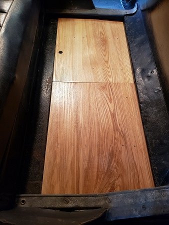

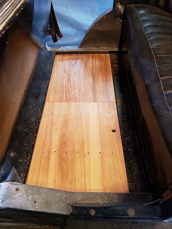

Sure....here ya go! Mine is cut in half for access to the battery. I got mine from one of the vendors, either Lang's or Snyder's. Can't remember off hand. It's solid oak, if I remember correctly.

By the way, it came cut in half, I didn't cut it.

I agree with Mike about the floorboard wood. The floor board is in two pieces to allow access to the battery. The piece of the floorboard with the hole is the piece that sits over the battery.

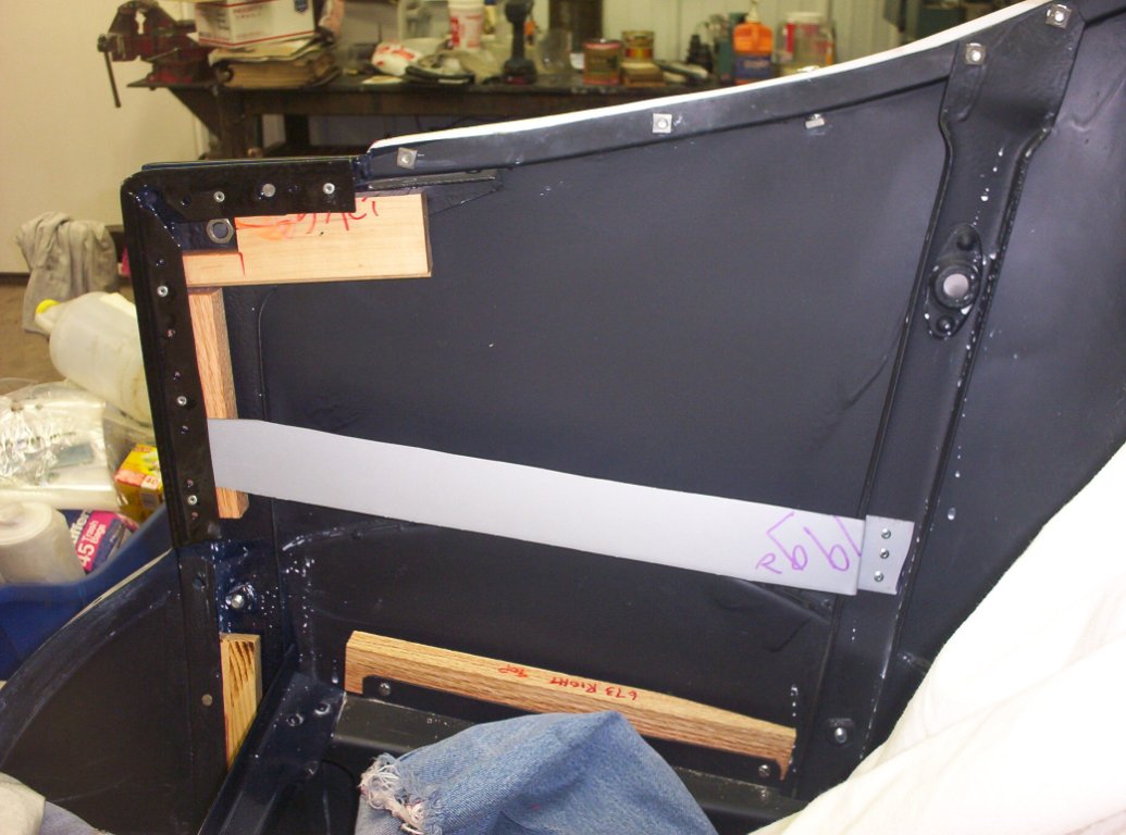

This is the wood that goes along the side of the body.

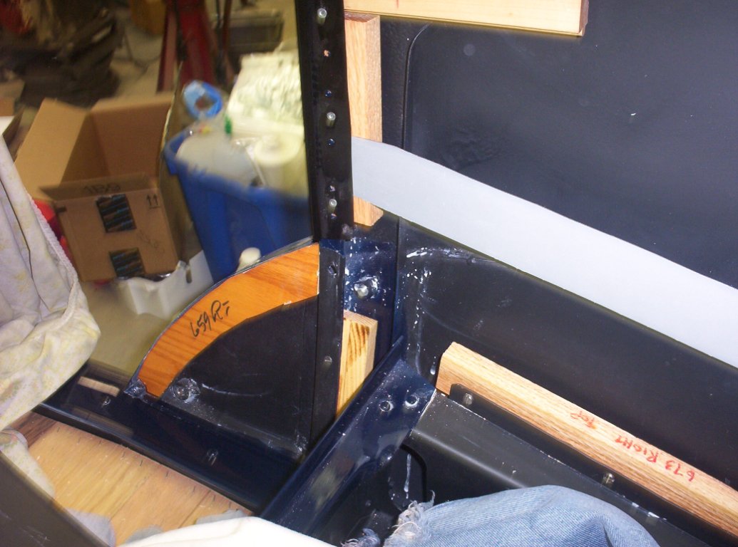

and this

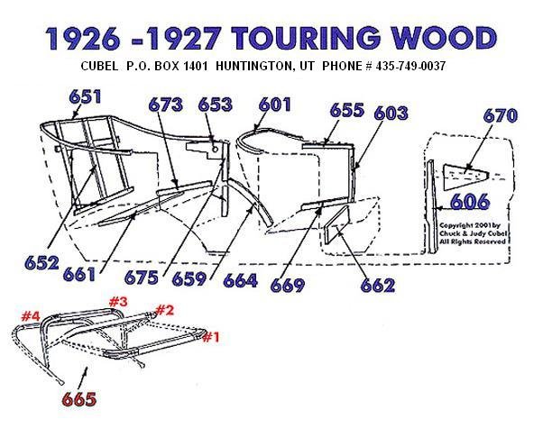

Here's the diagram from the Fordwood website:

Ronald!!! Where have you been! That's the best picture of the where the wood goes that I've seen so far! Thank You for posting!!

Sorry, I misunderstood. Thought you wanted the floorboards.

Thanks Mark!
That is perfect!
The floor boards were going to be my next question!
So, I got two birds with one stone! Thanks again!!!
