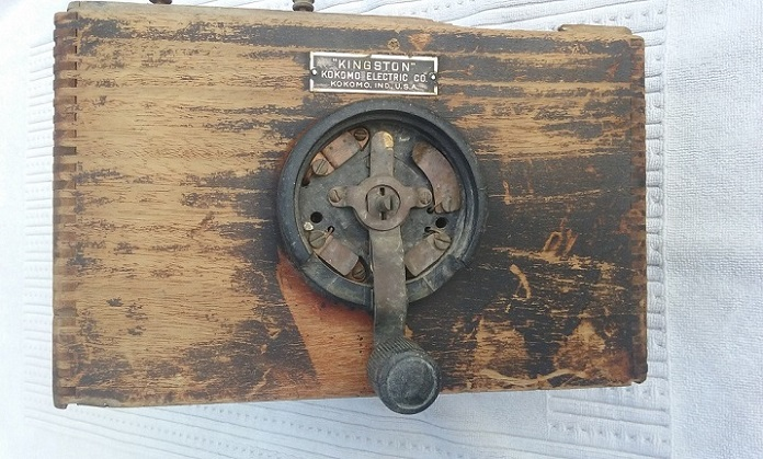

If I understand you correctly, you get a spark plug like shock when inserting the key in the box and turning it to mag. To get that shock the voltage from a coil would pass to the switch to the key to you . What coil box do you have - a picture of the switch would help. Is there an insulated knob on a handle as well

Not sure what coil box or switch but lots could happen in one like this - a broken contact piece
