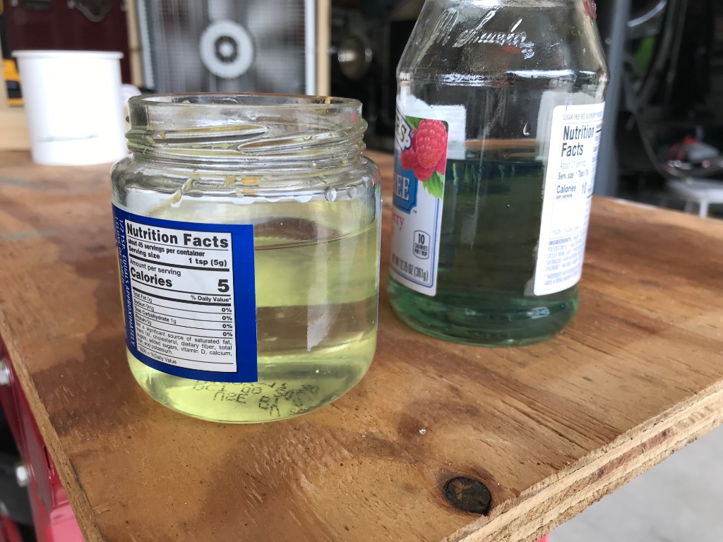

My 27 coupe has run poorly for a number of years. I had the fuel tank cleaned and sealed by a shop in Omaha, before running it for the first time. ( shop is no longer in business).
It ran great for about two years but started to lose power.
I replaced the pistons, put in new valves, with no or little difference.
At the moment, it will not start.

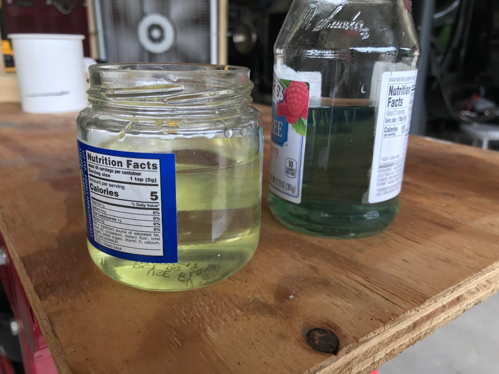

After draining the fuel, which wasn’t over 60 days old, I found a blue tint in the gas.
( see photos attached.) fresh gas on the left and gas from the coups gas tank, on the right.
It appears the liner put in the tank has started to bleed into the gas.
Would this cause the engine issues I have?

I know the old gas tank sealers were affected by ethanol when it came out. Would the sealer be that old? I haven't seen blue sealer before.

Some fuel from some brands is just blue...
losing power, changing pistons (based on what, exactly?), changing valves (based on what, exactly?), and now it doesn't start...
Losing power...on battery? on MAG? going up hills? after it warms up?
Won't start...spark? Fuel? Compression? Need info! Make all 3 happen and it will run...then you can diagnose power issues.
You're going to have to do some diagnostics and provide more information to get any sort of constructive advice. Guesses don't count as advice in my book, but you'll no doubt receive lots of them. The more info you can provide, the closer the guesses will be to the actual solution.

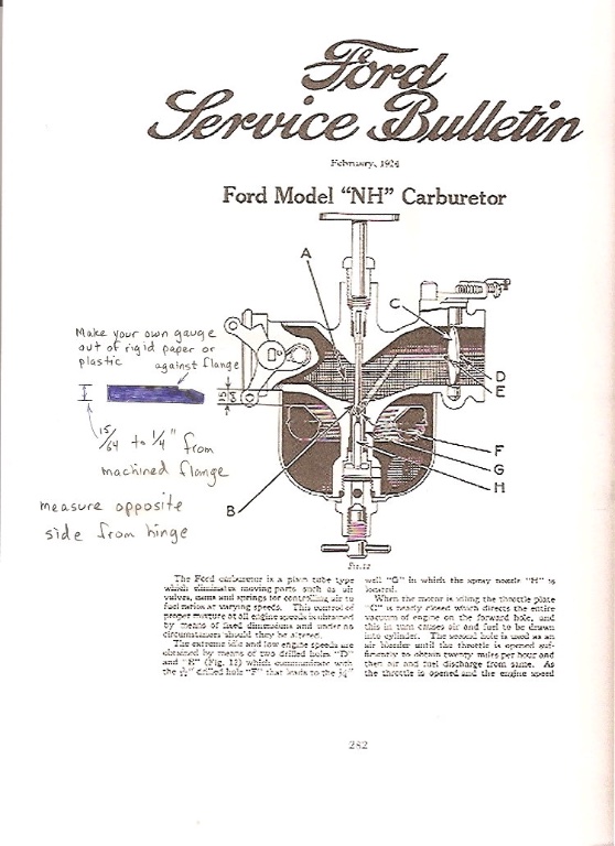

Have you cleaned the screen in the sediment bulb. Have you adjusted the float in the carburetor lately? It should measure 15/64” from the machined flange to the flat surface of the float on the side opposite the hinge. You’ll need to make a measuring gauge for taking this measurement. Change out the gas and exchange for non-ethanol type gas. Locate a source near you. www.pure-gas.org. Jim Patrick

I doubt if the blue tint in the gas is a problem. If the gas smells fresh and is not cloudy, it's probably OK. Some companies dye their fuel green or blue. Some is clear, and a lot of it has a yellowish tint. You've changed so many things since the original issue cropped up it's impossible to tell from out here what the problem(s) may be. If you have doubts about the fuel, it's not hard to safely drain and dispose of it. At this point, a book could be written on what to check and what to do to get the car back in operation. Some basic checks: Is the igniton sysatem working? Is fuel reaching the carburetor? Are the various linkages, such as throttle and spark, hooked up and working correctly? Does the engine have reasonable compression when cranked by hand? Is the compression about the same on all cylinders? Is the valve adjustment correct?

If the gas tank was lined several years ago, any bleeding at this point is very unlikely. Gas tank lining typically fails by peeling or flaking. This can cause clogged fuel lines and screens. it isn't likley to damage the engine. Lining that is installed in a properly prepared tank usally does a good job.
