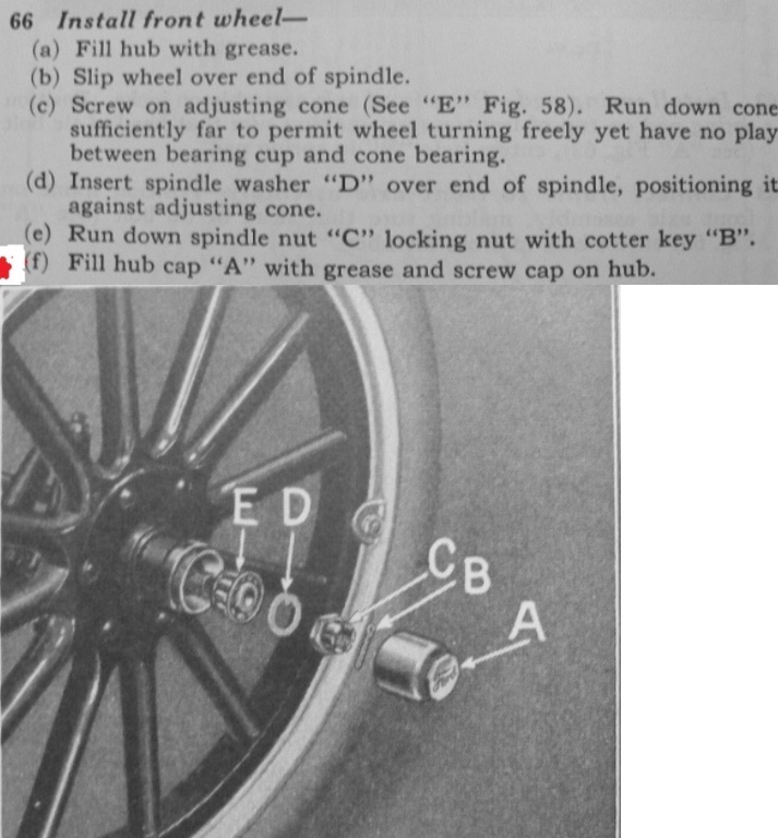

AS i stated on an earlier post if you feel better filling the cap cool but I'm pretty sure the grease out side of the bearing is not going to do anything to lubricate the bearings. But according to # 66 page 22 of the ford service Manual you do fill the cap with grease, you run down the cone sufficiently far to permit wheel turning freely yet have no play between bearing cup and cone. insert spindle washer over end of spindle positioning it against the cone, run the spindle nut locking it with a cotter key. then fill the cap with grease and screw it on hub. This is much easier then the spin , torque, back off retorque & back off 1/8 of a turn and torque locking nut to 150 lb. ft. as I'm used to on class axles.
So I think I stand corrected.
Craig

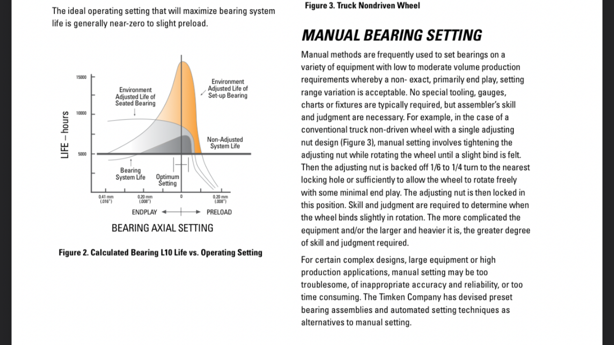

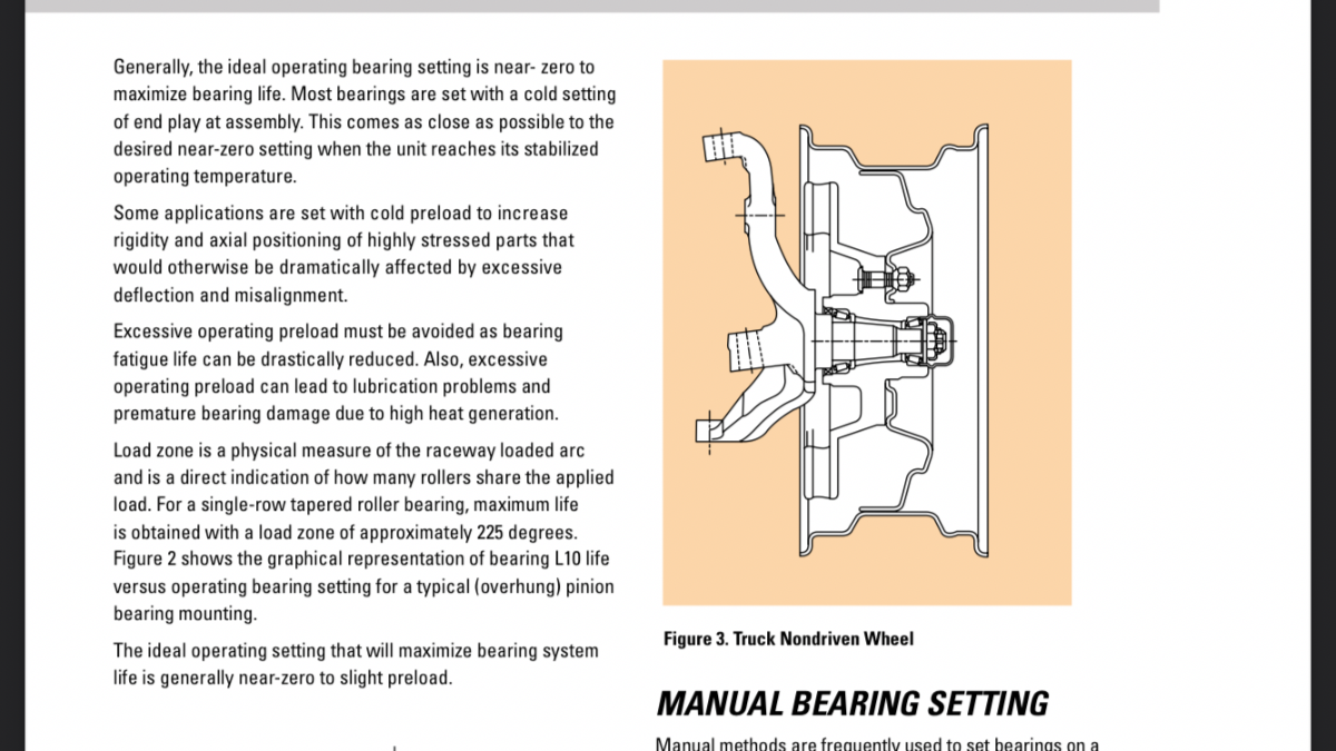

Here is a shot of (and link to) the Manual Setting section of the Timken catalog where clearances are discussed. Not much different than the Ford procedure
https://www.timken.com/wp-content/uploa ... hure-1.pdf

FWIW - the Service Manual does in fact direct the mechanic to both fill the hub cavity with grease as well as fill the hub cap with grease.
I believe that was a direct reflection of the quality of the grease used during that period, and the fact that the car was expected to see much more severe and wet service than we typically do today.
I personally do not follow the manual's advice here...and it is one of the few and perhaps only time I do not follow it.
A modern neoprene inner seal and a schmeer of grease on the hubcap threads tends to be a far better dust/moisture excluder than the old felt seal ever provided.
