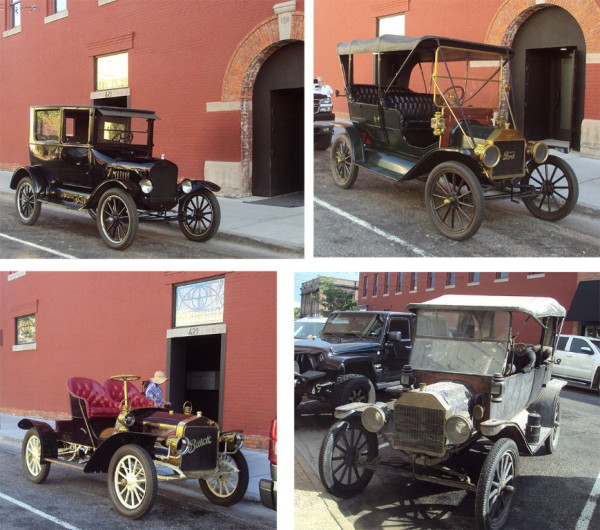

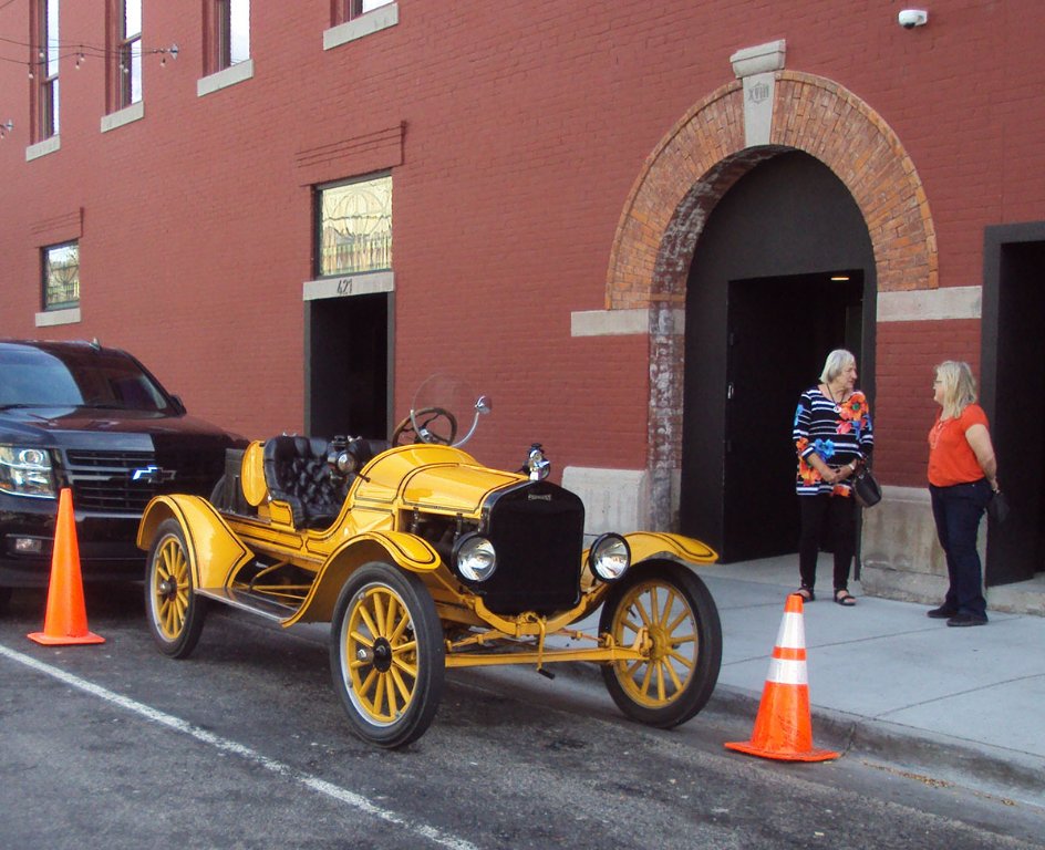

Mia was a darling little girl who used to tag along with her Grandmother and the Tea Ladies when we chauffeured them around in the Bus and other vehicles a dozen years ago. Fast forward to this week, she has grown up and is working for an Entertainment Center. She asked if we could put a different car on display each night outside a new Club for their opening. It sounded like fun so we drove down there and spent a couple hours checking out restaurants and enjoying the everchanging old buildings and businesses.
Many of the old buildings still retain some of their charm. These places seem to have a mood and we even heard some stories of hauntings reported in some of them. It was fun to be there each night. This club is downstairs with brick and stone walls and much like a speakeasy.
