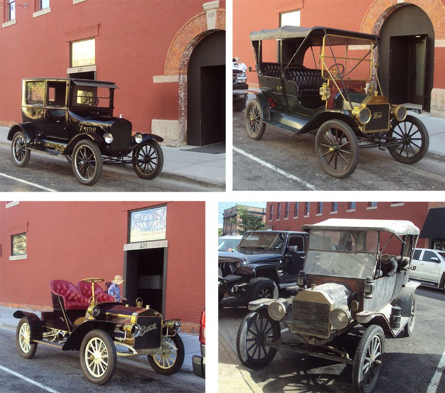

Mia was a darling little girl who used to tag along with her Grandmother and the Tea Ladies when we chauffeured them around in the Bus and other vehicles a dozen years ago. Fast forward to this week, she has grown up and is working for an Entertainment Center. She asked if we could put a different car on display each night outside a new Club for their opening. It sounded like fun so we drove down there and spent a couple hours checking out restaurants and enjoying the everchanging old buildings and businesses.
The walk and lots of chips and salsa improved my disposition. A double diet Pepsi helped too. When we returned the car started on one crank. Now I need a new theory on what the heat is affecting.

Many of the old buildings still retain some of their charm. These places seem to have a mood and we even heard some stories of hauntings reported in some of them. It was fun to be there each night. This club is downstairs with brick and stone walls and much like a speakeasy.
Tonight as we took the '14 it's little black cloud followed us along. There were no traffic cones to mark our spot. We learned that they only needed us for 4 nights and tonight wasn't required. That was fine so we decided to just drive over to another place to eat. As has happened before after a hot drive the '14 would not start on the questionable battery. I am carrying a spare battery along so I wired it up. Still no start. A fellow came out of the adjacent bar and decided to help. Checking the wire connections he shorted out and burned up the light gauge jumpers before I could restrain him. He saw no fault on his part. There was no sense in cranking any more and I kindly explained we would go eat and try again when it cooled off. I needed to cool off. Joy found me grumpy when I asked why she didn't know we didn't need to be there.The walk and lots of chips and salsa improved my disposition. A double diet Pepsi helped too. When we returned the car started on one crank. Now I need a new theory on what the heat is affecting.
