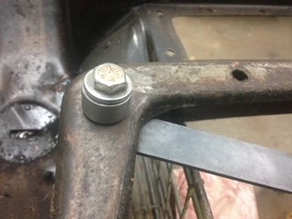

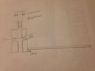

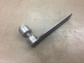

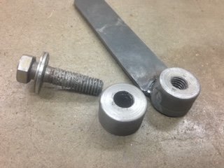

I made this to remove the dimples caused by tightening the bolts.
It will pull the dimples in the pan back flat and can be used in the car with the hogshead off. Less chance of warping the pan & smashing the fingers.
Also works good on the hole pan before putting it on the pan anvil.
Craig.

Nice work Craig! Thanks for sharing!
